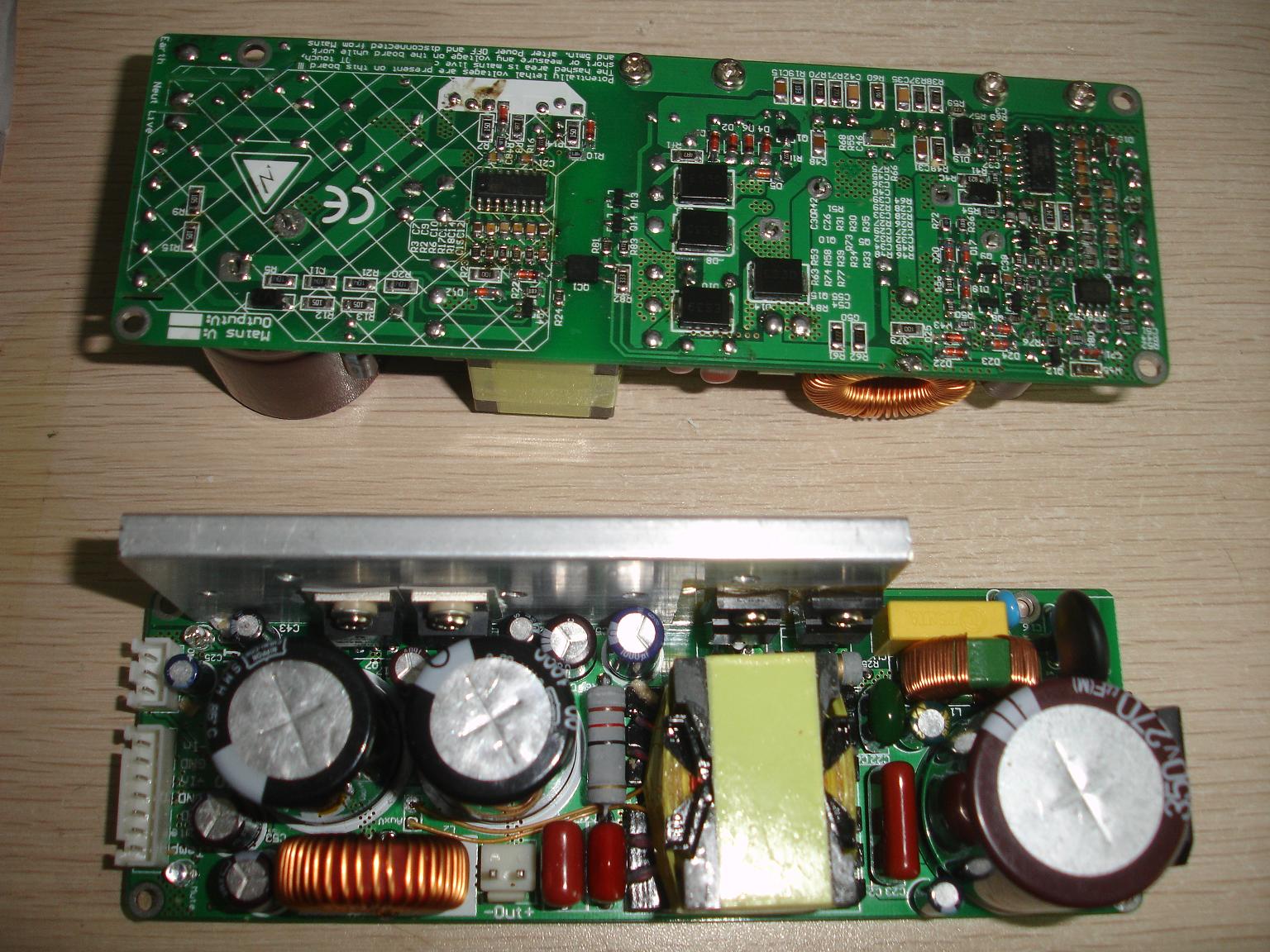

Hey...great news! I guess it will show up on the site when it's available, right?
