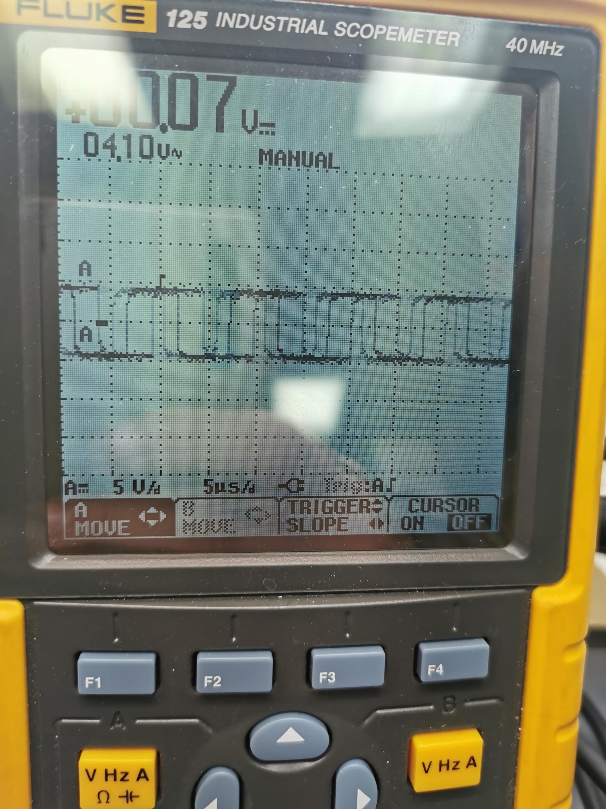

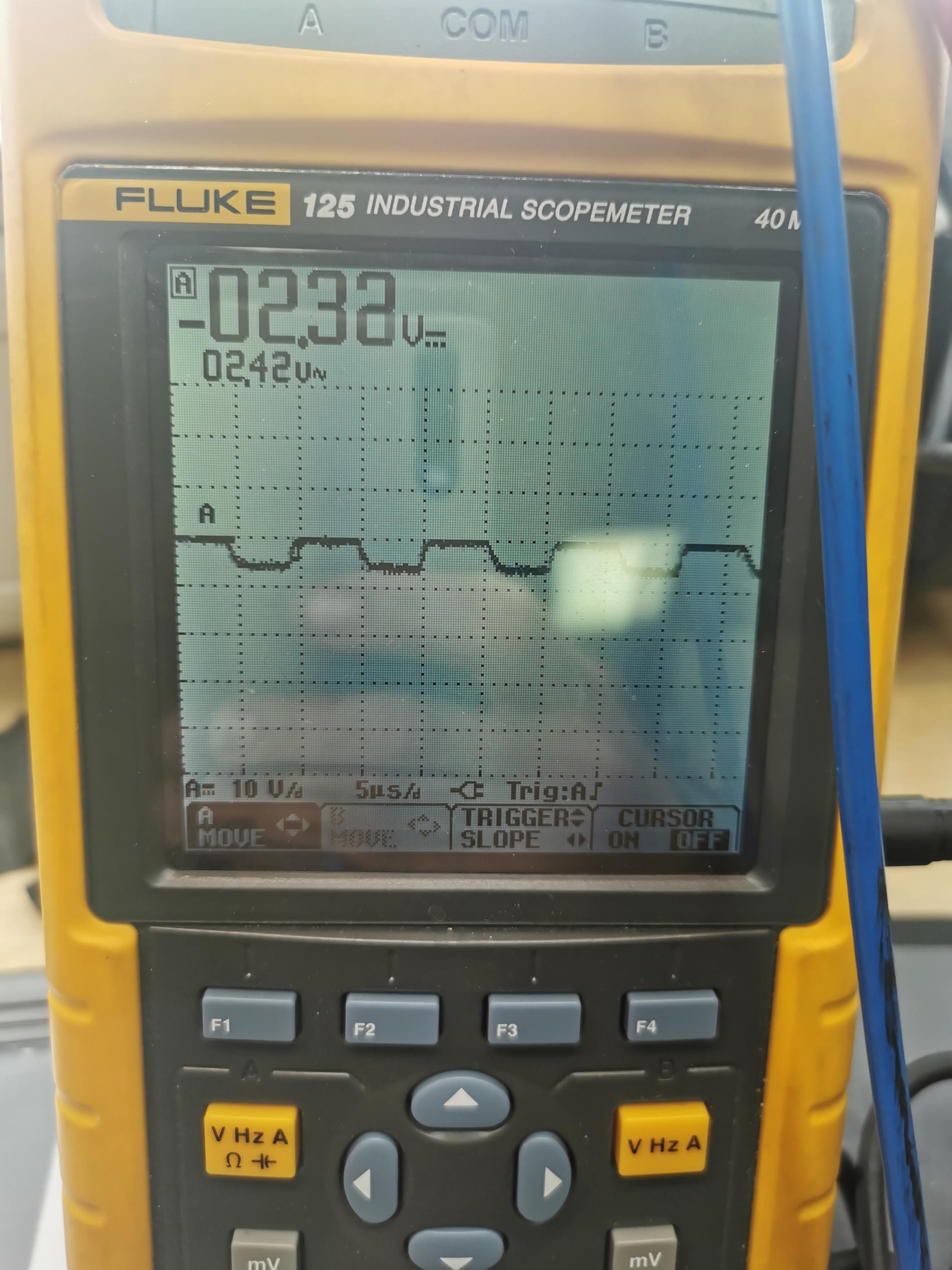

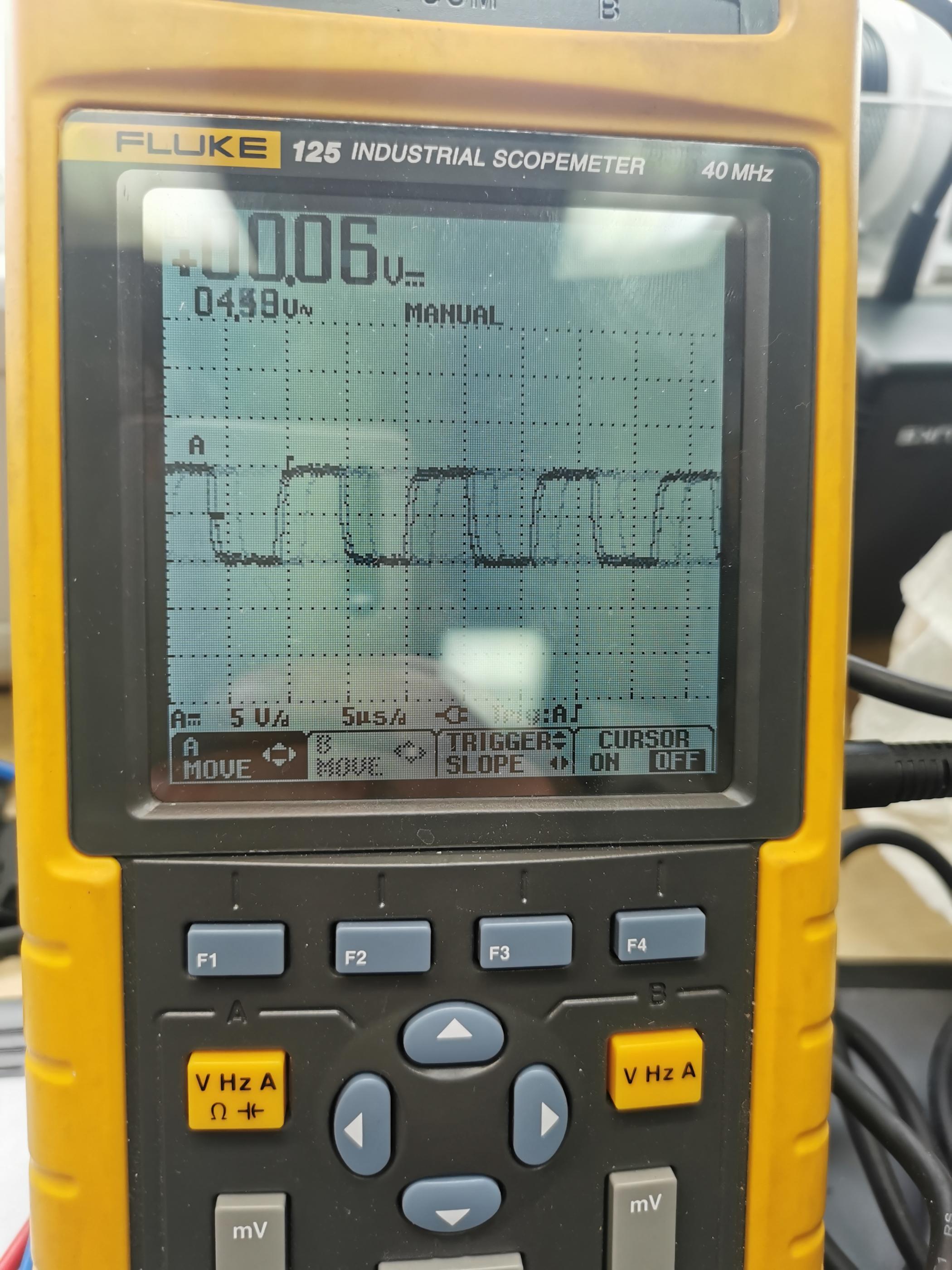

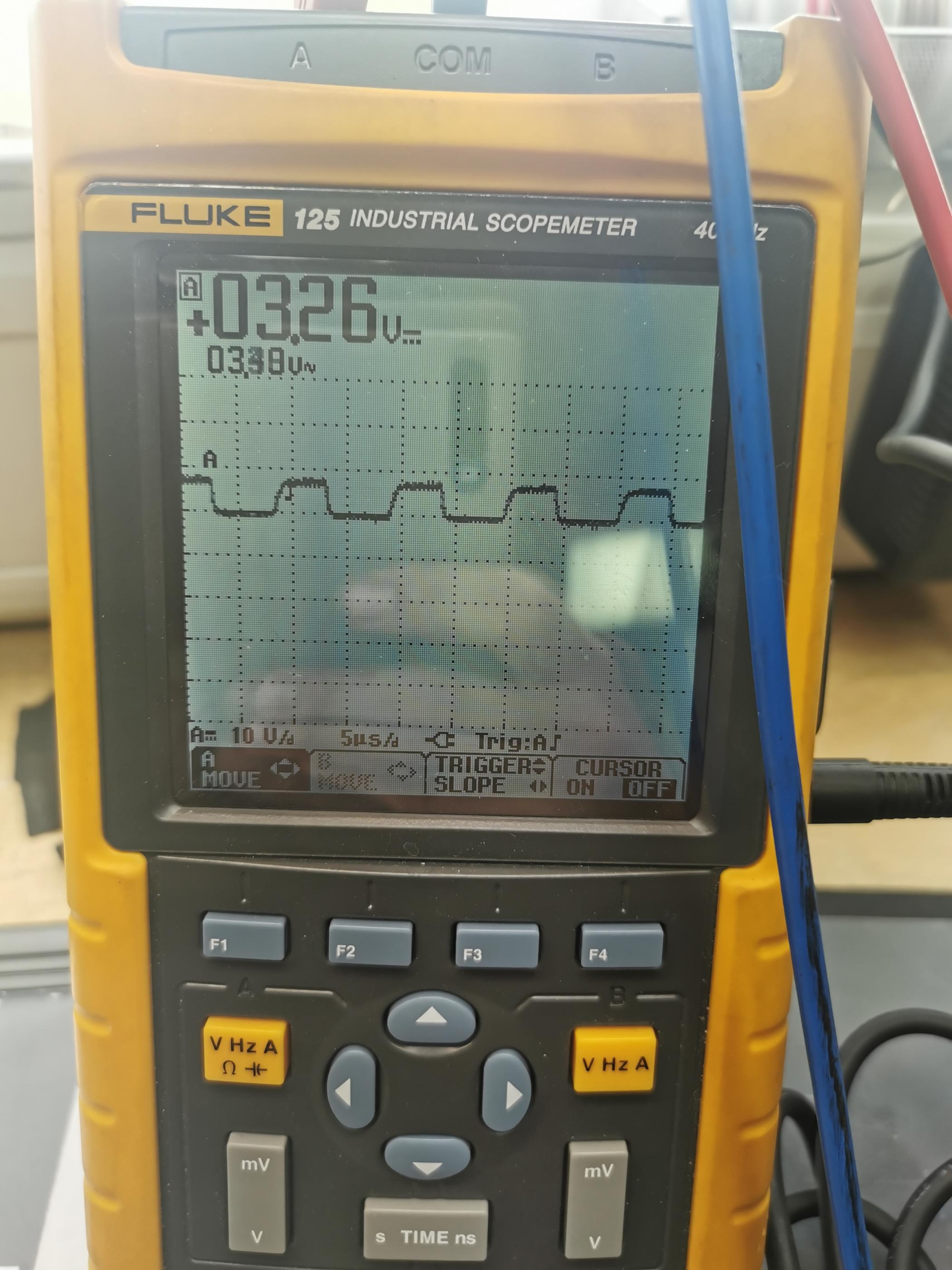

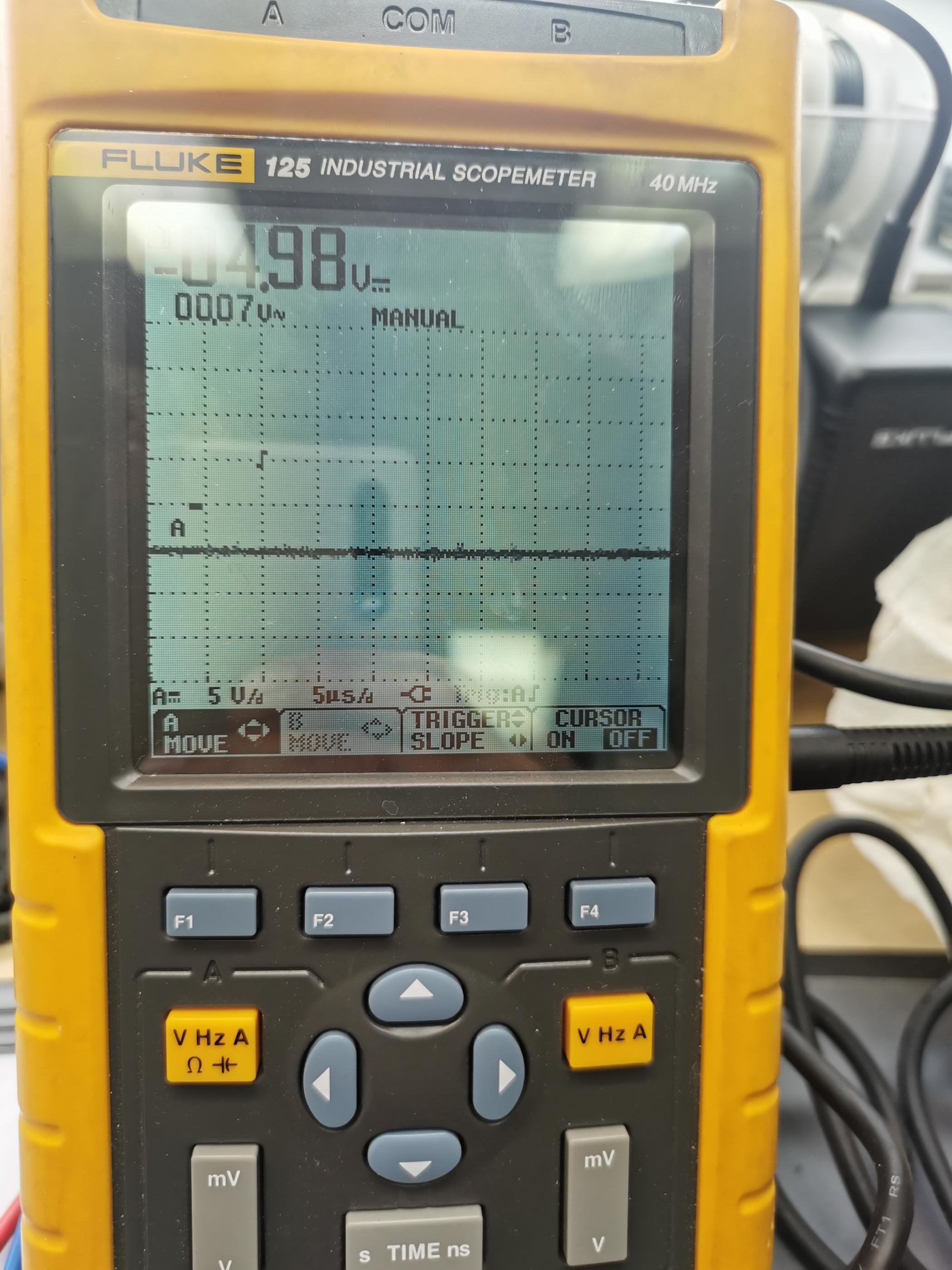

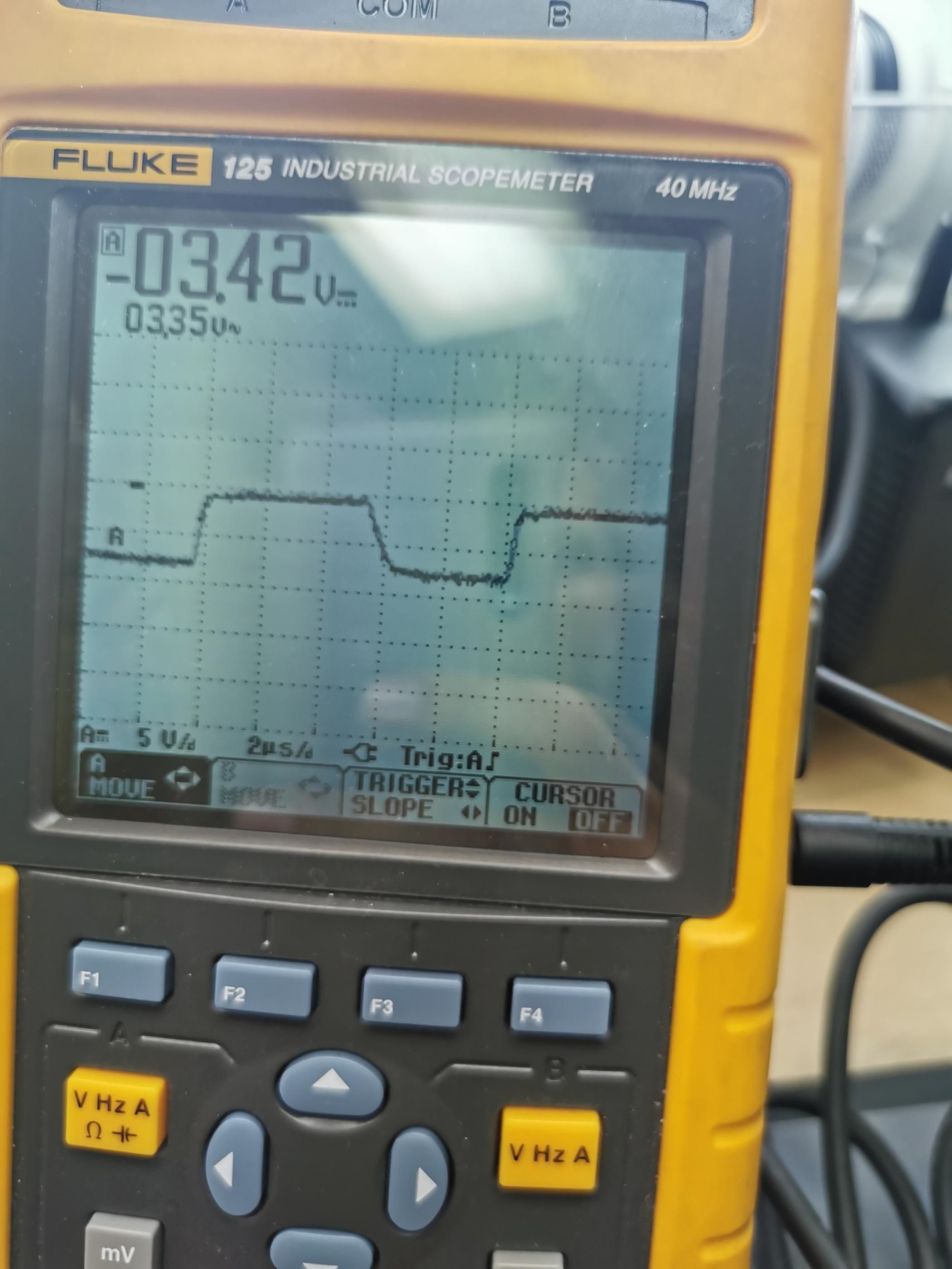

I had only 0.15 on hand. But I think it's not a problem. The waveform looks bad.

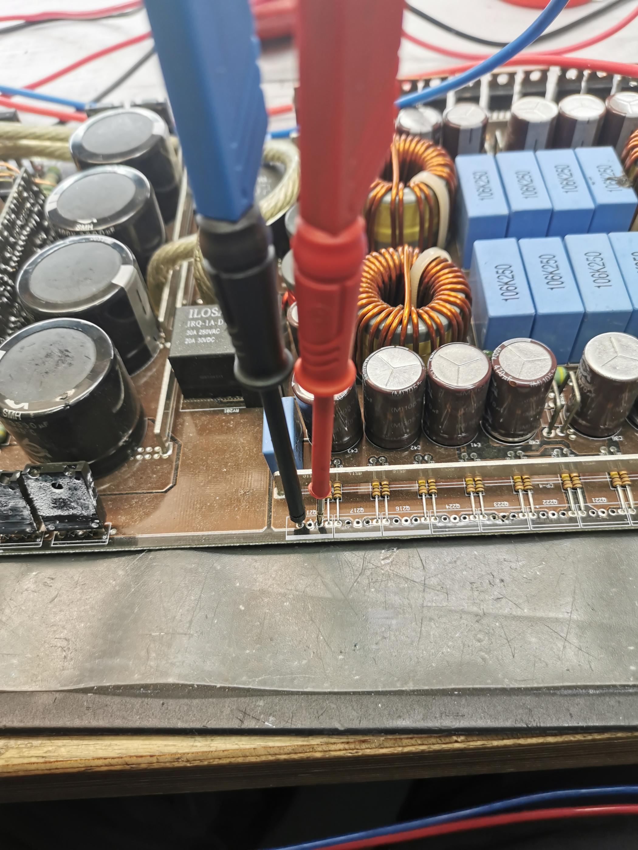

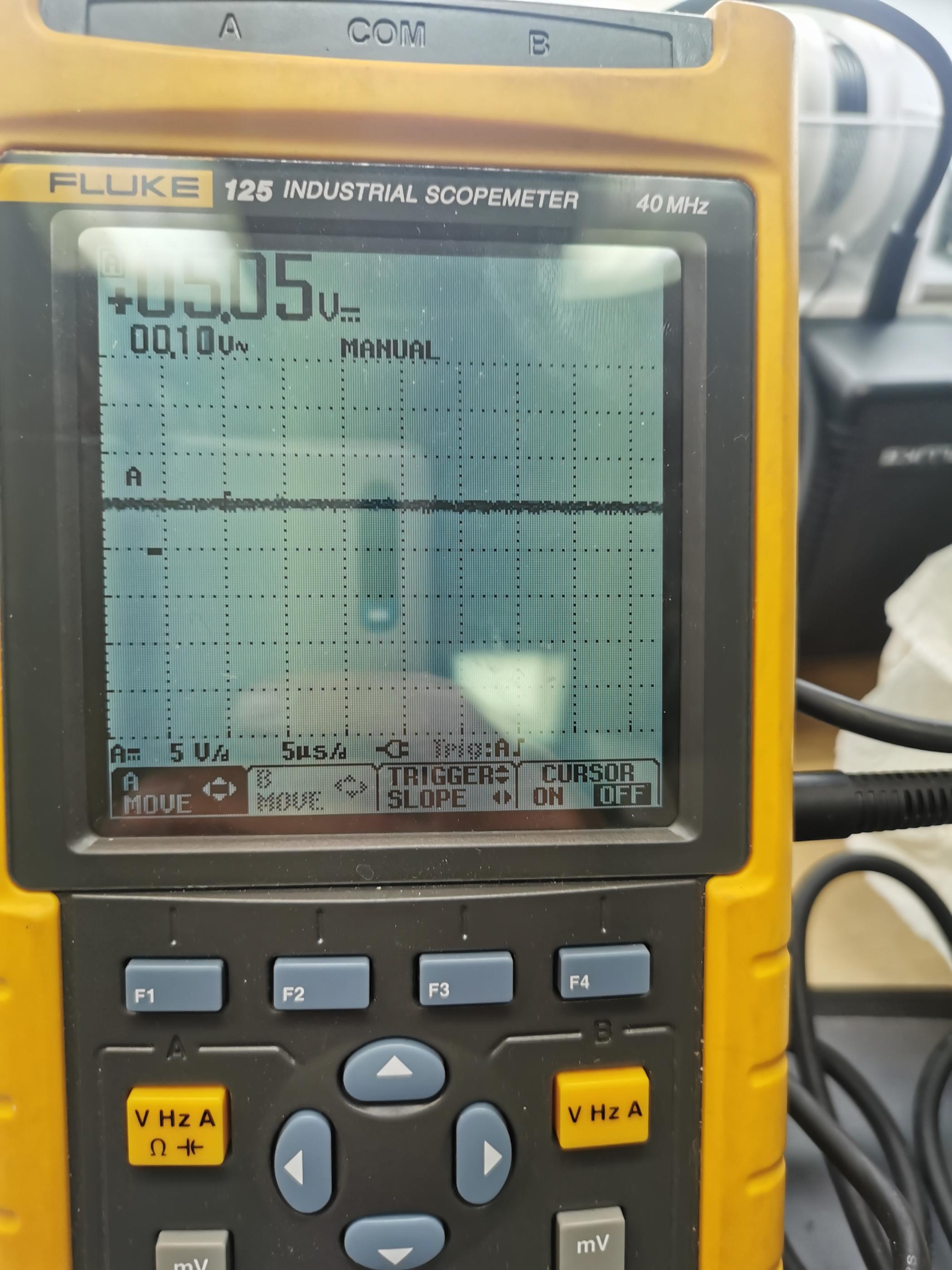

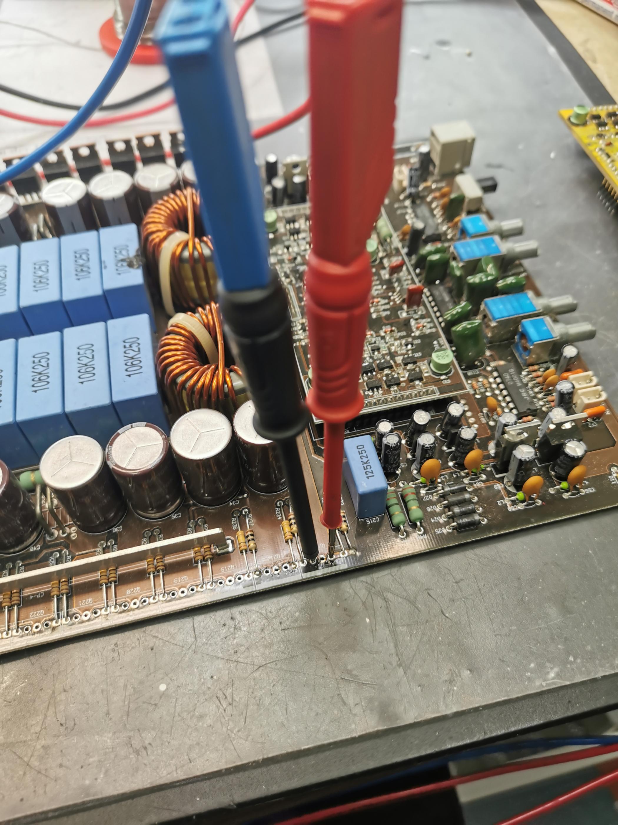

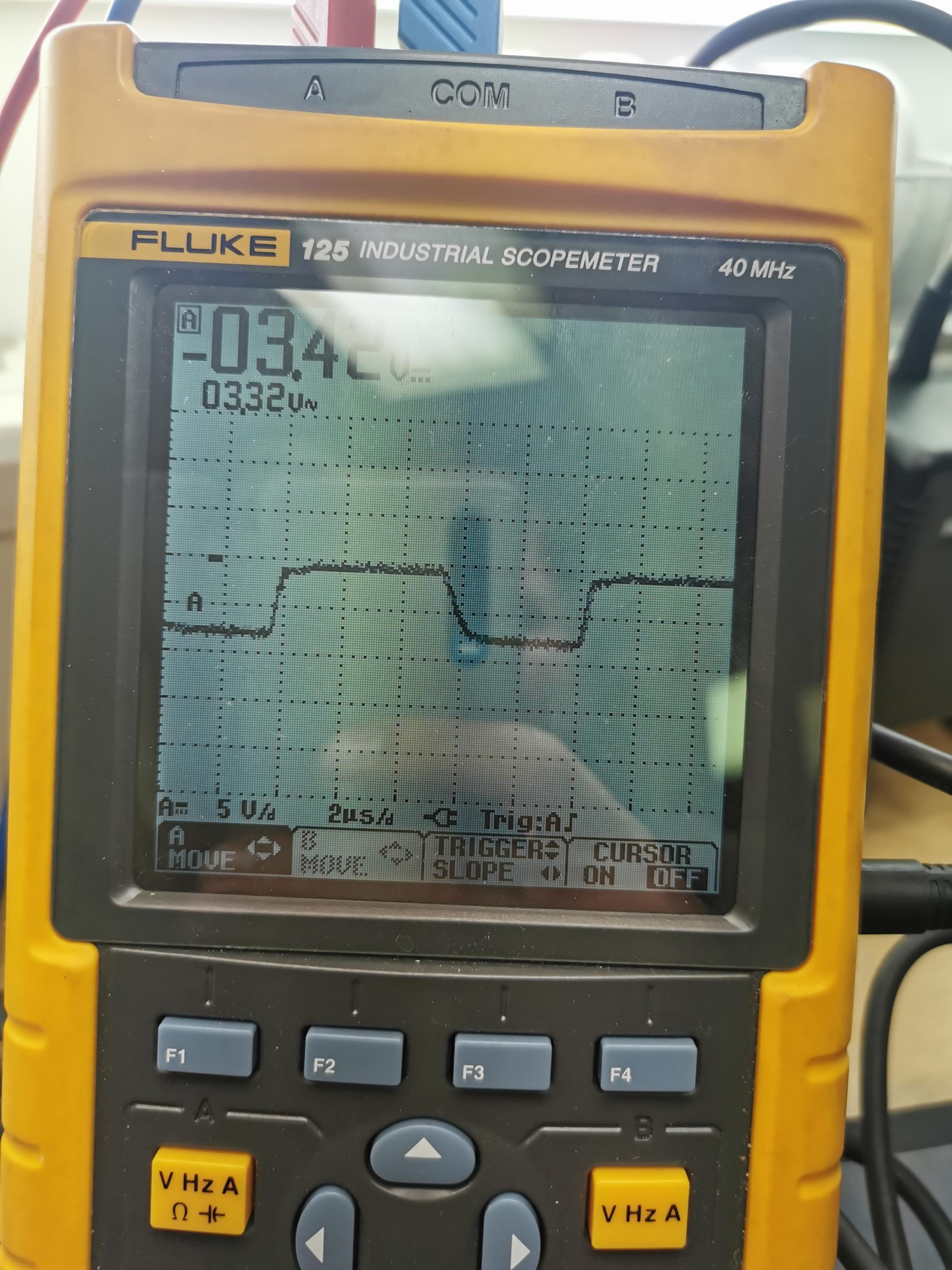

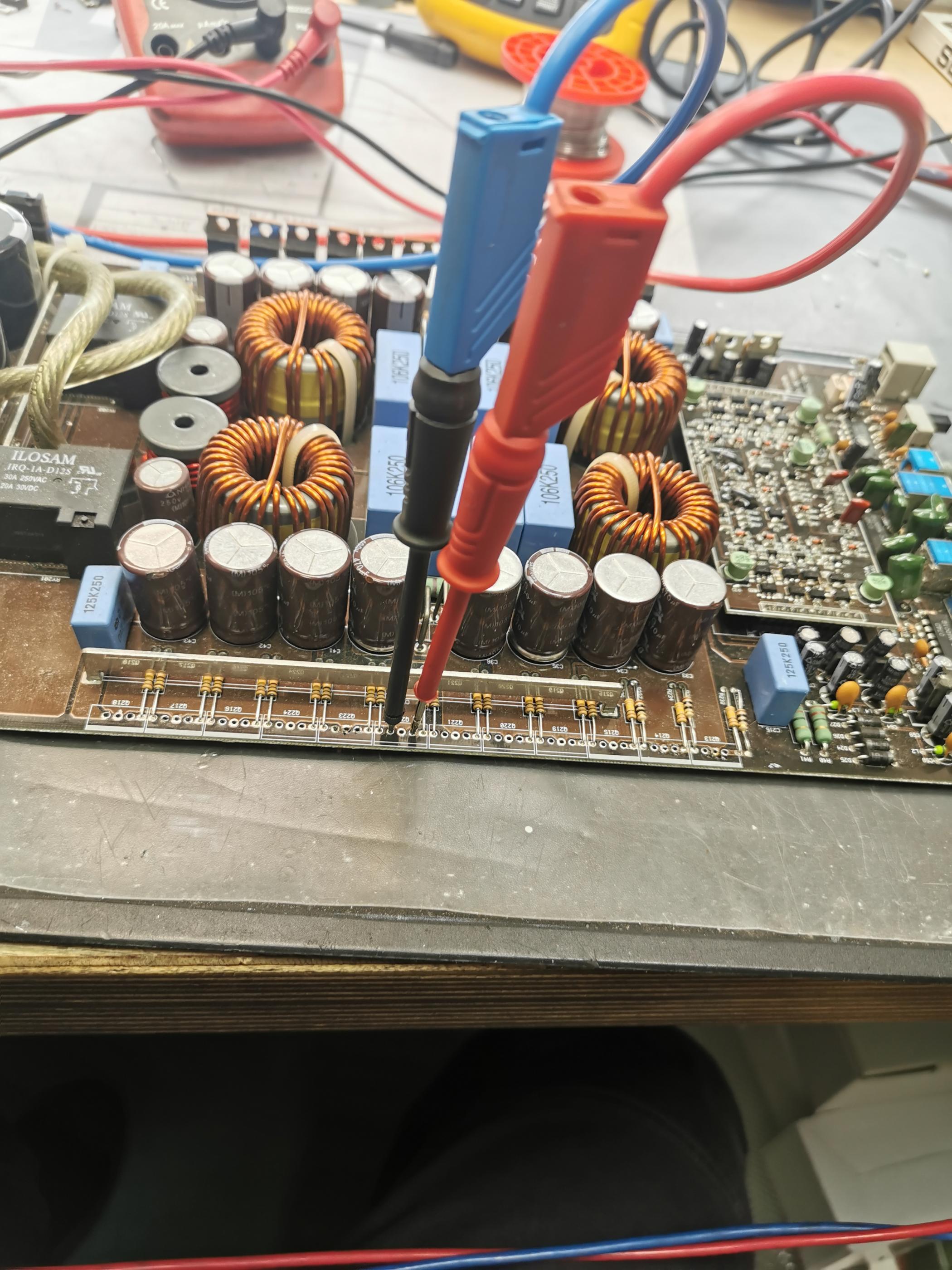

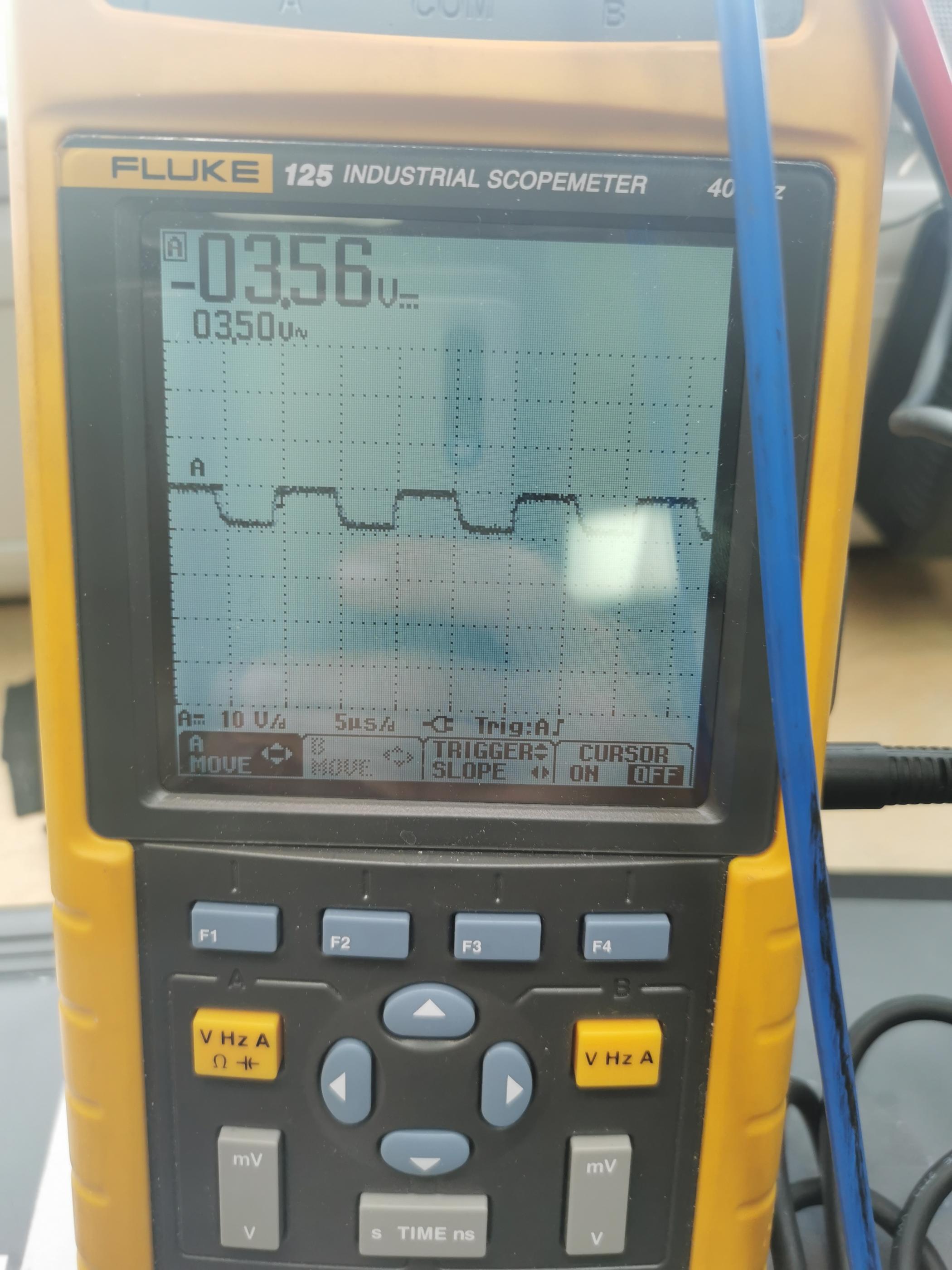

The 10 ohm resistor is still inside. Here is a picture with 5v without the fets on this bank I have a current draw from 2.7 amps. It's directly, no change when the relay engage I can try with fets inside and check, if the ampere goes up.
No. Don't install them. I thought you stated that they were in the circuit, earlier.
The reason that it's drawing current with the 640 is because the FET is conducting and driving DC to the load.
If all of the drive signals look the same with the loading cap, I think I'd try installing both 640s and 9640s.
