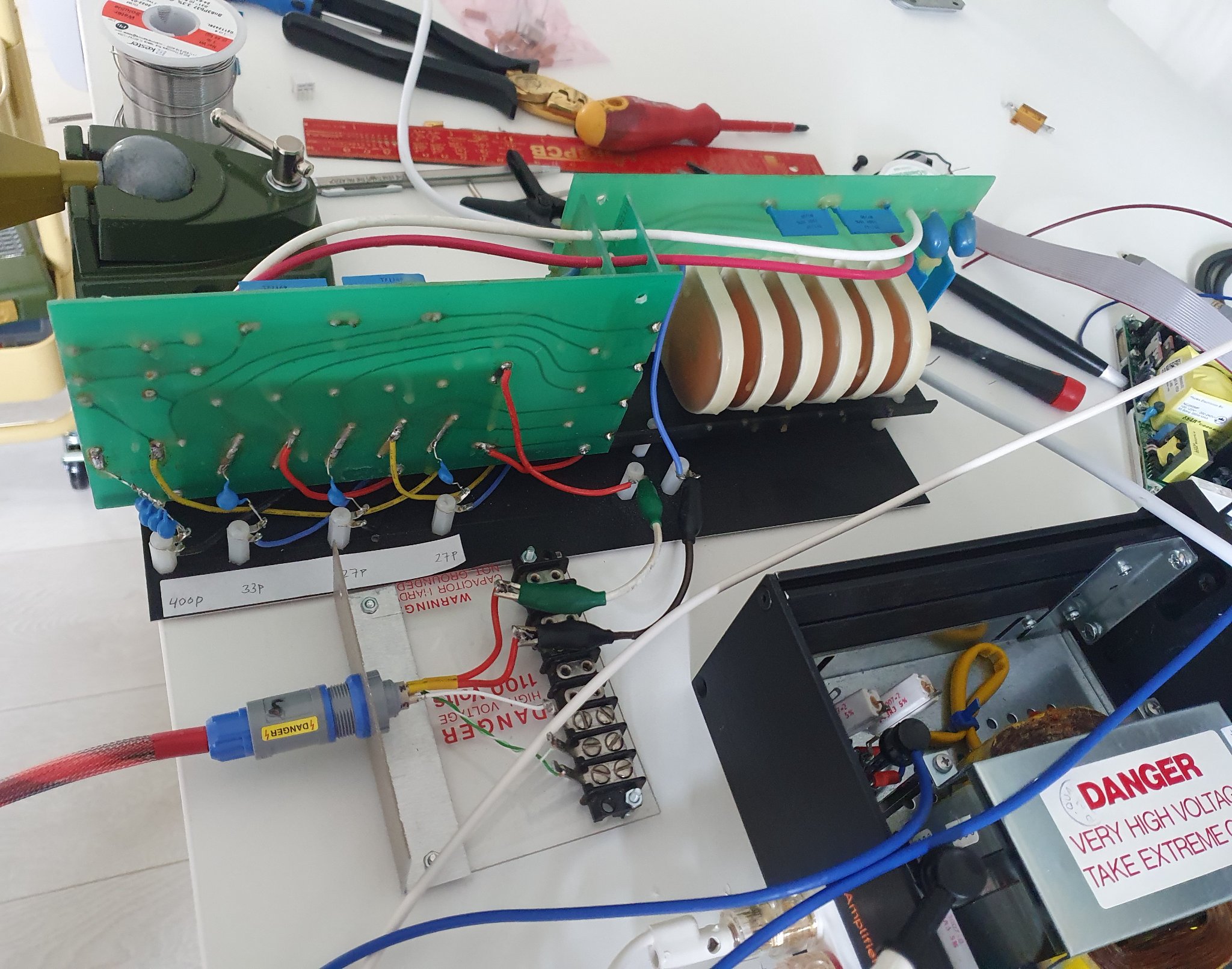

Before I designed the direct drive amp I have driven them with a Purifi class D as well as with my own class AB amp.
The Purifi worked very well; the limiting factor is the ESL step-up transformer as documented in my article.
But it is just as with class A(B) - there are crappy class D amps around that should be avoided.
Quality has its price - but the quality remains after the price is forgotten ;-).
Jan

I migrated from nCore to Purifi some time ago and have the impression that the midrange got a bit smoother and, for lack of a better word, more authorative. But subtle, sometimes I doubted if there was a change. I'm using Acourate for xover, speaker and room correction with the ' 63's and the Gradien subs and have also been swapping multichannel DACs. Topping DM7 (a secret well-kept) worked quite well, but I needed AES inputs (Topping is strictly USB) and am now playing with an Okto Research DAC8 Pro. Better than the Topping, but again, subtle. Baby steps, but class D really has come of age.
Yesterday I was in Germany for a preview of a system that will play at the Munich High-End show in May. 3-way system by Joachim Gerhard, Acourate-corrected. All Purifi, drivers and amps. It didn't really sound much better than my own system but of course with a quartet of large Purifi woofers, more dynamic and powerful than the '63 + Gradient. We live in the best of audio-times!
Jan
