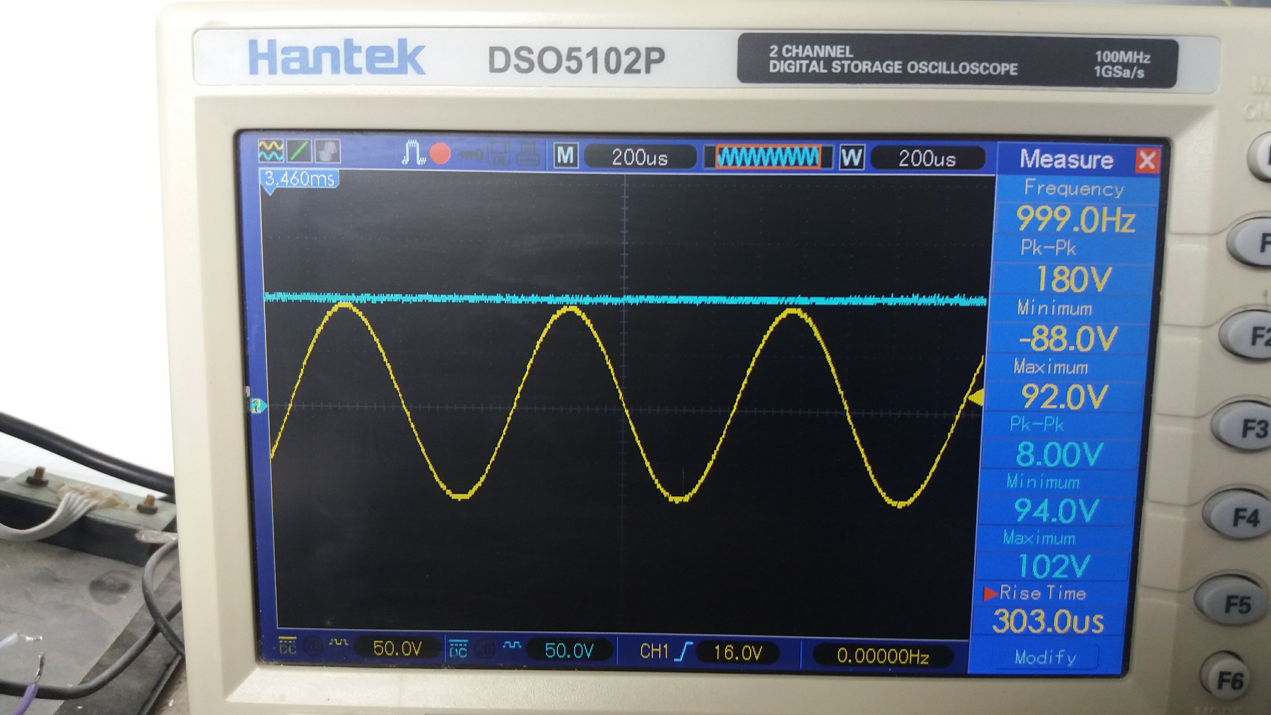

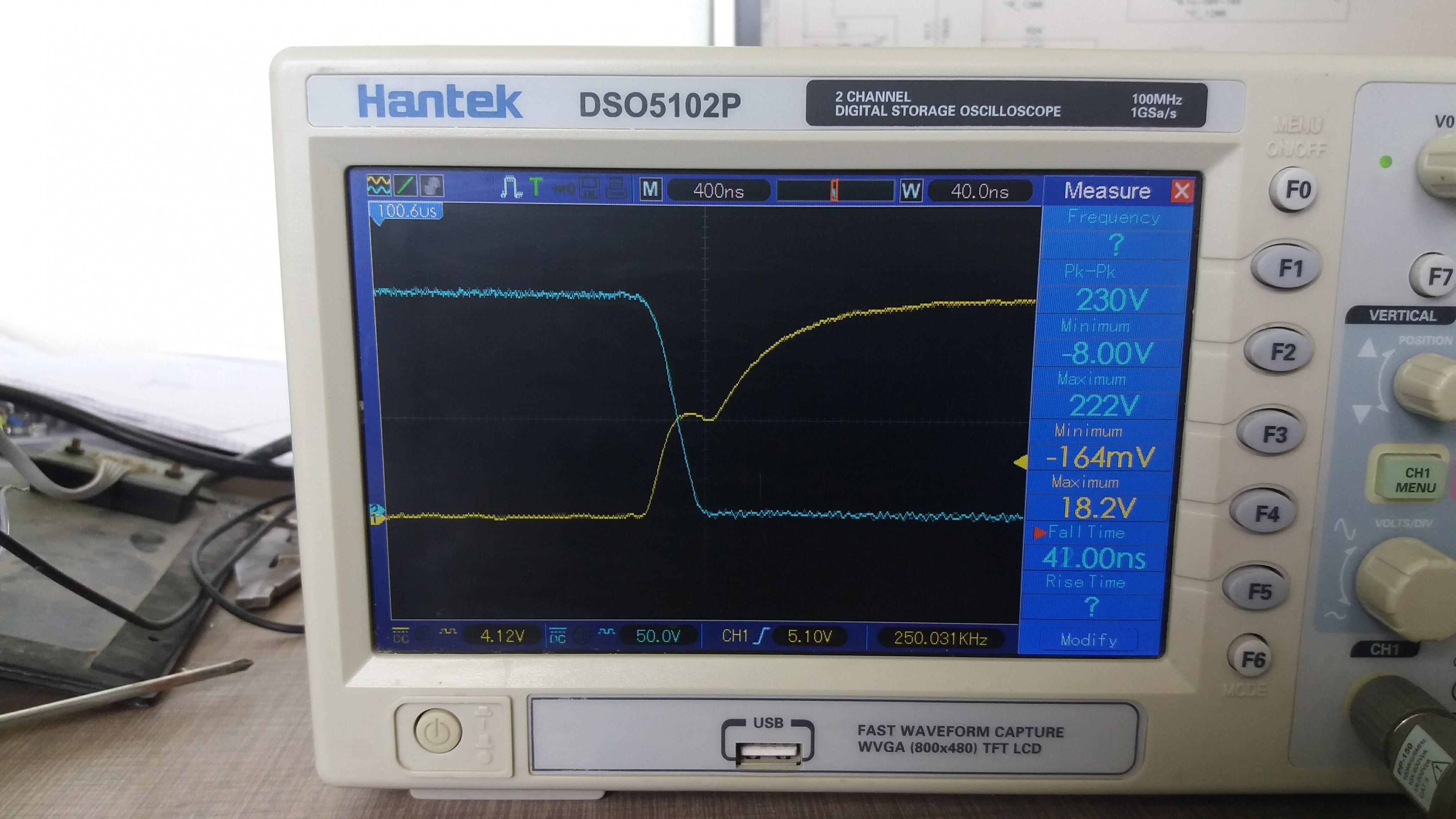

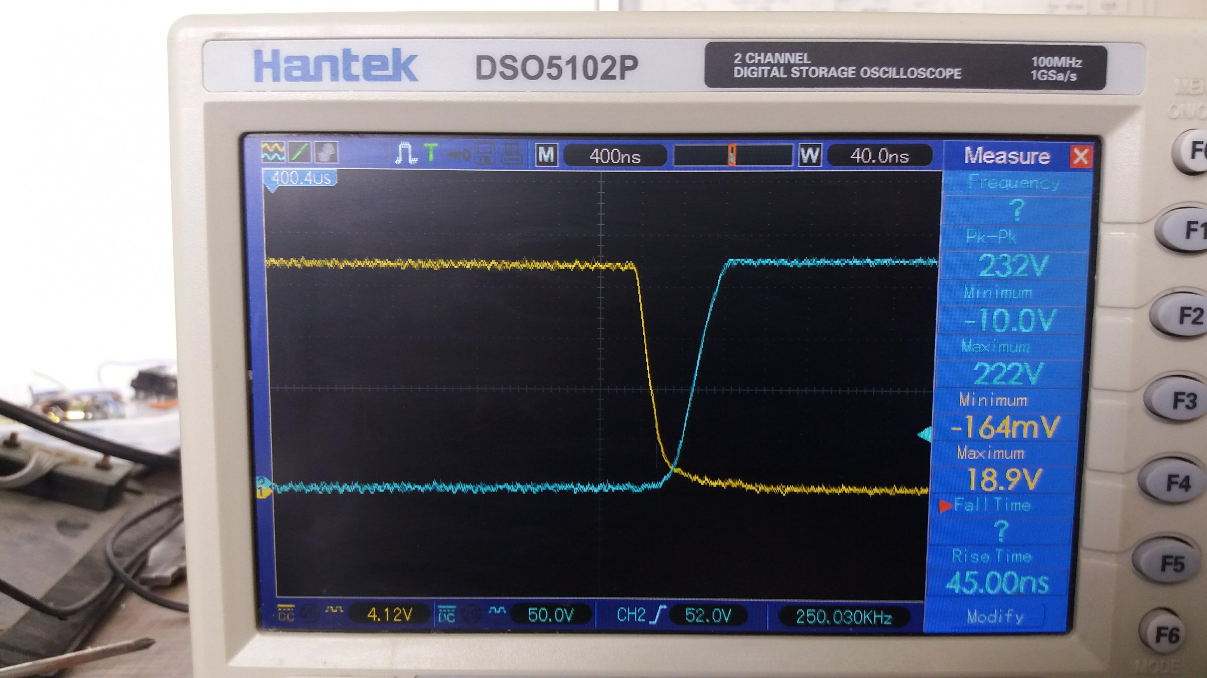

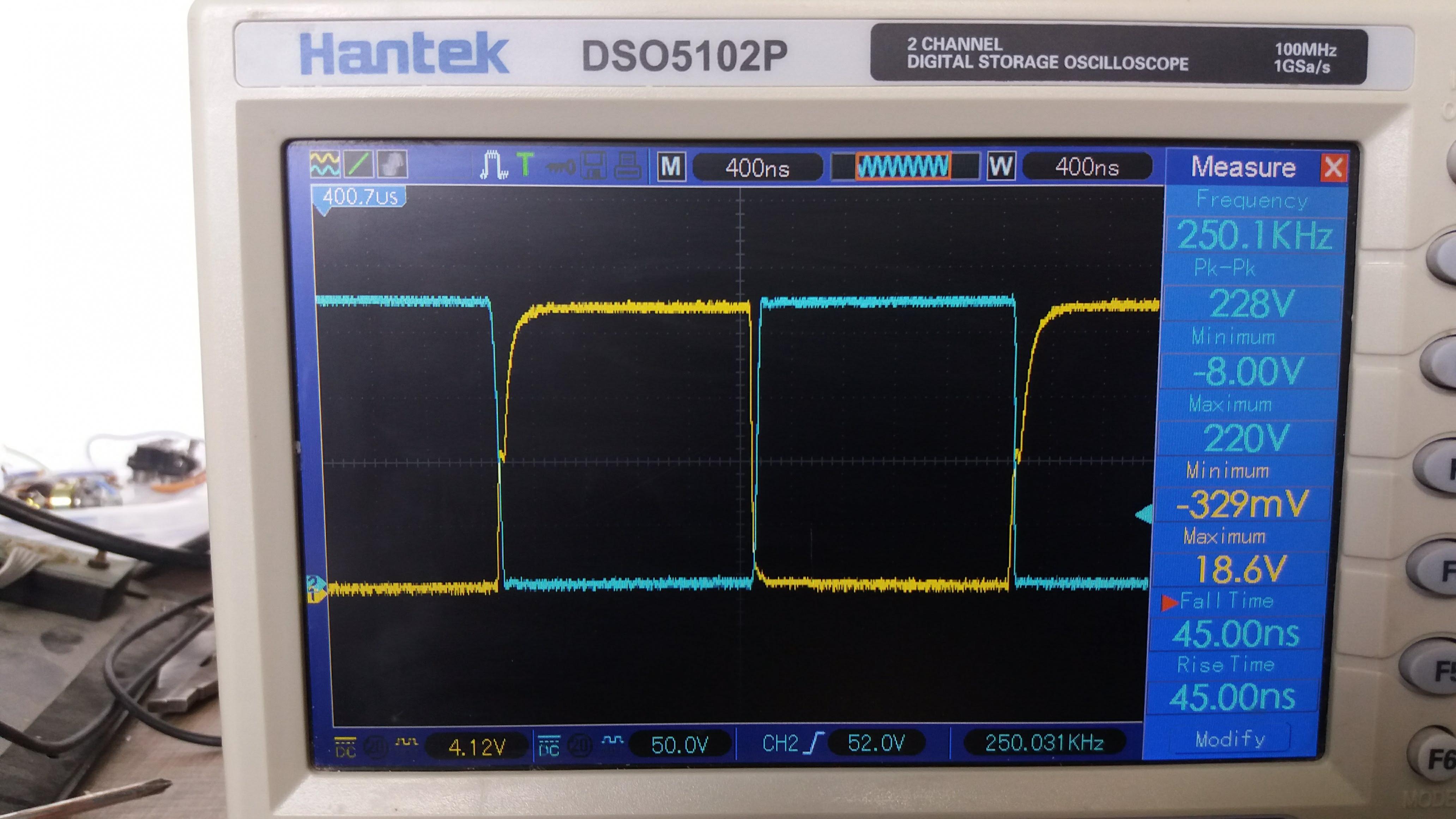

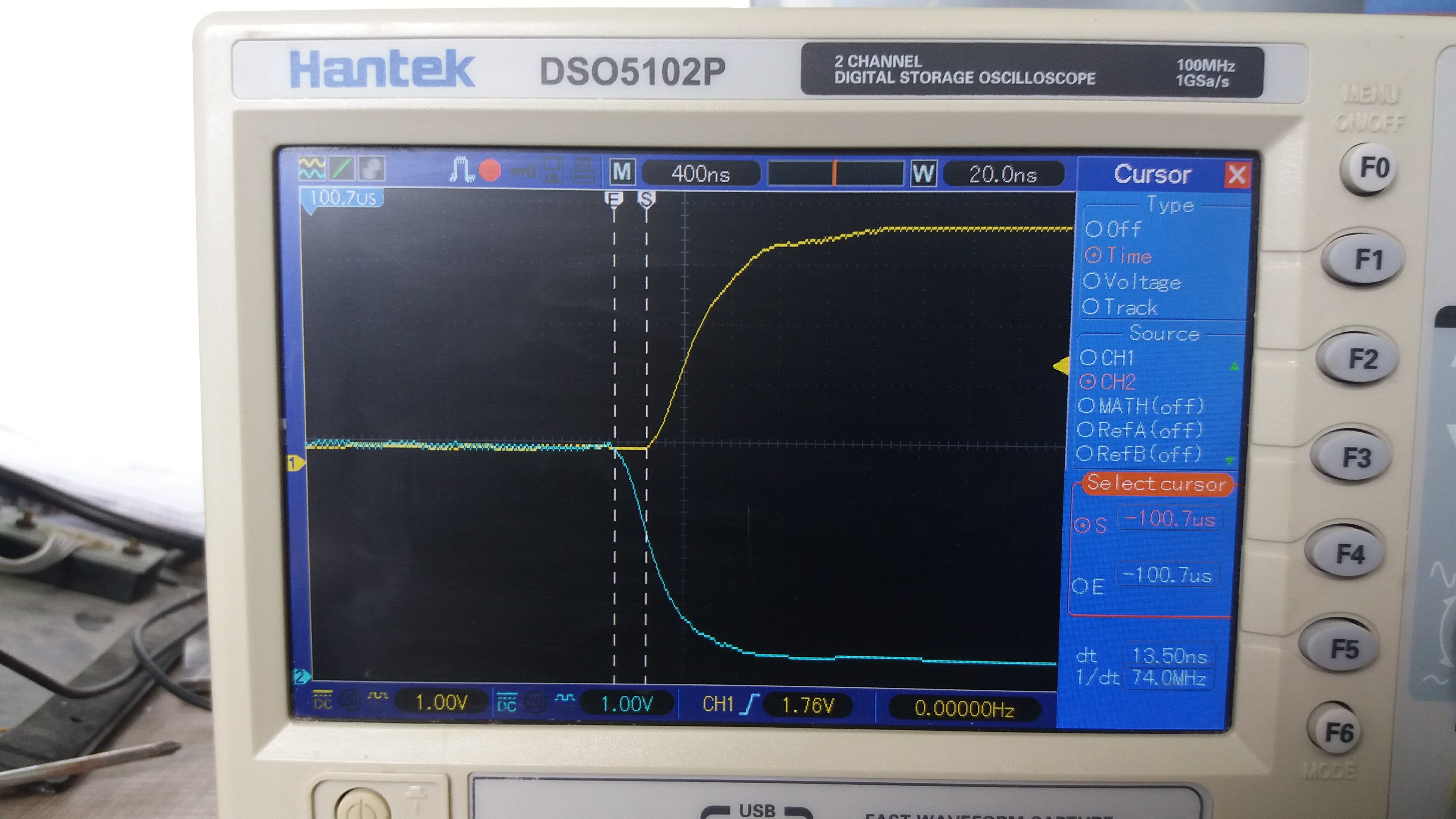

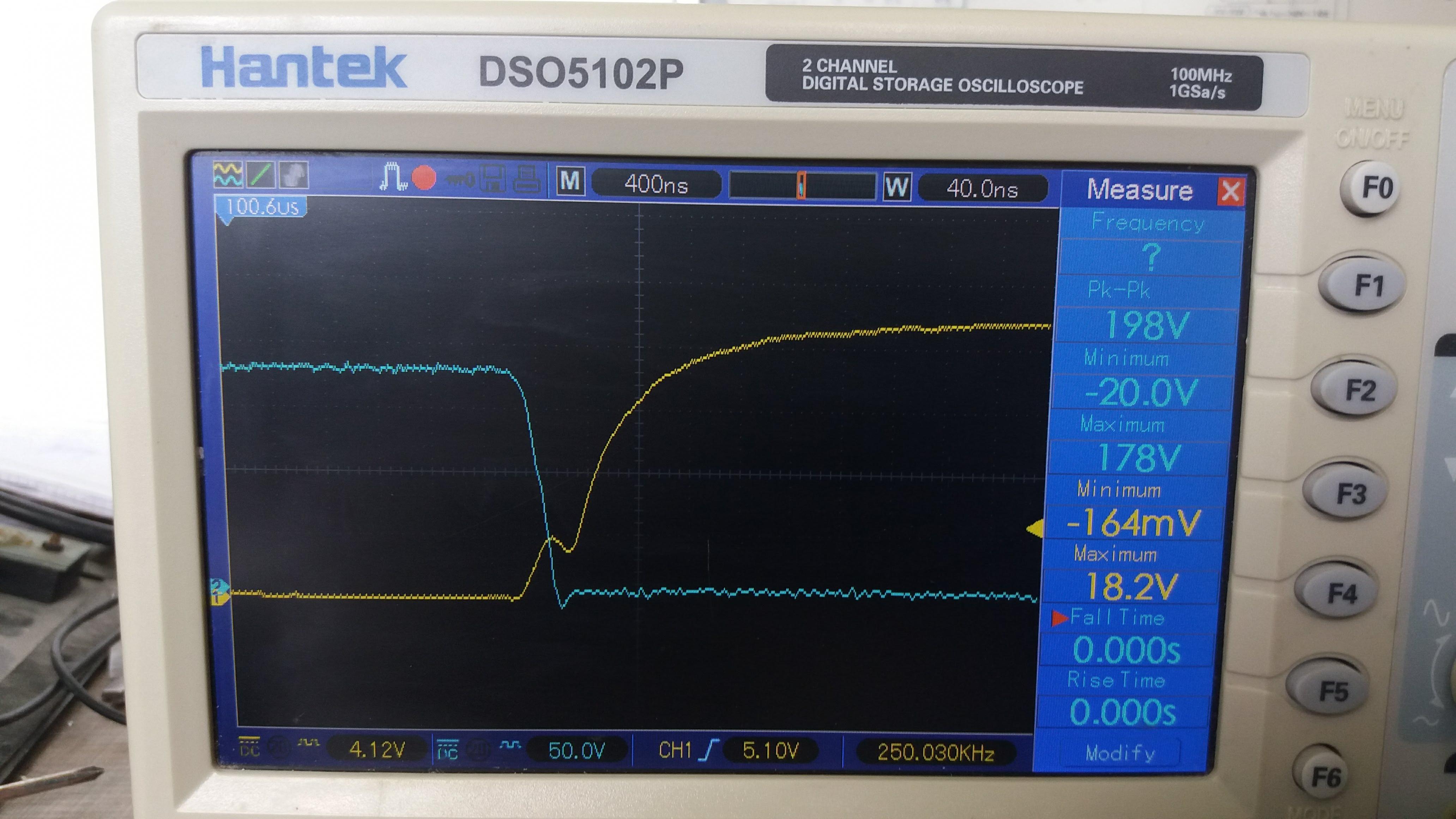

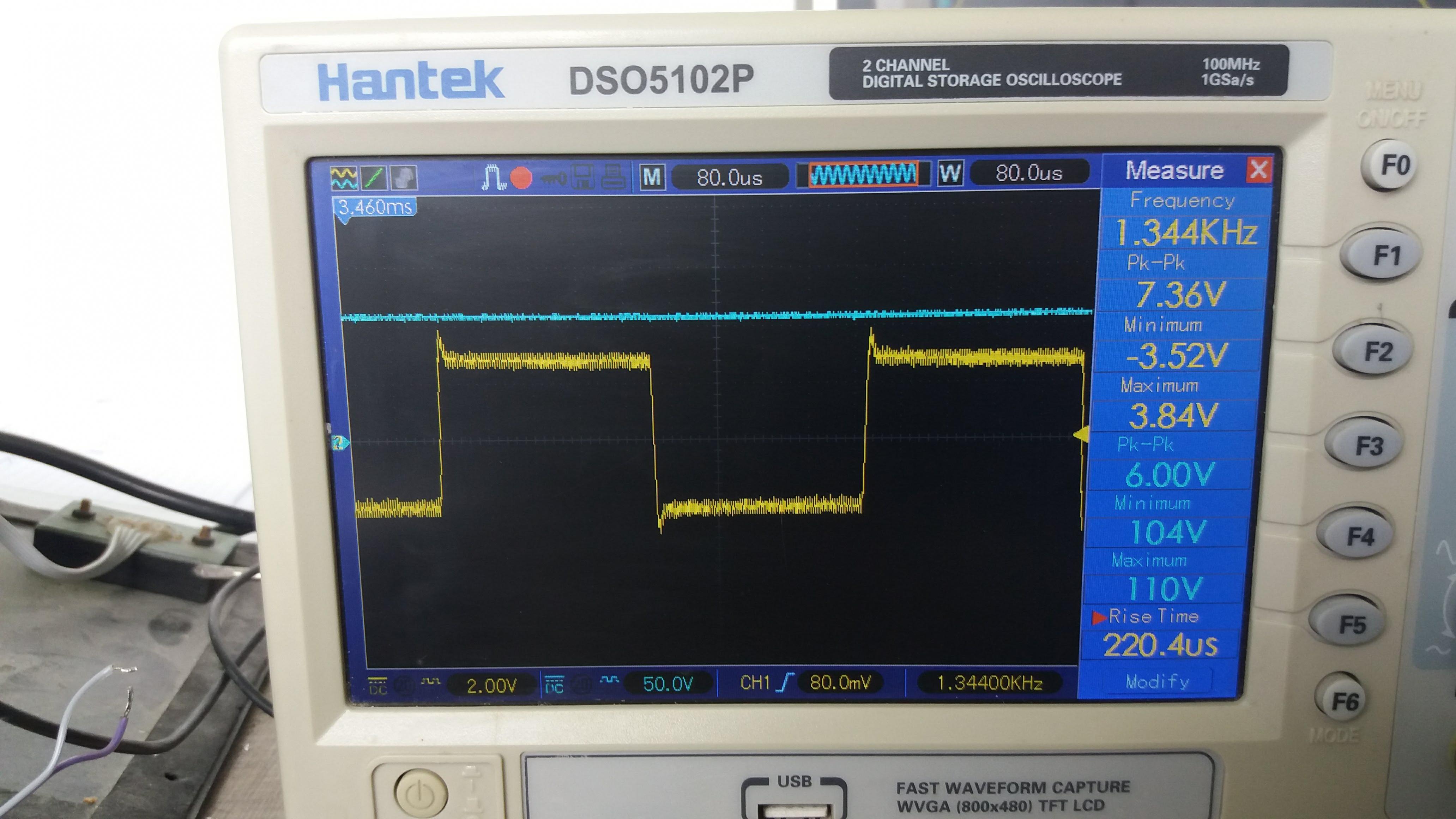

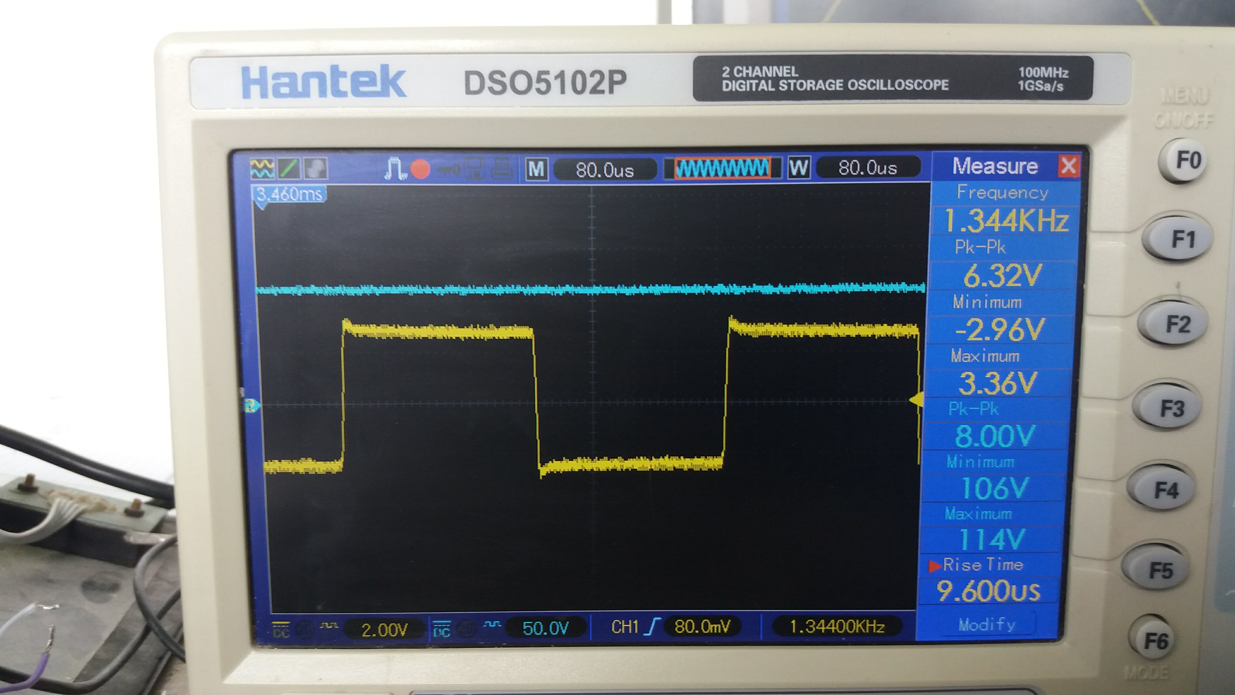

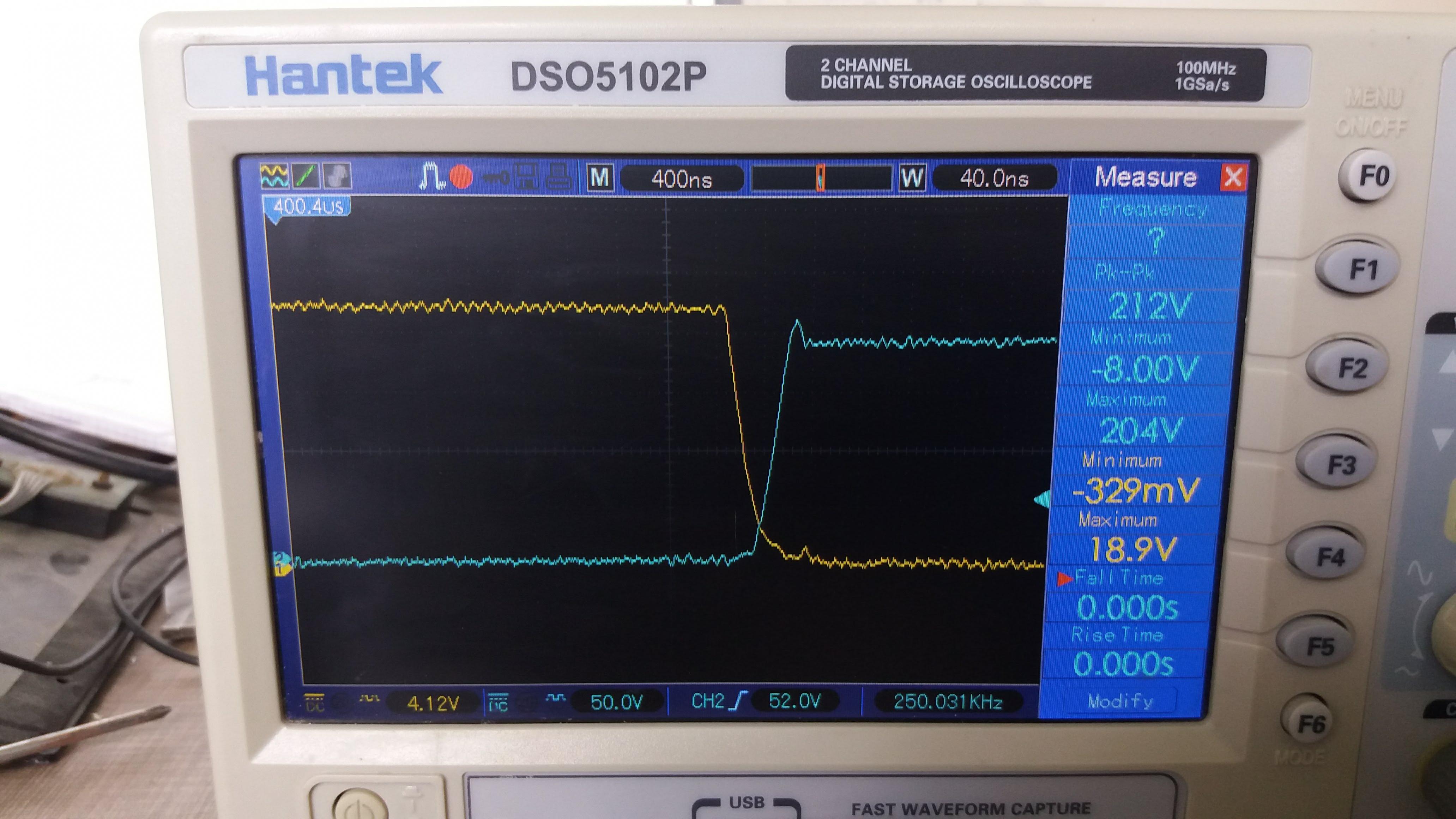

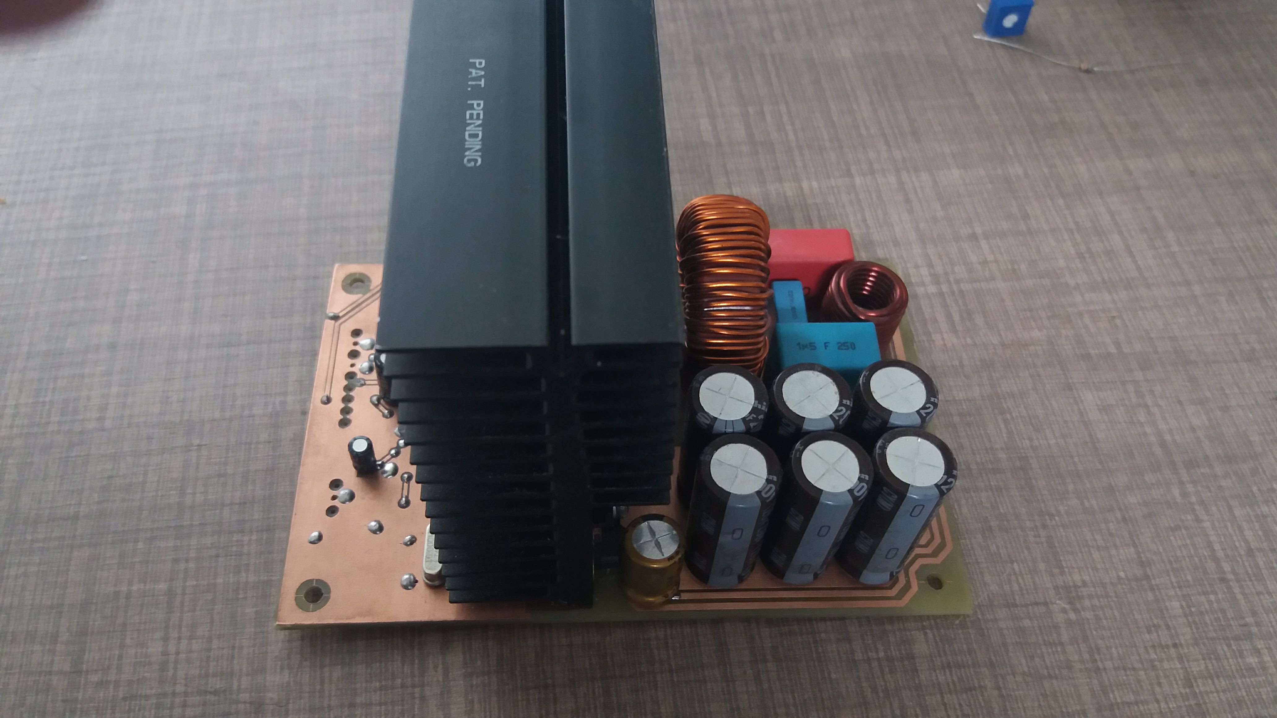

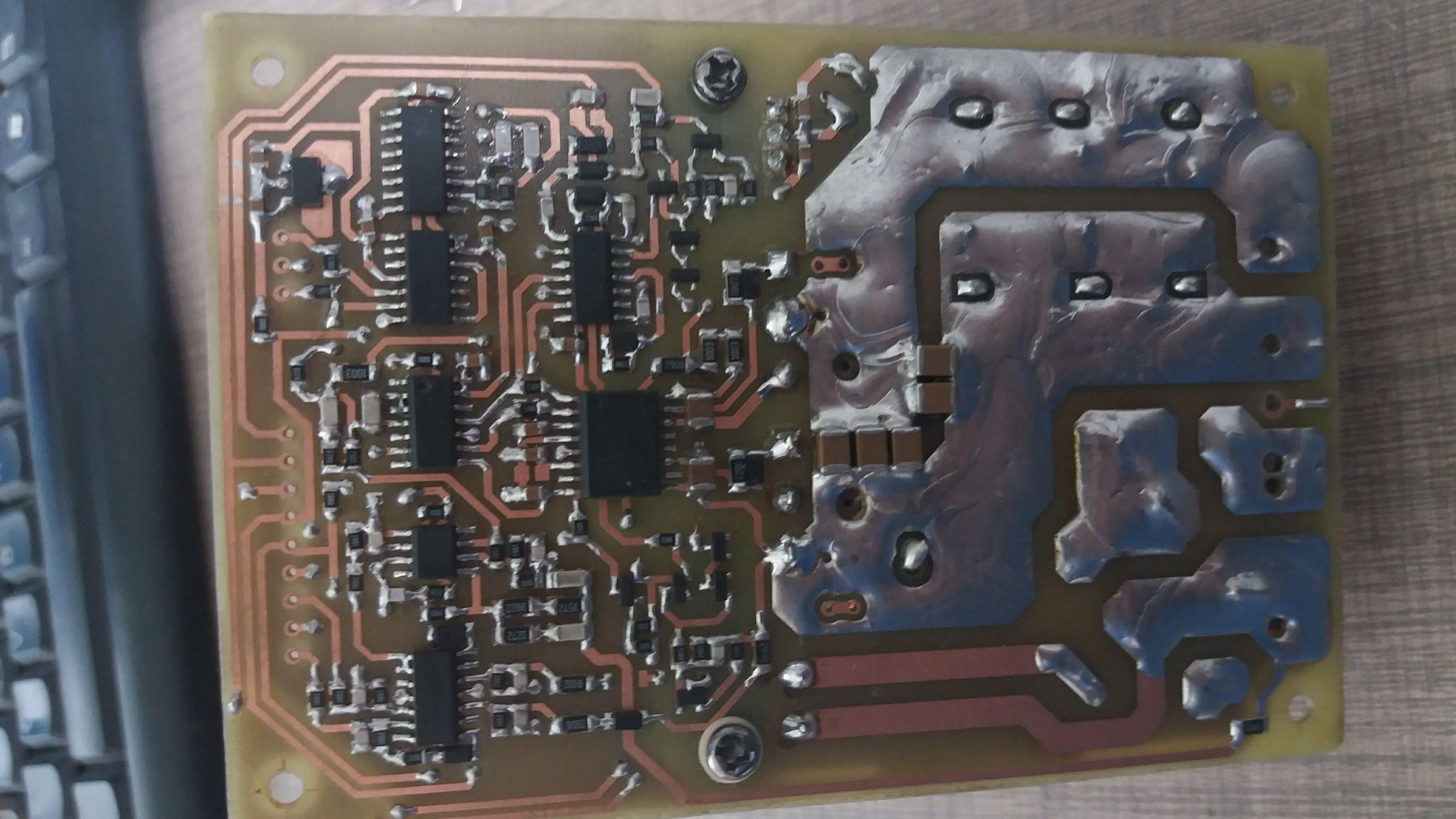

Compared with the initial project started here: Class D amp with 300v mosfets , this one is based on Sic MOSFET transistors:
http://www.rohm.com/web/global/datasheet/SCT3030AL
For gate driver, I use http://www.ti.com/lit/ds/symlink/ucc21521.pdf with simple 18vdc source. Modulator is clocked at 250khz, feedback after the filter, notch at output, for minimum interference with other channels and smps.
Over-current protection uses the RDS(on) of the output MOSFETs as current sensing resistors.
The power supply voltage will be +/- 145 ... +/- 180V, but I chose to test and fine-tune at a lower voltage, +/- 105v with 4 and 8 ohms load, including Chocoholic's hard switching test (load connected to + or -vcc).

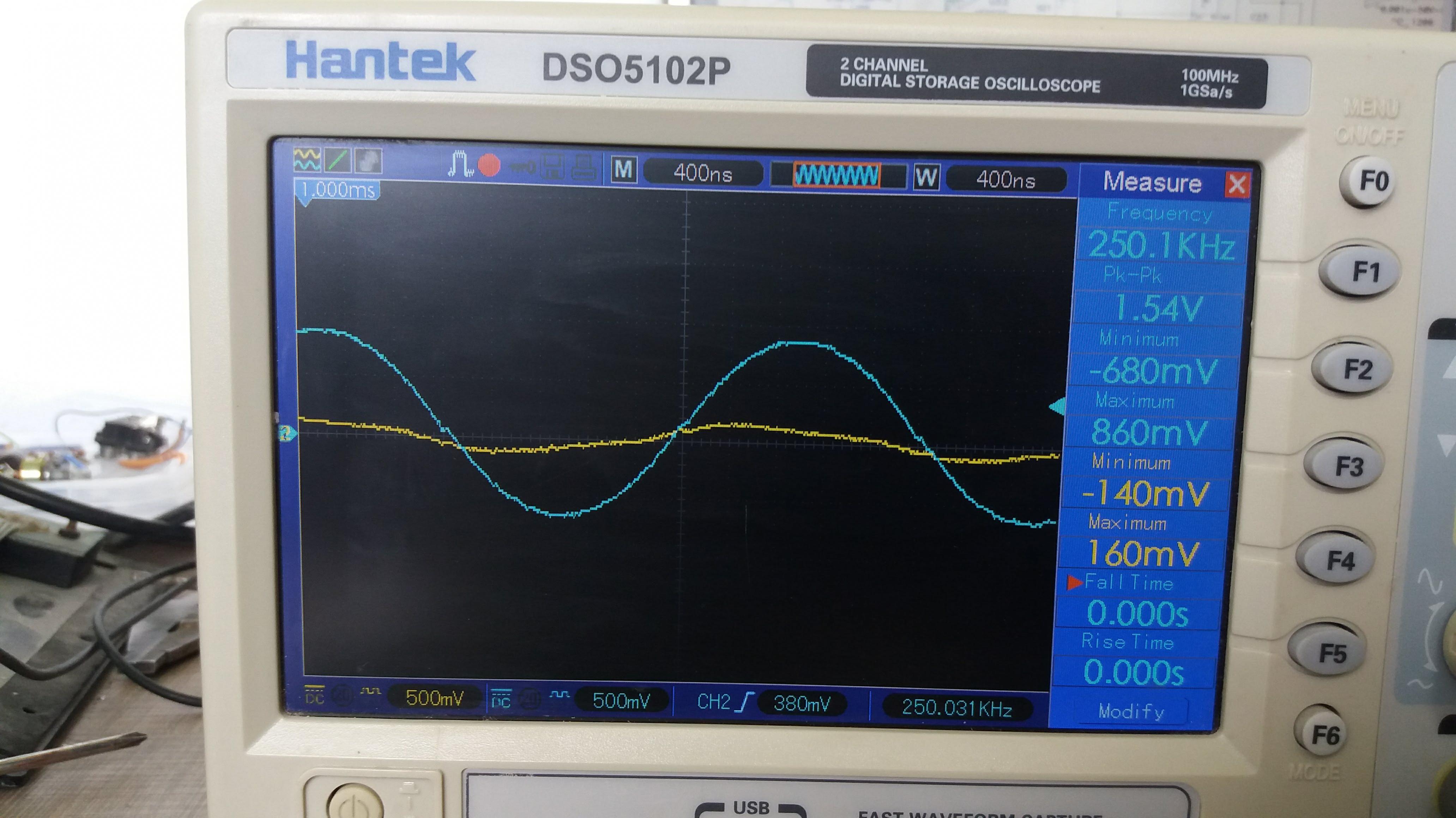

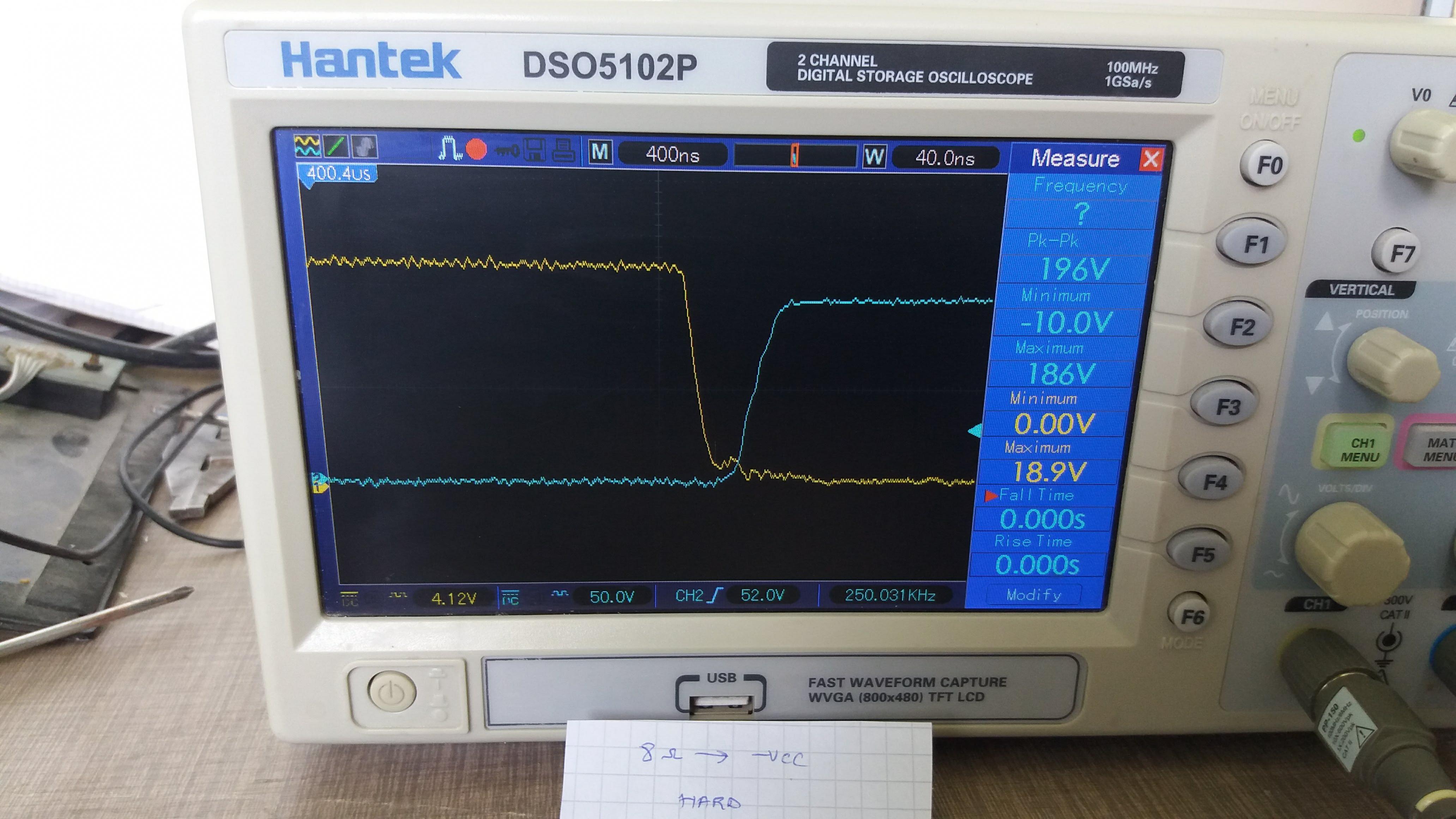

In order:
1-top
2-bottom

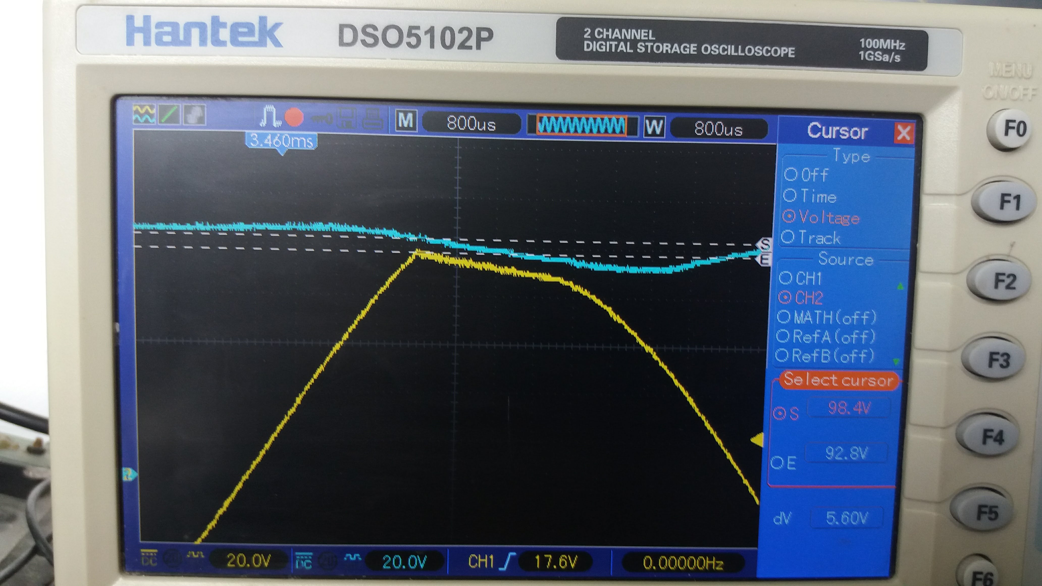

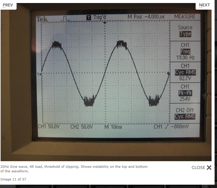

3-residual before and after notch

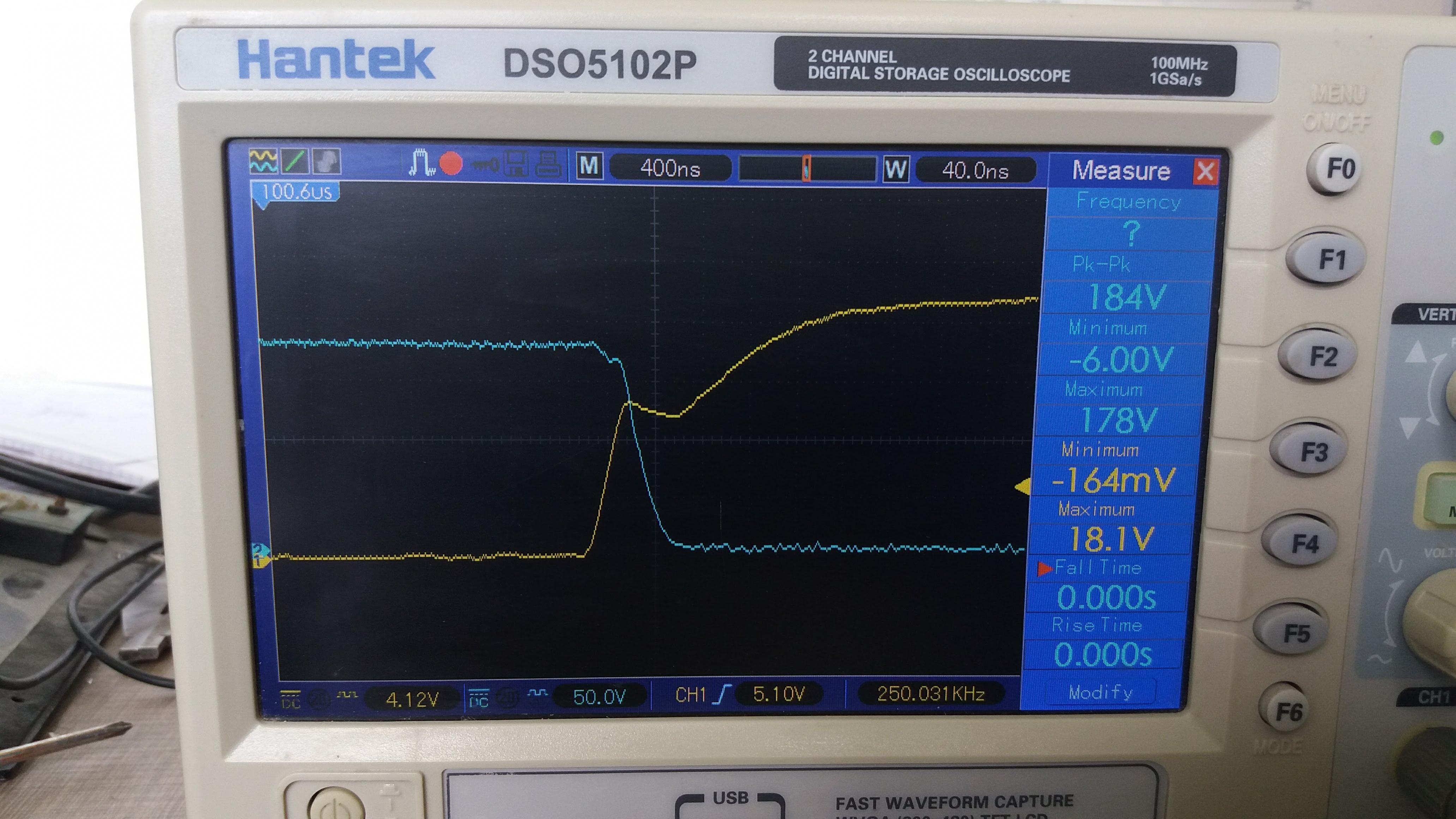

4-Uds, Ugs

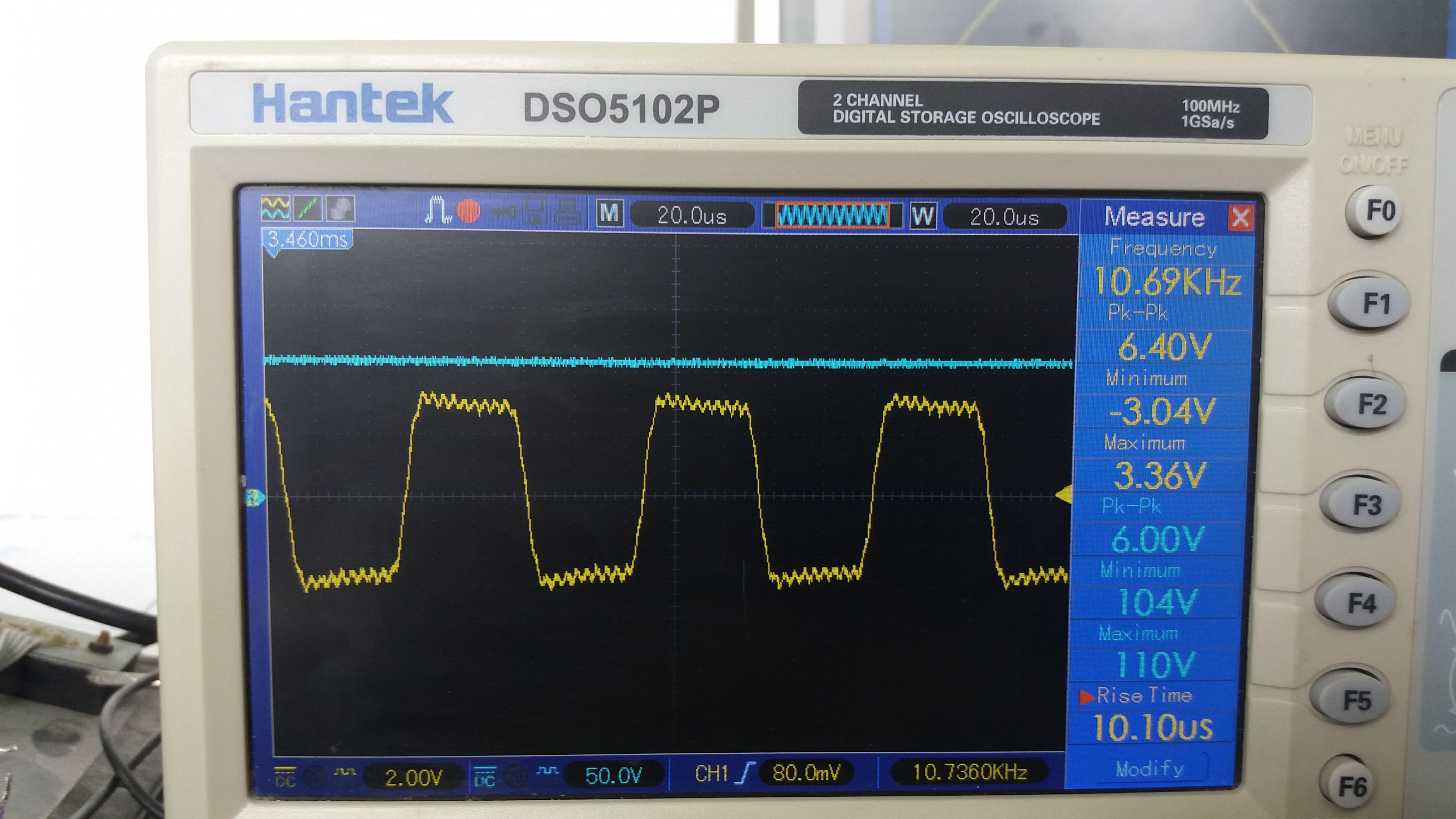

5-Uds up, idle
6-Uds up hard sw +vcc 8r load
7-Uds up hard sw -vcc 8r load
8-Uds down idle
9-Uds down hard sw +vcc 8r load
10-Uds down hard sw -vcc 8r load

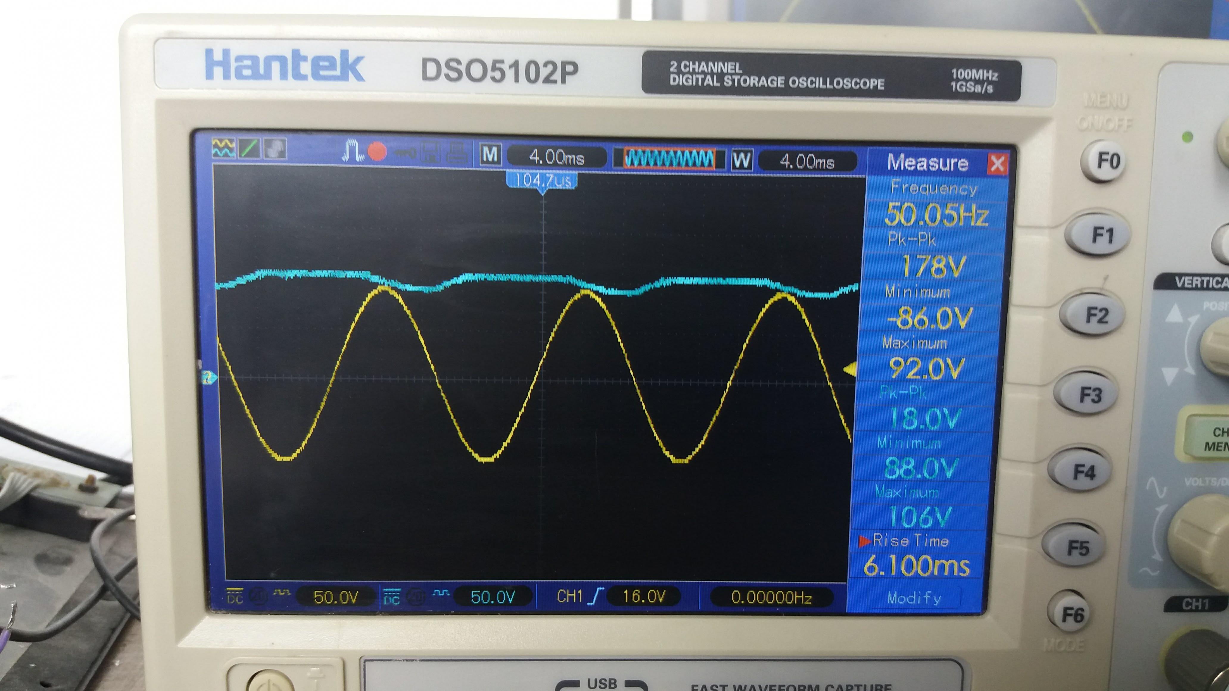

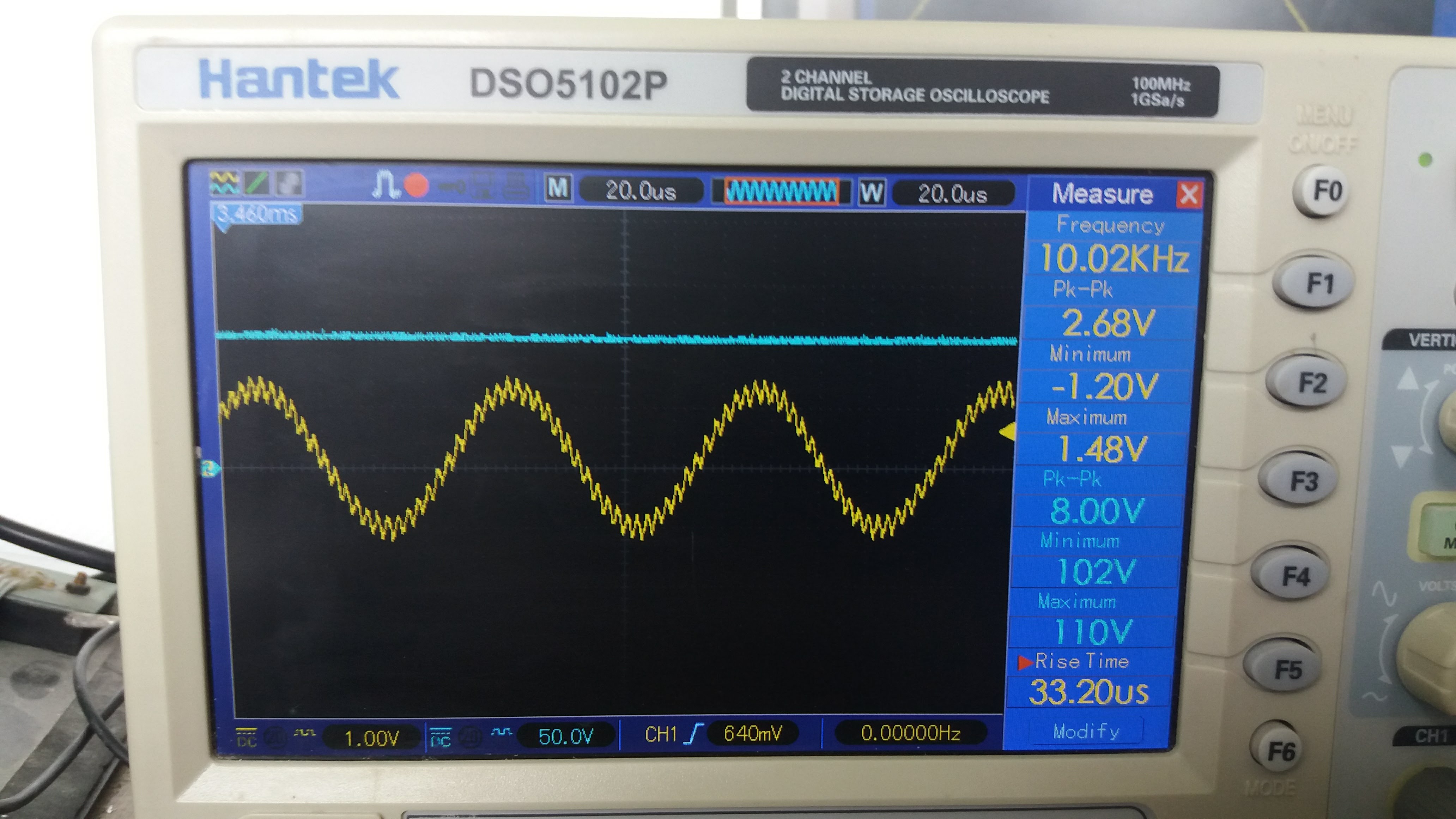

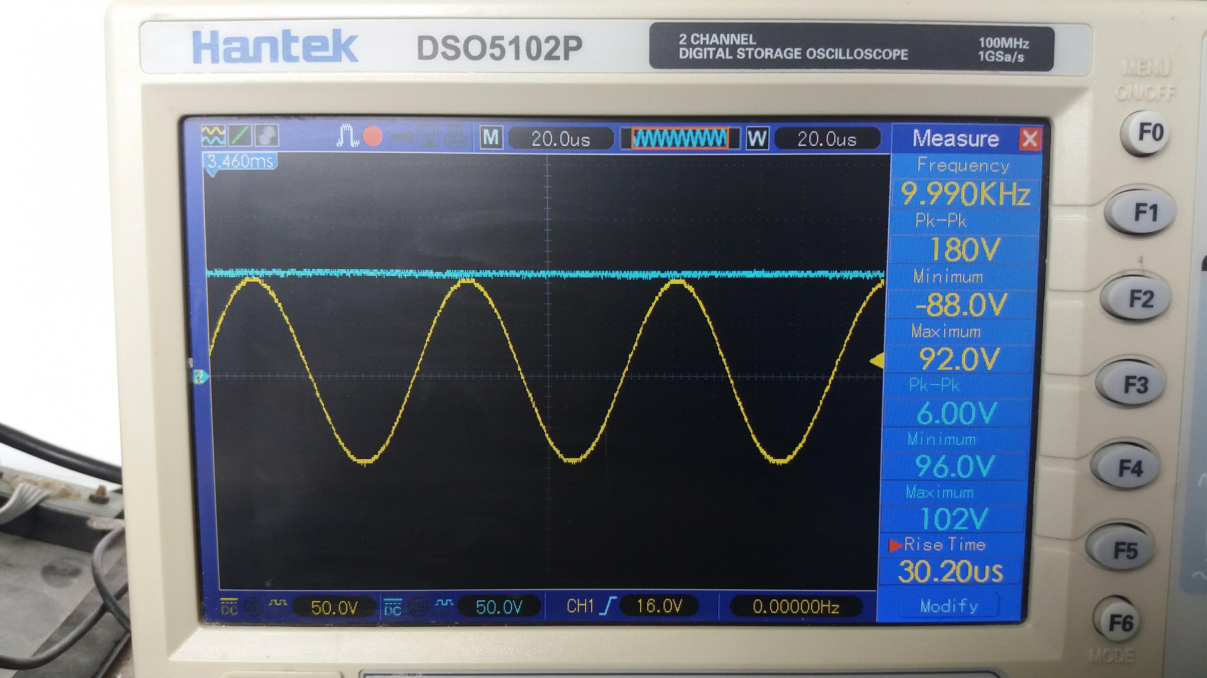

1-lm361 comparator output
2-50hz sine max 4r load
3-50hz sine clip
4-50hz sine hard clip (with active limiter at input, reference from power sources)
5-1khz sine max
6-10khz sine max
7-10khz sine low

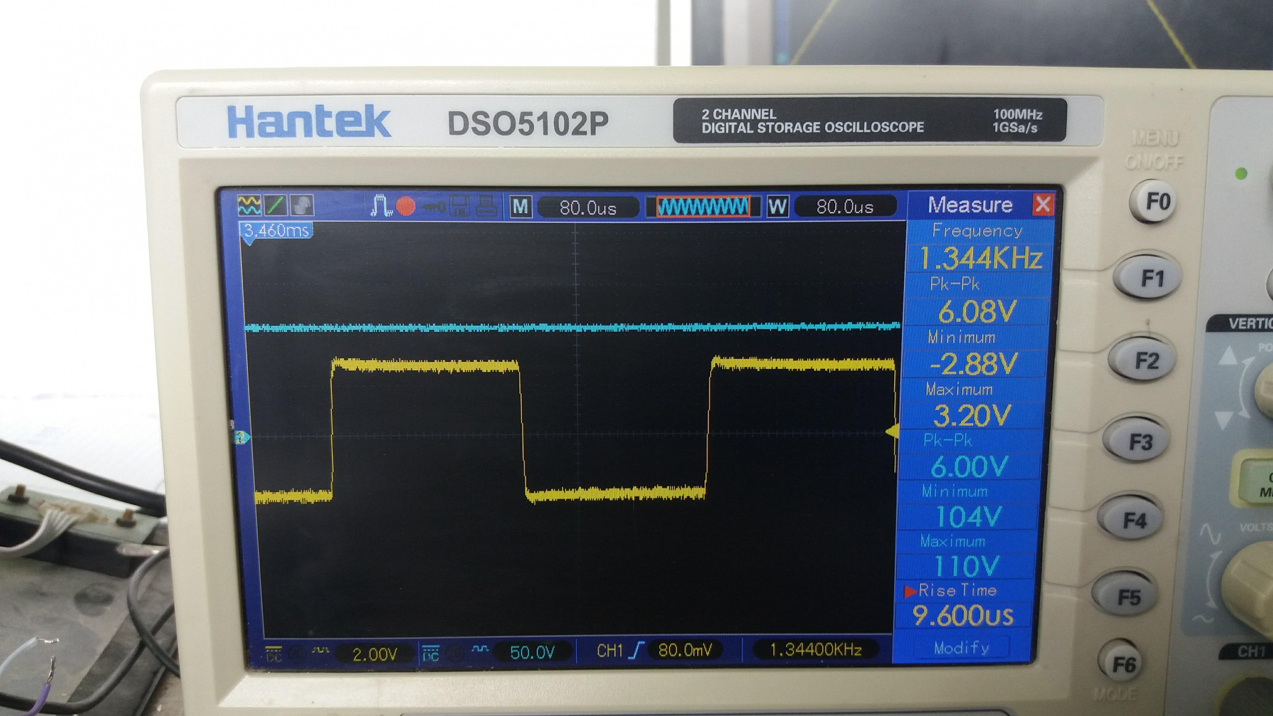

8-1khz square no load
9-1khz square 8r load
10-1khz square 4r load

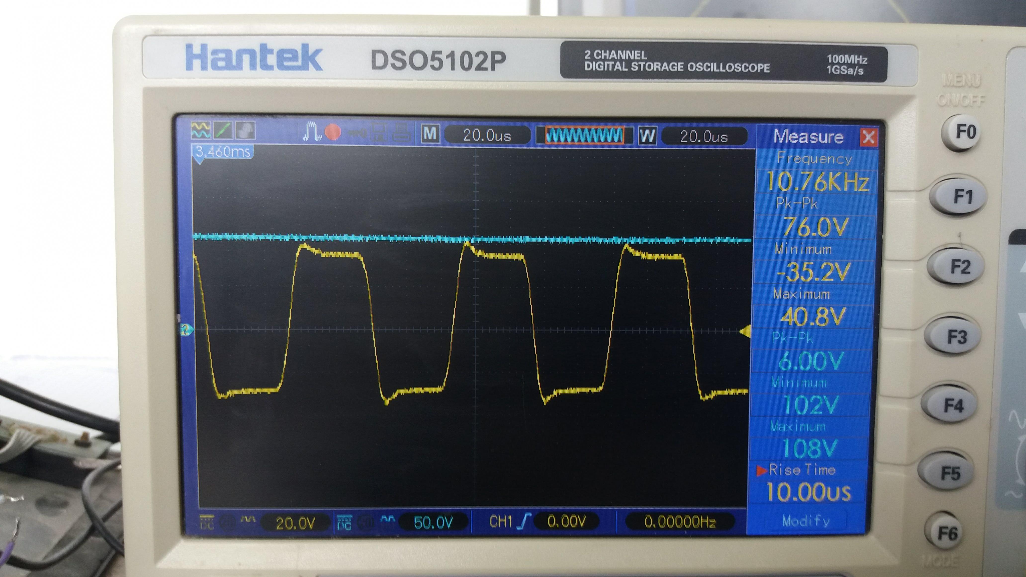

1-10k square 4r load

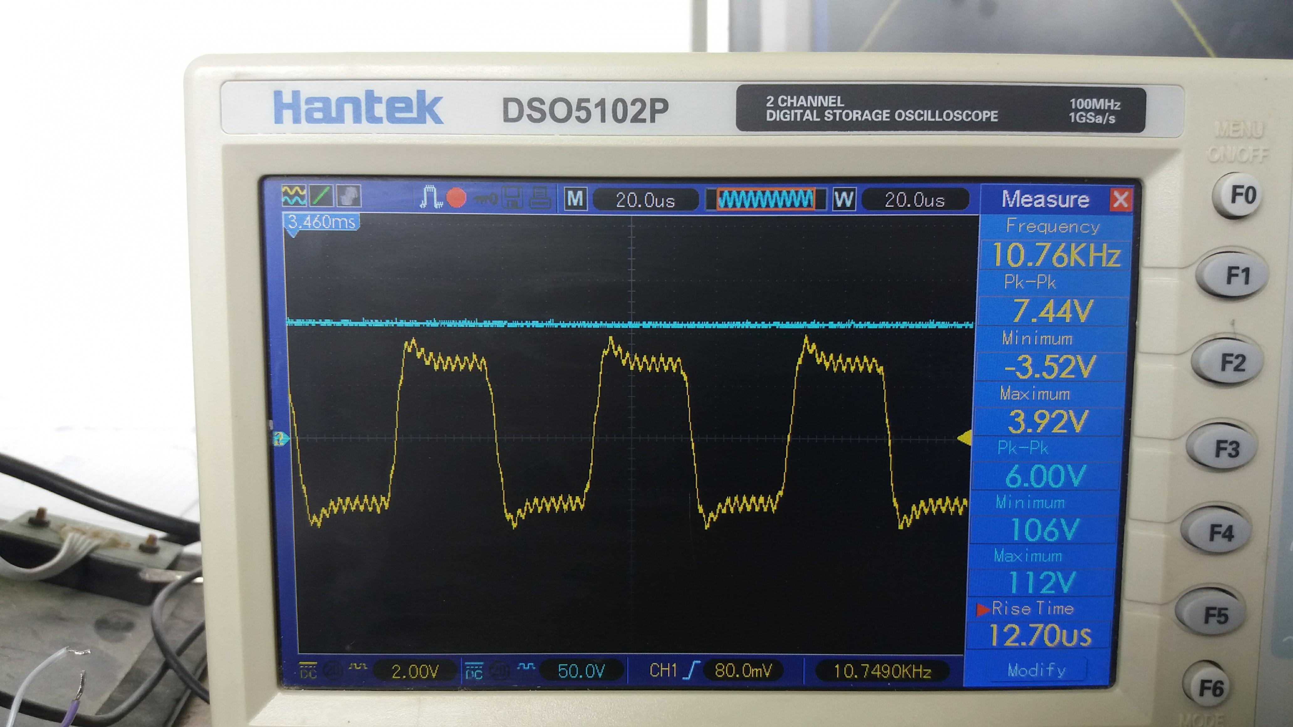

2-10k square 8r load

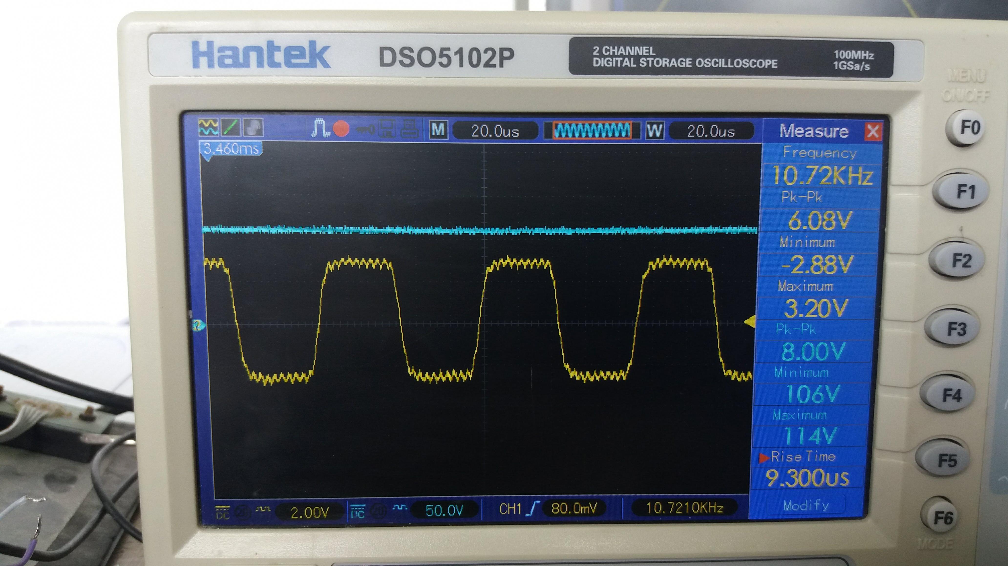

3-10k square no load
4-10k square no load high voltage

...glad to see that you are happy with the SiC approach.
I see, you have chosen a moderate switching speed - that's fortunate for EMI,
but of course generates some more losses than theoretically possible.
But somehow you are right, in real implementations the combination of low Qrr and moderate switching speed is often the most healthy trade off.
My congratulation.
My congratulation.

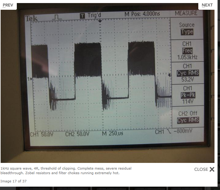

only reason i am not using class D is the amp goes into a sx-3700 and causes low level noise on FM broadcasts as it is 5" from the tuner.
overload capability decreases with frequency.

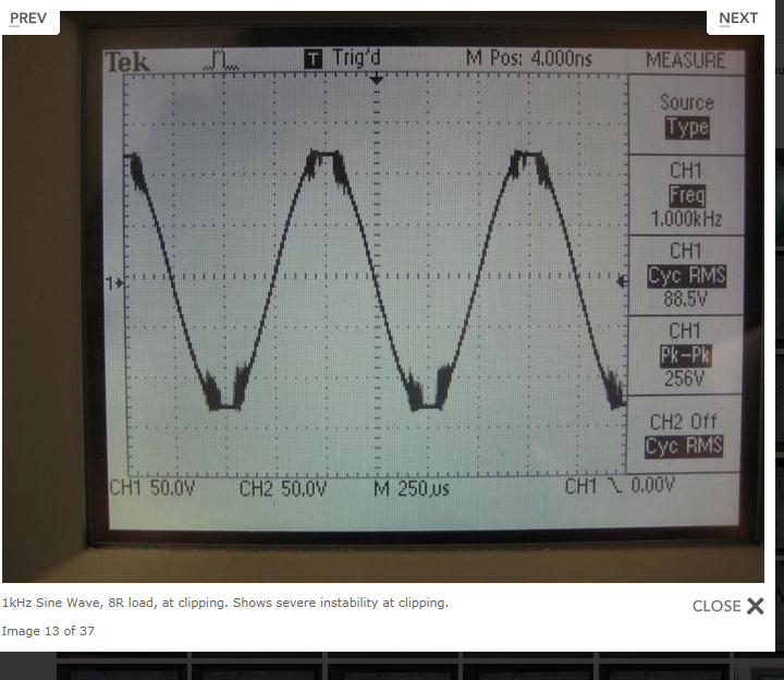

Eve, I understand that you are against the SiC mosfet technology and against the clocked modulator. Nobody forces you to change your mind. But, can you give a constructive advice to improve this amp? I can provide everything you need to know.
I don't read anywhere that Eva is really against it.
Eva's response is just slightly ironic/sarcastic.
But what I do think is that people need to realise which choices and compromises they make and for what reasons.
And that a lot of stuff (especially in the field of audio) can be a result of good marketing instead of fundamental physics.
Still ldoesn't mean you can go for it of course

- His choice is the worst performing type class-D audio modulator implementation.
- His choice is the worst performing type of SiC transistor implementation.
- His work represents no improvement over IGBT and self-oscillating modulator. Cost is 10 times higher.
- I wish I could have so many resources to waste.

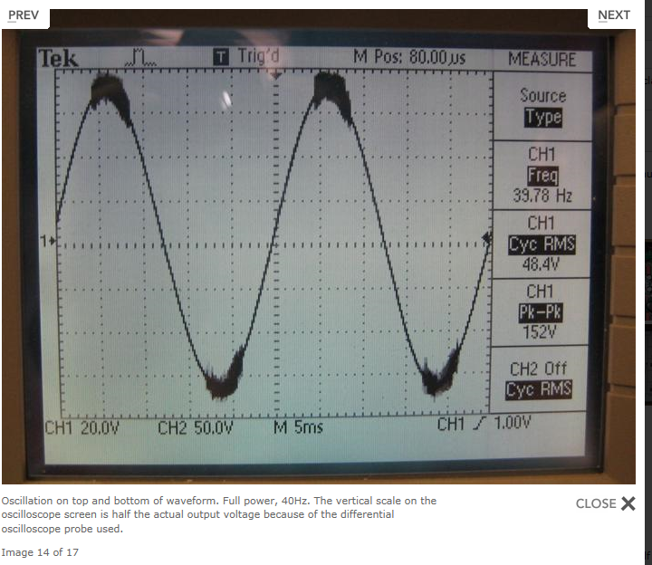

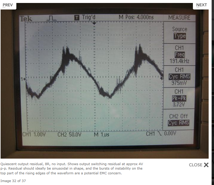

There are many amplifiers on the market with less successful implementations:
PKN Controls XD4000 Amplifier Test Results :: ABELtronics
Funktion-One, FFA F60Q/FFA6004 Amplifier Test Results :: ABELtronics
