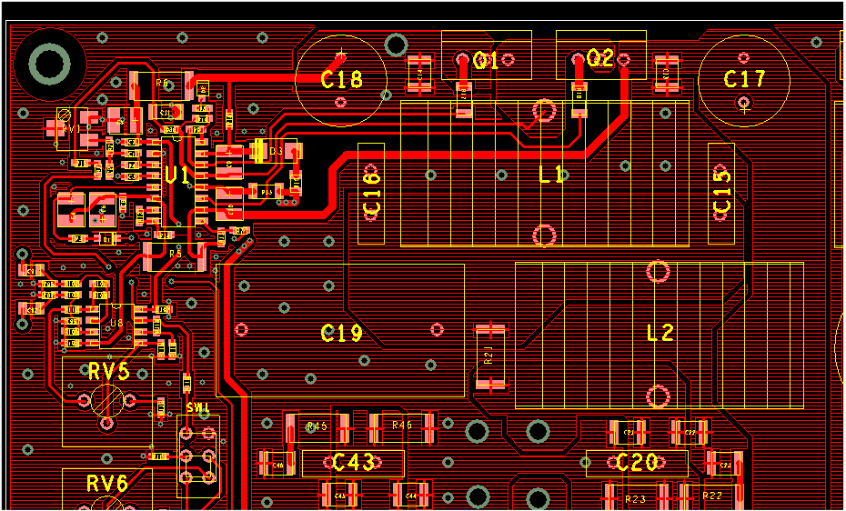

Hi all,
I think now I have fixed my amp 😉
The problem was the low side current limit settings.
When I was using the small RM14 trafo I noticed the amp going
in shutdown at full power but the rails were only 30V.
With the PM50 trafo the rails drops to 42V when the amps shuts down.
Now I am running with no current limit at the low side and with 35A at the high side. What is strange is that the low side current limit was set to 25A but it was tripping much before probably due
to spikes.
The IRS2092 has a blanking interval on the rising edge to avoid this, how could it be possible?
On top of that I have increased the dead time to 45ns (the maximum possible) and I have reduced the SMPS frequency to
70kHz.
I have measured around 700Wrms continuous and around 850Wrms with burst signals when running on a quite discharged car battery. The voltage on the battery drops to 10.2V at full power.
Is there anything wrong in my layout that can create voltage spikes that trips the current limit? The same behaviour is happening in stereo mode when driving 2ohm load.
I have discovered that the IRS2092 is basically an IRS20955 with the input op-amp, am I right? The information on the IRS20955 datasheet are much more complete than the one in IRS2092 datasheet expecially regarding the protections.
Now i have to try some resistors values to have an acceptable current limit on the low side mosfet, I don't want to risk to burn up everything if I short the output....
thank you

i had similar problem using 2092.Basically the same protections of 20955.The main reason was mosfets huge qg and gate capacitance.A mosfet with less qg or pnp+npn buffer after 2092 could help...
there will be DC when the output voltage is greater than 31.8V

The over current trip circuits are absolutely useless.
In all our lower powered ampslifier of less than 300w at 4 ohm we must set the current limit to 40 amps otherwise the chip keeps tripping.
We also use a PNP running off pin 2 (CSD) to send a signal to the on board microprocessor so the operator knows when the amplifier has a fault condition on the speaker lines.
Our new 600w 4 ohm amplifier, we shut down these upper and lower current sensors and dispensed with the PNP.
We use a current transformer, which was on board anyway for the microprocessor control, and the signal for this we use to shut down the amplifier. Works great.
