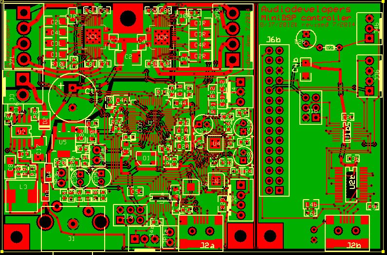

You might recognize the right side of this PWB layout: it is that miniDSP piggyback board. But the cool stuff is on the left side. It is an ADAU1701 circuit (basically the same as the miniDSP board) plus 4 nice little power amps. The amps are at the top: there are two stereo SSM3302's. These amps can be run at 15-18V and generate an honest 15W per channel. That's not a lot of power, but by using the ADAU1701 as an active crossover, you get enough crest factor improvement that 15W might be adequate. The board also has two additional analog outputs for a subwoofer or a pair of woofers (using one of the digital output lines from the ADAU1701).
I built up one of these boards but I still haven't tested it. Got the SigmaStudio program for this board ready and it has been tested, but there is still some additional firmware needed. I've got too many projects right now...so stuff is getting done slowly.
There is a "clone" of this board that was done using DesignSpark that will be made available as an "open" design. If someone wants to get a board made, I'll build one up and test it.
