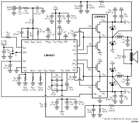

I have a question about another Class D amp,as you seems to know what youre talking about.It is with LM4651-LM4652,as in the schema,is it possible to paralell more LM4652 modules for more output power.Or do you know of any other DIY Class D amp,
with outpup power of 300w or more for driving a Sub woofer?

hi.
>as you seems to know what youre talking about> , who??
do you mean 300w into 4 ohms? rms or peak?
you can use higher power fets with the driver and get more power , do you want to make your own layout?
if youre not familiar with design and layout of pwm amplifiers another good option would be to buy a finished amp or module.
rgds karsten madsen - www.cadaudio.dk

I mean 300 or more rms.I am not so familiar with design and layout of pwm amp.But I know theres a evolution board for thisdo you mean 300w into 4 ohms? rms or peak?
design to buy,and I am not afraid of experimenting to see if it works.So its not a god idea to paralell more LM4562´s as they are modules,that put out 170W/4 Ohm-10% dist.I already have a transformer 2x30Volts that I is possible to use with this design,but I need more output power.That´s why I thougt of paraleeling,or could you suggest any higher power fets and how to connect them-to get 300w or more rms.By the way I thougt the LM4561/62 where quite cheap.On cadaudio it says Class-T amplifier is it the same as class D?
I found out from the national website´s FAQ that it is possible to
connect 2 modules in paralell,maybee i´ll try with 3 modules.Anyway how critical is the lenght of the wires to use from the board to the modules,if I use say 3cm wires,will there be any side effects?
ryssen said:I found out from the national website´s FAQ that it is possible to
first of all... a 2 X 30volt transformer is too high voltage rails for this amp, and second, paralleling output ICs will only enable you to drive lower impedences...
