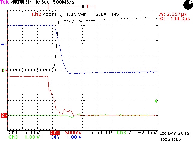

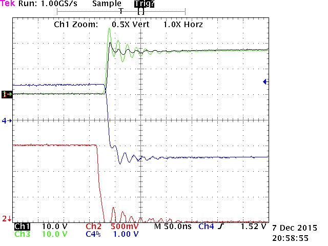

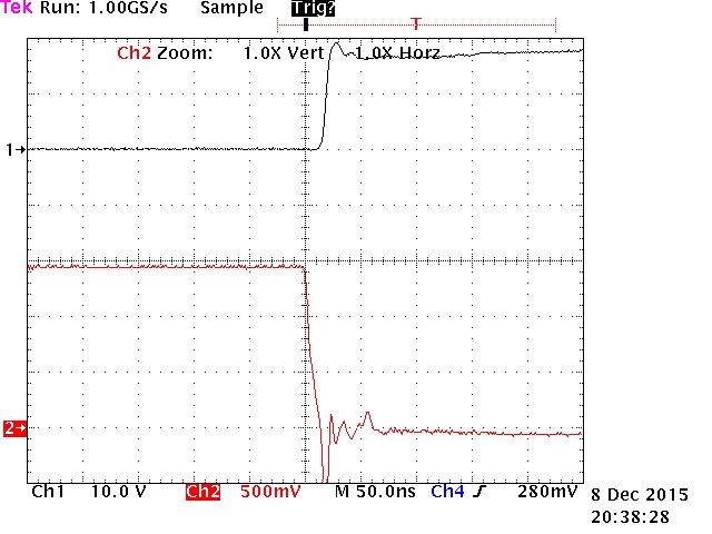

Like always in power electronics the only way to see why/where/when the losses are happening is to measure the switching events with the particular device.
Attached three measurements with C3M0065090. All showing the turn off of the low side switch when the halfbridge is sinking current. All without driving negative Vgs.
The first one is directly driven from the IRS2092 (10R and diode), here the fall time of the current is about 50ns.
The second one is with an additional PNP for the gate, now the fall time of the current takes about 15ns which is already touching the best case from the data sheet and was easily fine in order to mod LiteAmp to the same power level like my 2kW design.
Also note the unpleasant oscillation caused by the parasitic inductance of the wire loop + current probe, already making me afraid at 25A.... The last picture shows the situation without current probe at a current level of 40A.
Picture 1: Directly driven from IRS2092 with 10R and diode. Ch3 not used
Picture 2: With PNP.
Picture 3: With PNP. No current measurement. Ch3 and Ch4 not used.
Ch1: Vds directly at the device pins, 100V/Div.
Ch2: Vgs, 5V/Div.
Ch3: Vds including voltage drop of wire with current probe, 50V/Div.
Ch4: Ids, 10A/Div.
Ch2: Vgs, 5V/Div.
Ch4: Ids, 10A/Div.
Ch2: Vgs, 5V/Div.
Ch4: Ids, 10A/Div.

Here are some results with ipp410n30, +/- 145v, 3.8 ohms load, 50hz sinusoidal input. As only a portion of the sinusoid is displayed, the Vpp value must be composed of Vtop x 2, resulting in 250v pk. You can also appreciate the time when I asked for this power. I also connected a speaker with a resistive divider, so that sound can be heard at that power (unfortunately, there is a lot of ambient noise). Whoever tried it knows what to look in this case. Who has not tried yet, should do it.
