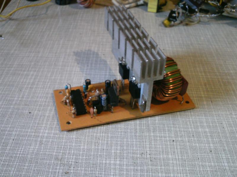

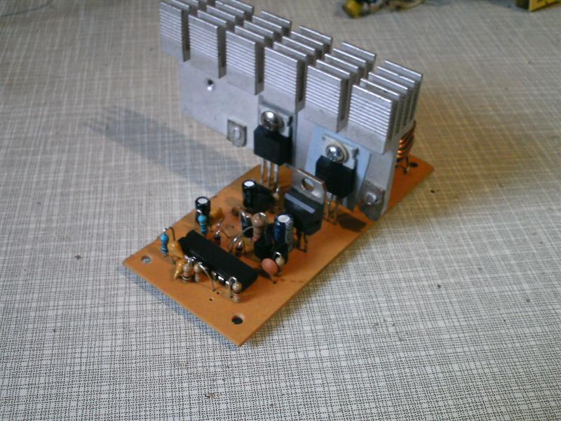

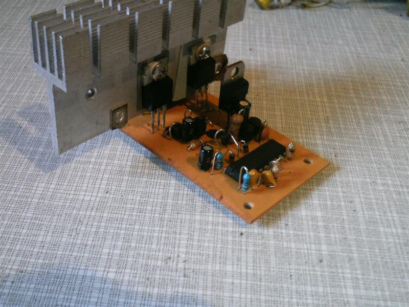

I have designed a decent PCB and moved all my components from the other one. There is now room for all the parts that were added later on the old one. It works great so far. I made two side by side so i can make a bridged amplifier working at 12 volts, as my goal now is to make some small powered speakers with two 2" drivers each.
I have bought these little speakers for like $2.50 a pop, and found them to sound brilliant for what they are. They are very bright, clean and can handle a bit of power. I have bought several other 2" speakers in the past from the same store and they sounded like crap, so i abandoned the project. But these ones are better than expected, so i will be buying more of them and building a few speakers. I will also likely build a small subwoofer to make a 2.1 system with them. I do have two 8" subs installed in my desk, but i can't always play that coz it bothers the neighbors, so i want something smaller and lower power.
So i thought that it would be a good idea to use the TL494-based amp for these speakers, as it would be rather small and very efficient. It will be running bridged at 2 ohms (4 ohm speakers wired in parallel). I'm currently in the process of populating the second PCB, and then i have to build the bridging circuit before i can test the whole thing.
If it ends up good, i will share the PCB, but i will leave some part values out for people to experiment with. It's a simple circuit anyway, there are not too many variables. And also, maybe someone ends up with better values than i did. :)
Not really. It suffers from most of the same limitations. Also, the TL494 can be clocked externally making multiple channels easier.
My bridge is currently working, but there is something wrong with the second board, it is distorting a bit. Likely it is due to the fact that i used just random transistors as i was short of one 2N3904 and one 2N3906. Checking it on the scope now.
The noise performance of the bridge is much better than the single-ended one. I clocked the second board from the first one, and since they are operating in antiphase, most of the garbage that gets in cancels itself out. If i can stop it from distorting it'll be perfect. :)

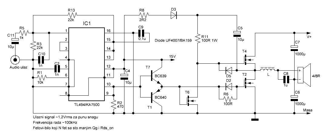

You .can't modulate it by this way.You can try this:
I did build this design from parts extracted from an old computer power supply including the choke and purchased a bunch of TL494 devices for cents each. Using a breadboard this worked first time, the driver FET does get a little warmbut I did get the amp to run quite nicely at 15 volts up to 30Volts and did not take long to patch together. The sound quality was really very good despite not having a perfect filter (had about 20mv of 100Khz ripple with the bits I had at hand) and the bass was really excellent. If this was used in a general purpose stereo it would not be too shabby
I tried regulating the supply to the 'driver side' to get some control over the heat but the circuit did not behave as well so not sure quite how the design is working so any technical background would be helpful however I intend to play with a proper driver as a primary playground.
