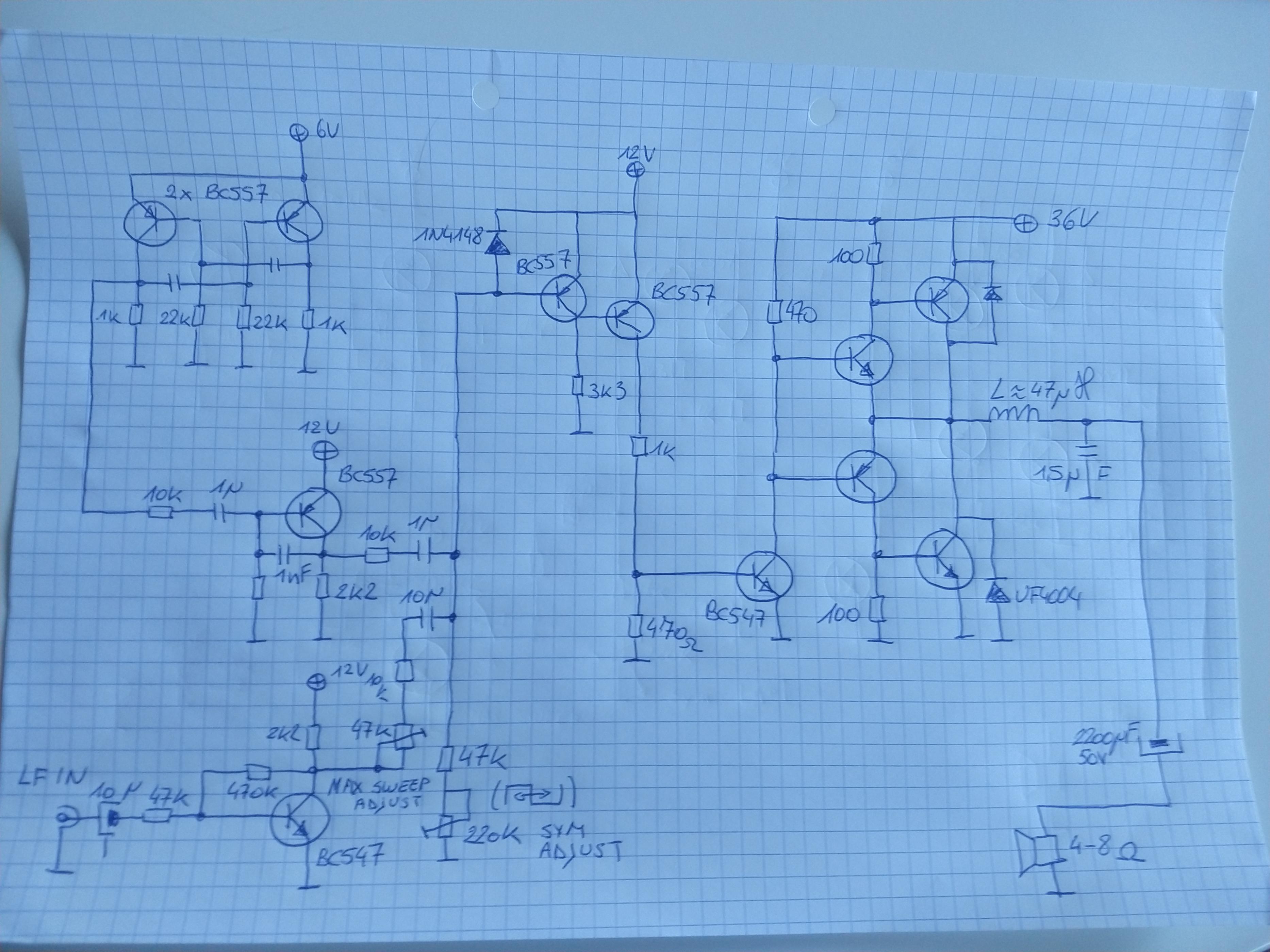

Class D Amp simple rebuild off Sinclair X20
Schematic
