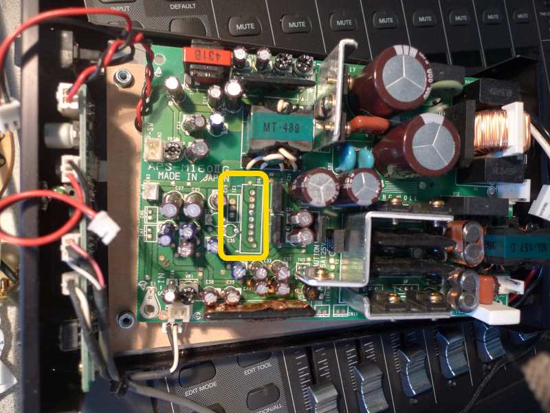

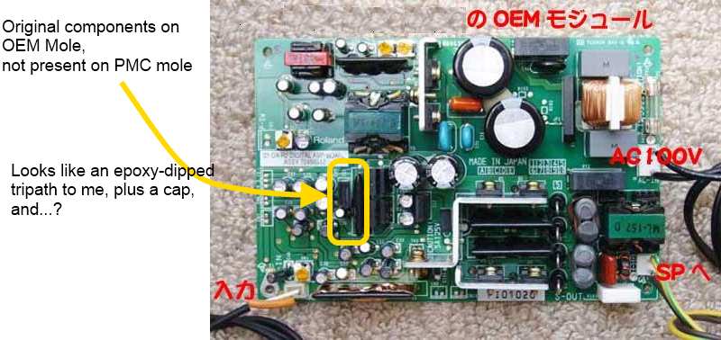

Possibly good news for DIYers: there are still some Roland-branded Flying Mole OEM circuit boards floating around Japan for a very reasonable price. Class D monoblock, 160 watts into 4 Ohms, 100w into 8, they sound fierce. Just add connectors, but there is the 100 volt issue, and the procurement hassles, hmmm... They were apparently used there for Karaoke installations, and DIYers there call them "Black Moles".

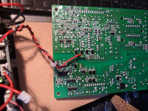

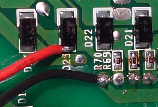

Here are some pics of the differences between the OEMs and the full DAD-M100 Pro build if you are looking to replace a faulty Mole- seems some circuitry has been removed and the topology bypassed:
Roland OEM Flying Mole board:
PMC/Flying Mole DAD-M100 pro BI guts:
Underside showing bypass zone:
Detail:
Unfortunately there is epoxy-dippage, so we may never know what's really going on with the circuits for repairs.

The distortion and random overheating on one of my DAD-100 pro amps was cured by changing the two large 390uF, 200v capacitors. Can't miss them, they are the largest electrolytic capacitors on the board. In my case, the top of the reservoir capacitor had blown into a dome (instead of flat) which was a tell tale sign of failure. They have an approximate life of about 3000 hours.
