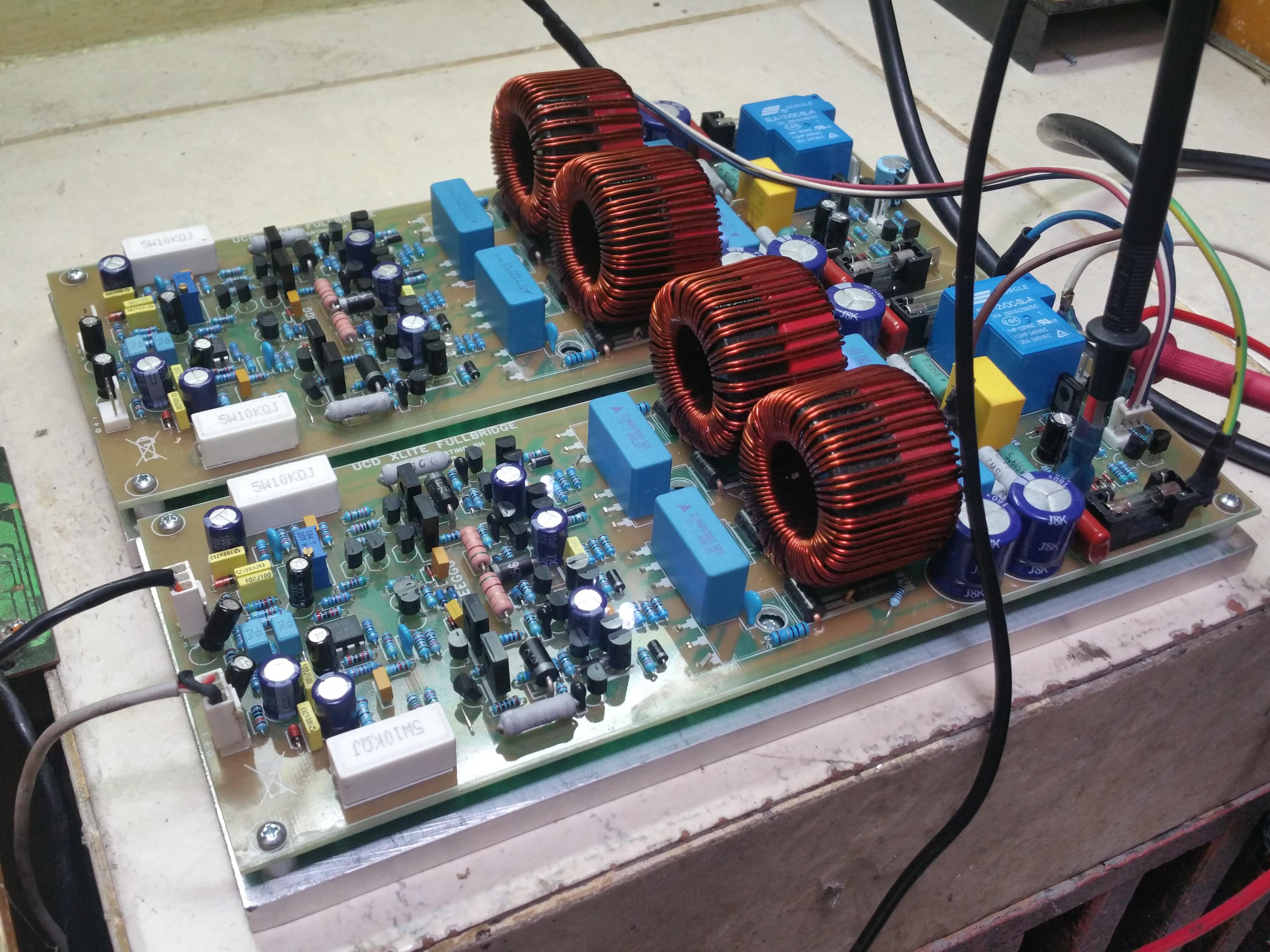

My UcD Fulbridge for PA
Supply +/- 90Vdc. Tested live to drive 2x18" vc 5" and the speakers are on peak already

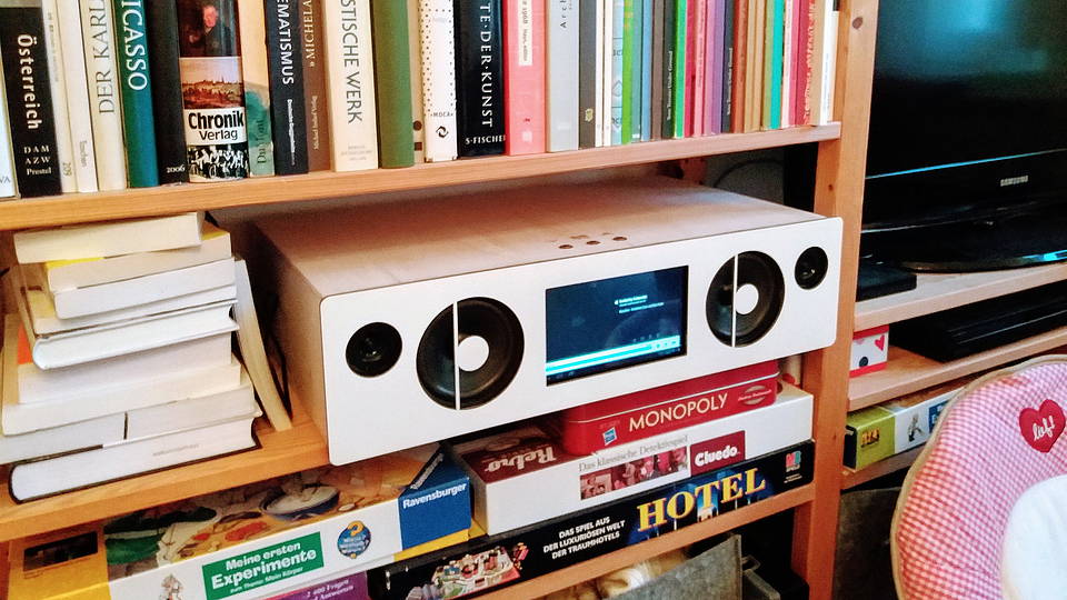

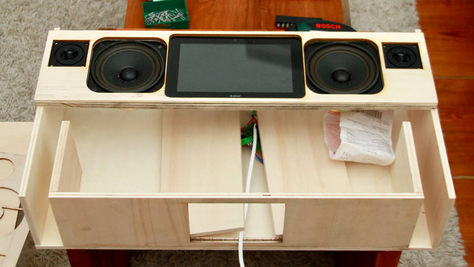

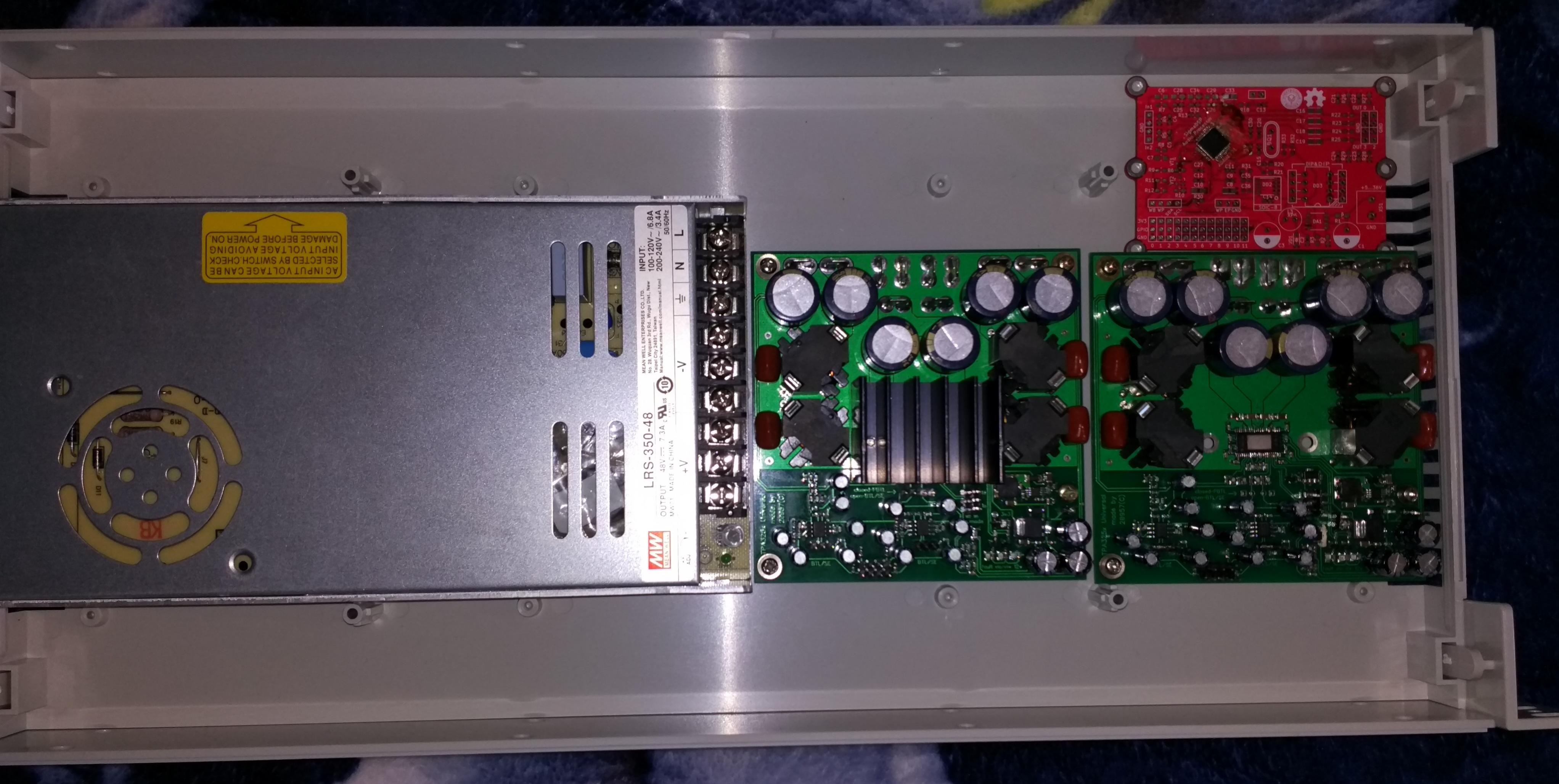

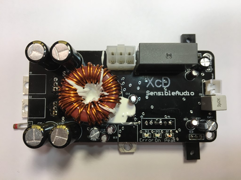

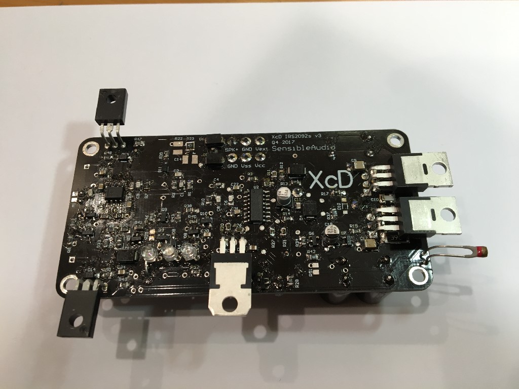

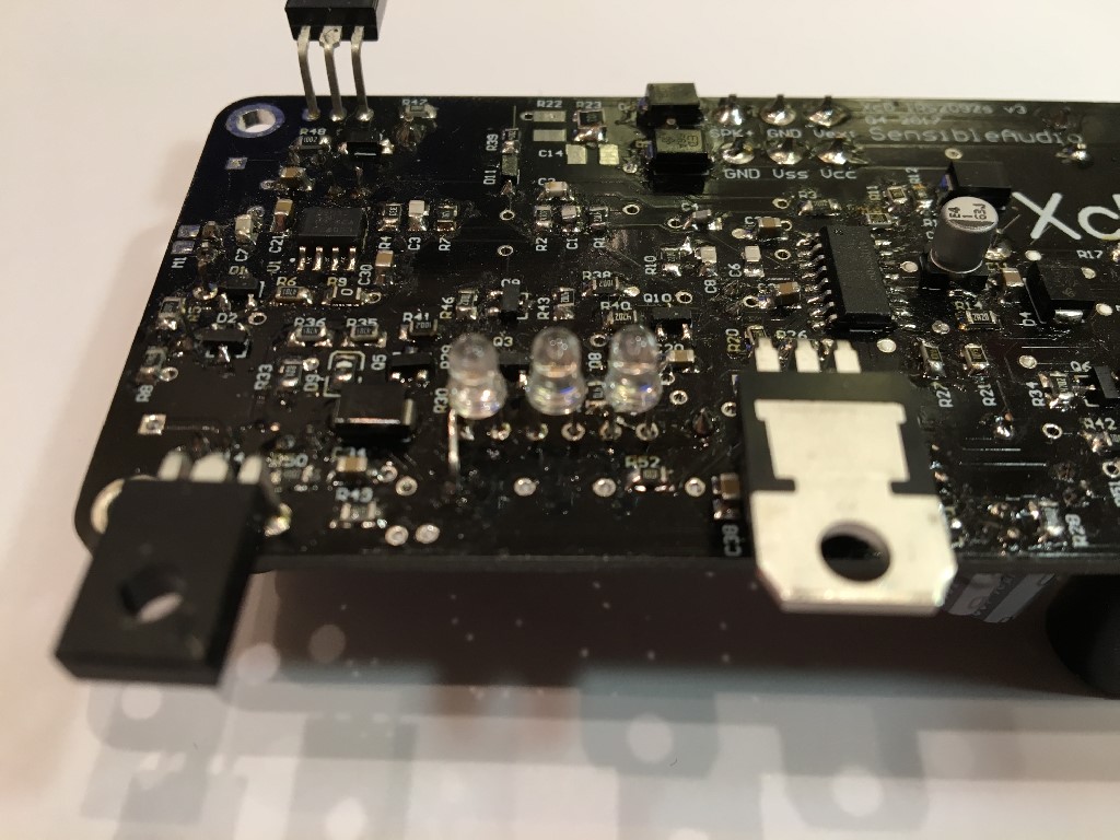

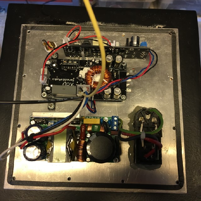

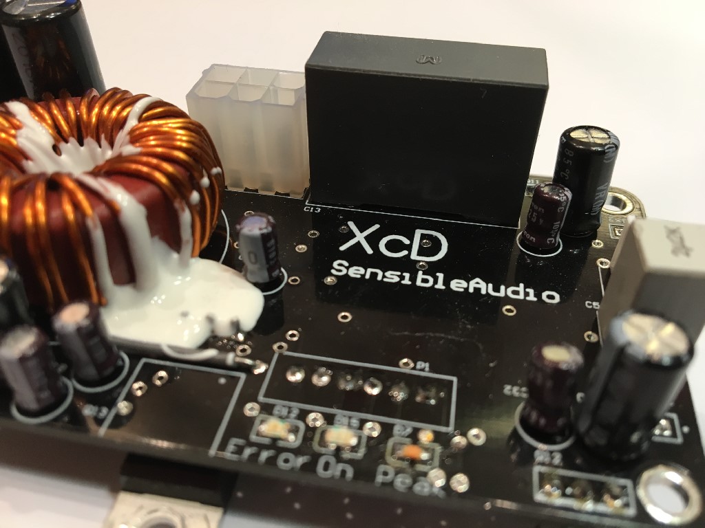

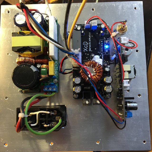

Small Class-D Plateamp
Finished my small plate amp for my mini sub
( Reckhorn Mini-Sub )
Amp based on IRS2092 but with a mix of post and pre-filter feedback.
Running 200 W i 4 ohm, using a Connec Electronic 240R SMPS with +-40Vdc.
