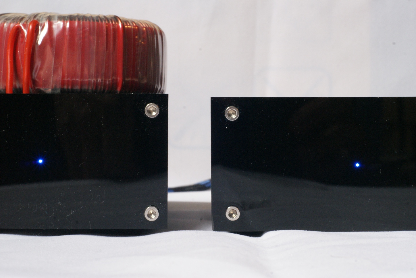

Stereo JLAudiophile-250D.

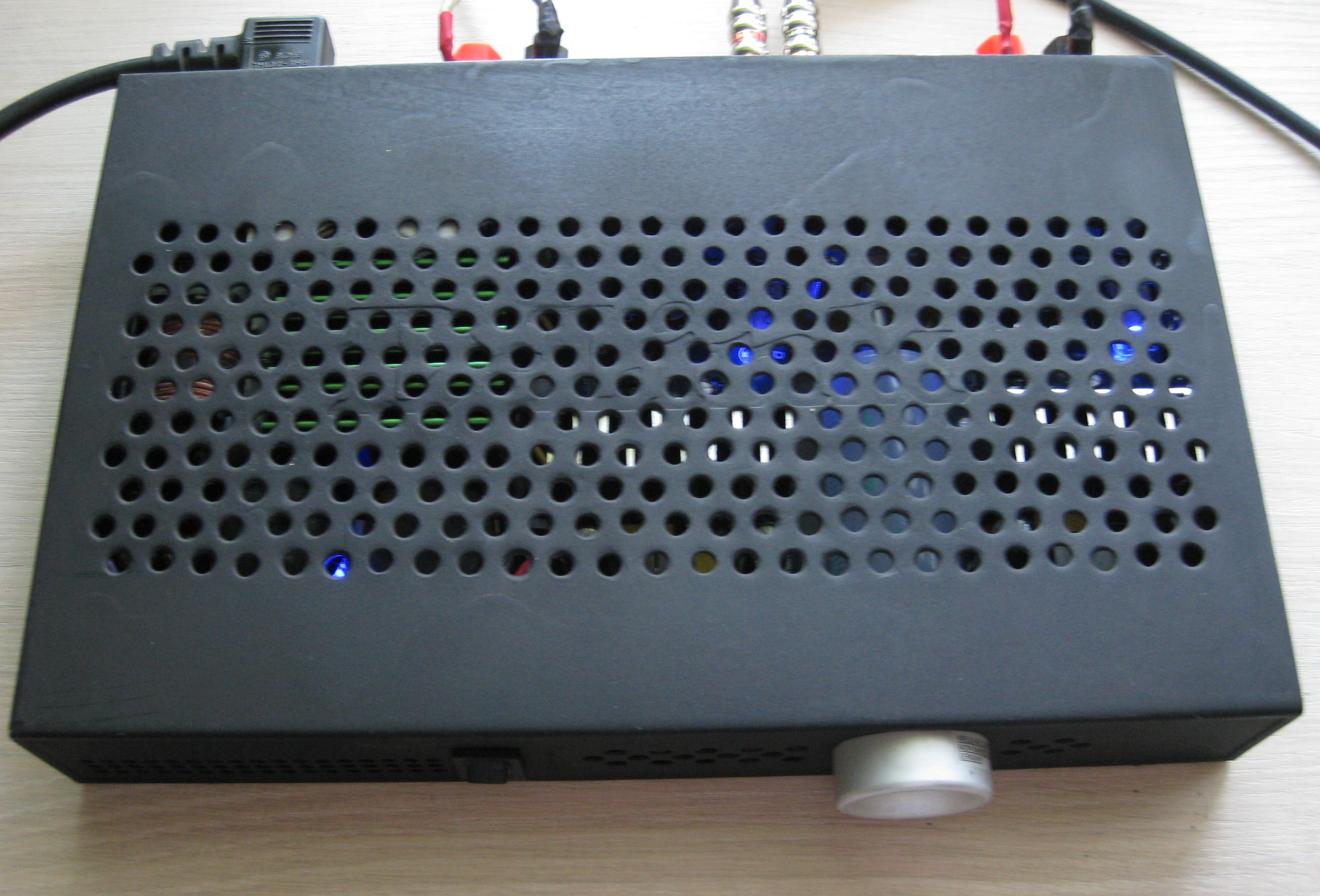

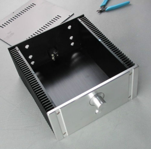

Next build, I'll use an ebay enclosure like in the second pic 🙂

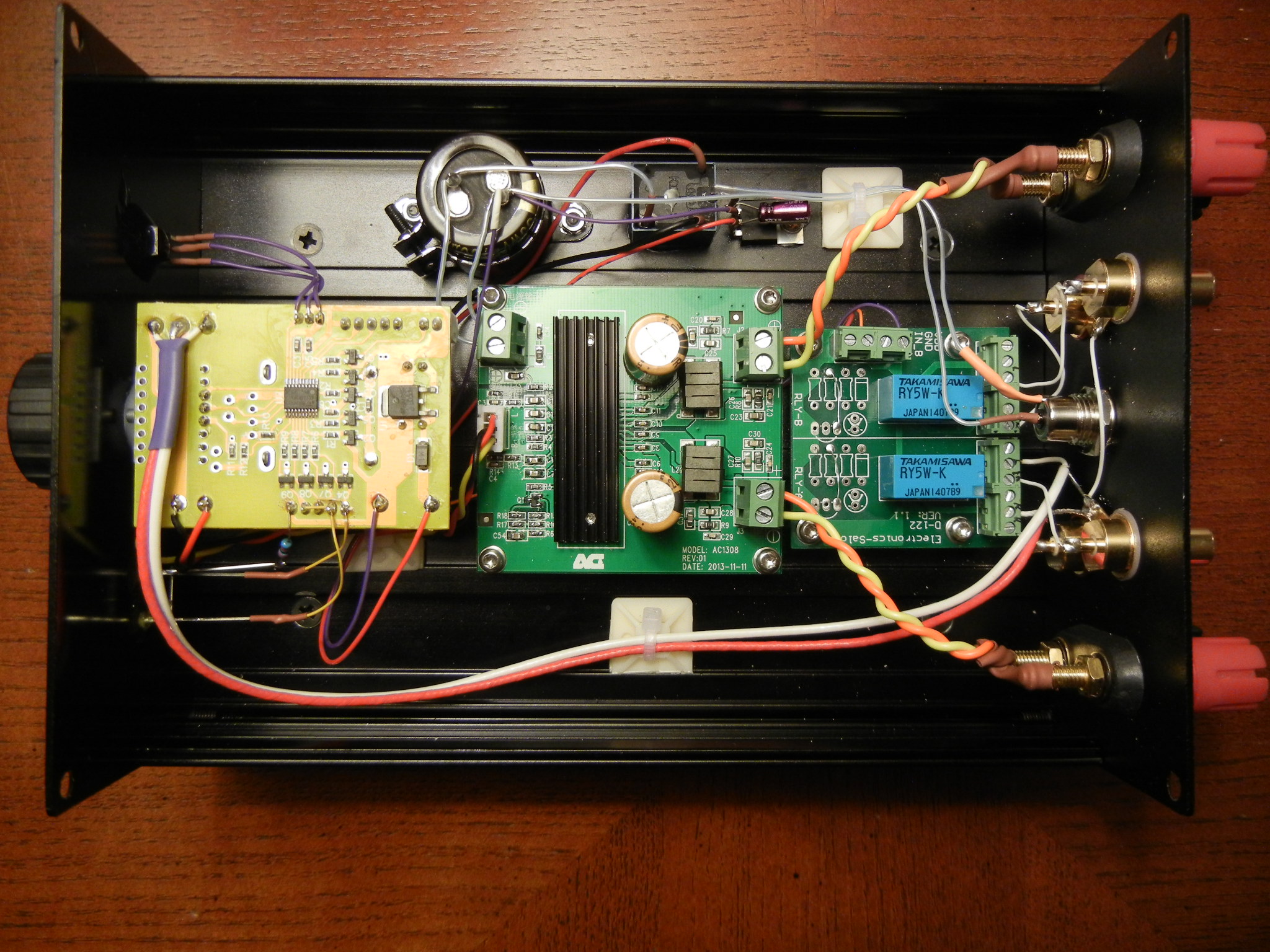

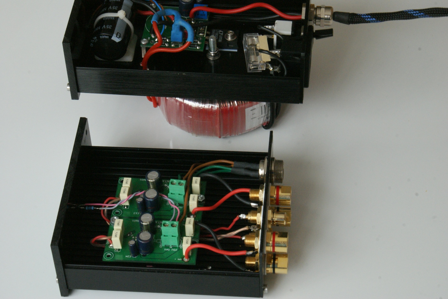

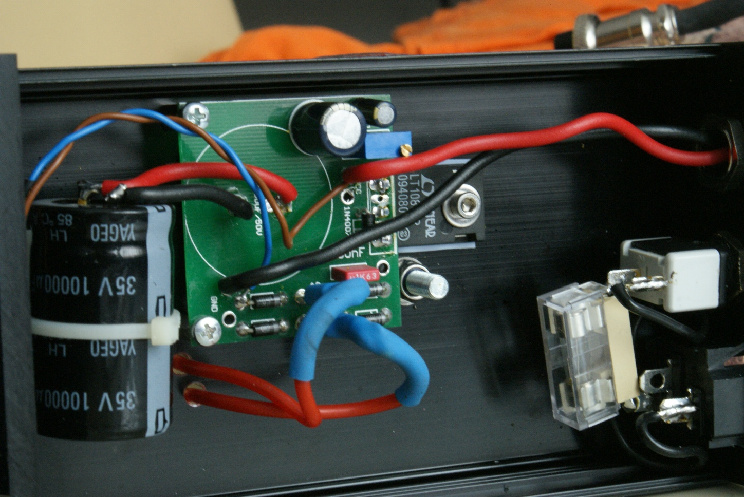

Just another TPA3106D1 amp. I am using LT1083 for power supply.
BR,
Ales

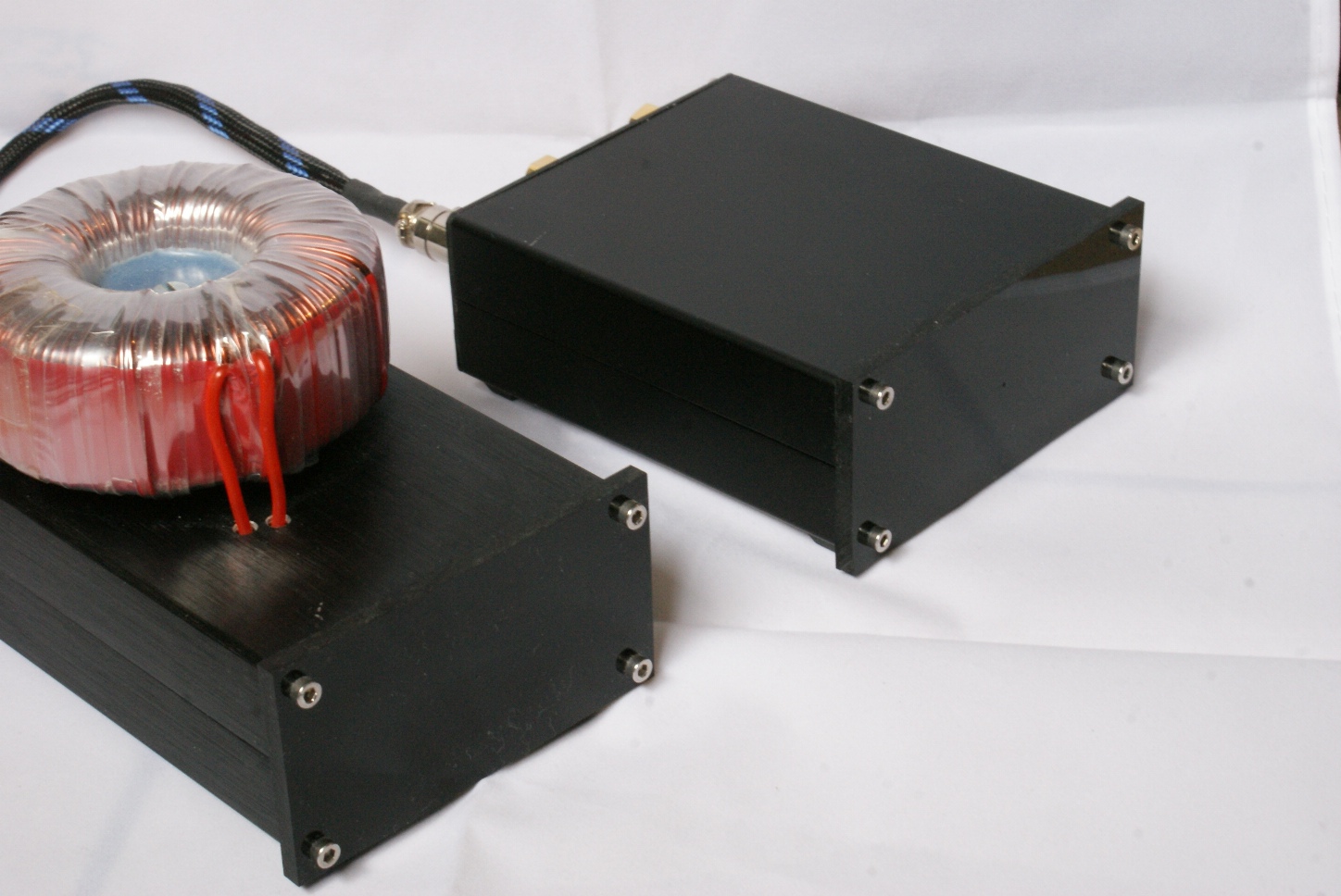

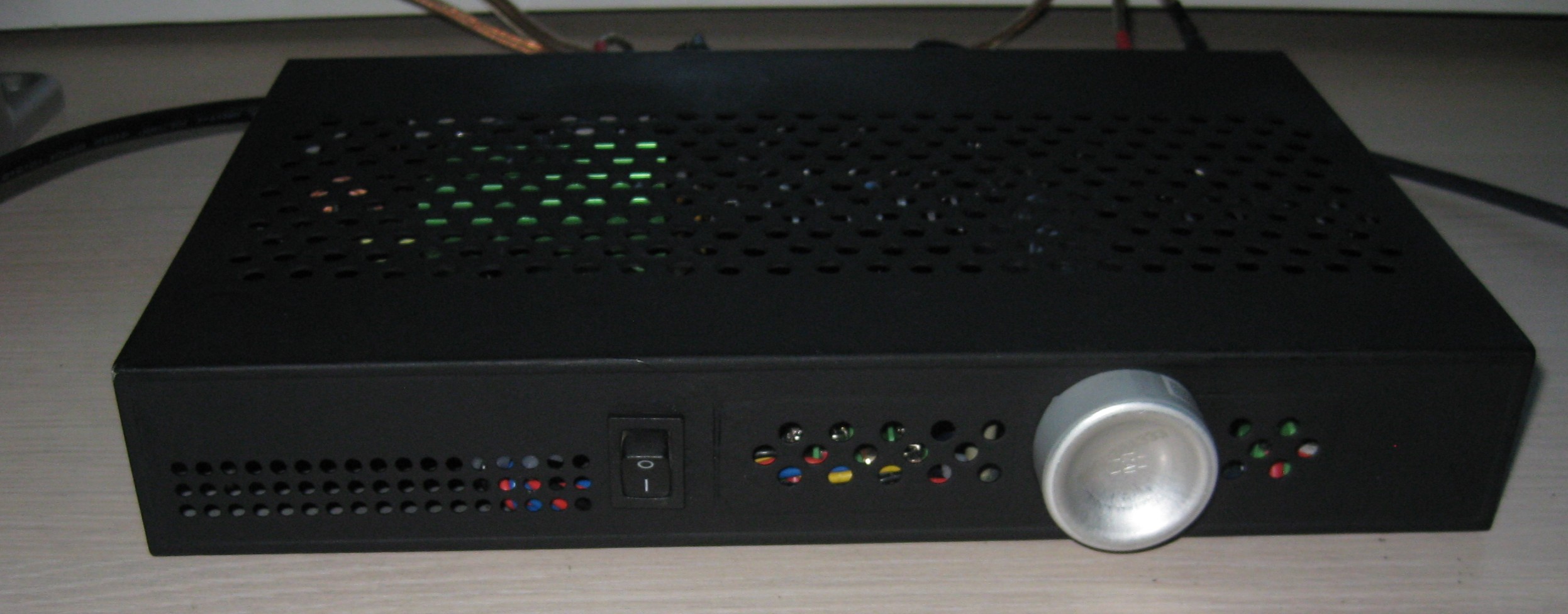

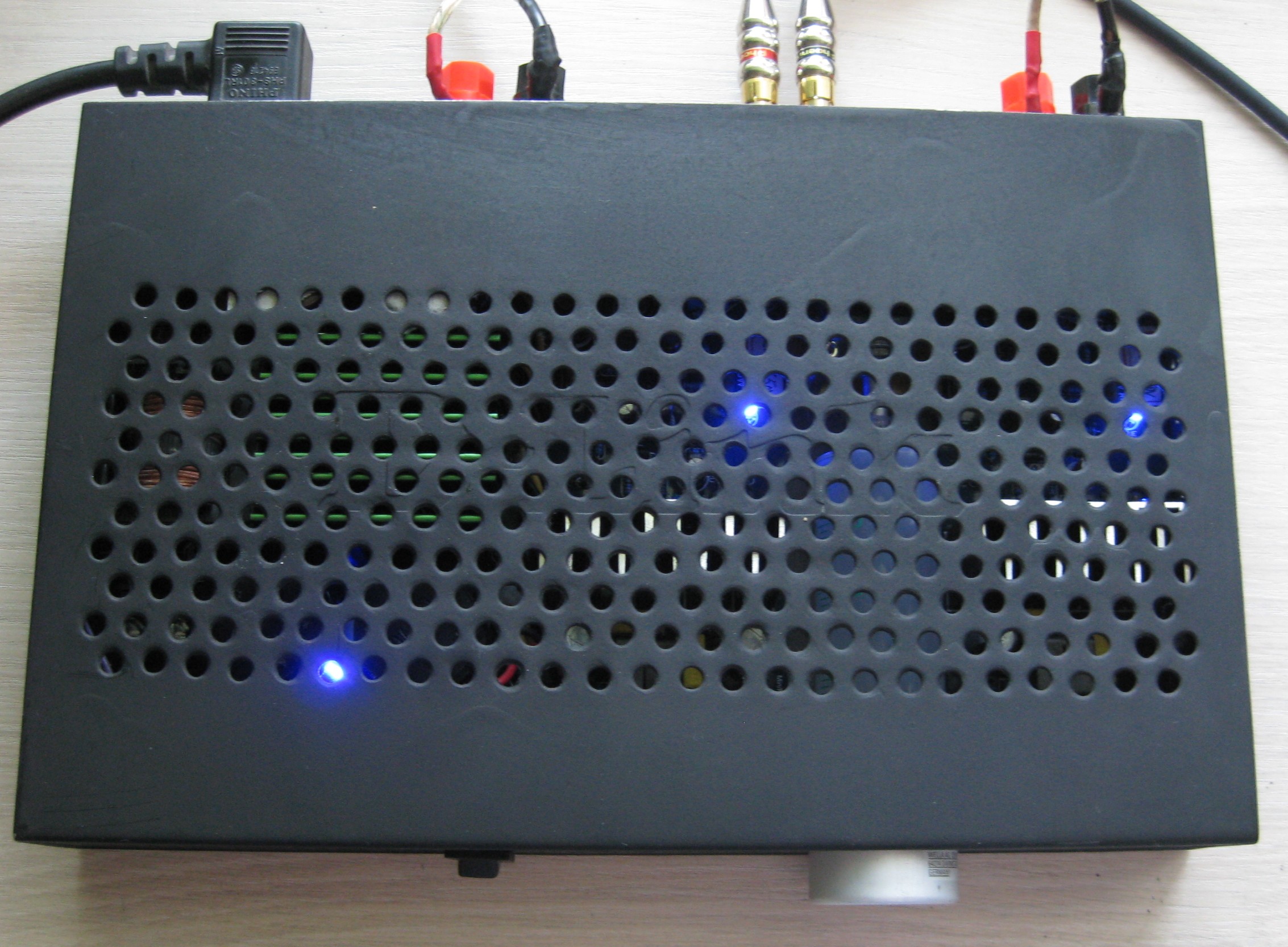

Interesting design! Is that safe having such a thin layer between the transformer coils and the outside world? It looks like you don't have mains earth connected?
The amp is sitting in a very safe place so no worries about that thin layer. Acctually it can withstand quite big force. I still need to connect mains ground, though I am not having any problems without it.
BR,
Ales

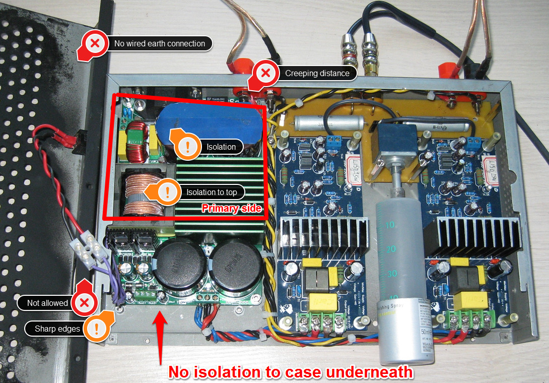

just became aware of this thread, especially #892.

And now, take a second look at this class-D-from-hell and think about safety regulations again 🙄
jauu
Calvin
ps. the sound could well become a short dry ´Poof´.
Calvin, is there something in korzhuk's design that particularly worries you? Yes, it's a very vented case, and I'm not sure whether there's a safety earth connected. But the photos look ok to me and a lot better / safer than some other designs I've seen.
all of the above and maybe more ..
- RCA connectors insulated?
- metallic Poti shaft to knob?
- double insulation?
We all appreciate young enterprising man, building something on their own. 😉
And most deserve the praise in full rightness.
Unfortunately not every build complies with the most basic safety rules.
But there will always be at least one dumbo around aahing and oohing about audiophool parts and weirdo-devices-from-another-planet, but failing to recognize the gross disrespect of necessary (safety) basics.
Built-in ´planned obsolescence´ of the user is nothing I´d like to rave about. 🙄
jauu
Calvin
Hi, everybody!
Thank you very much for your attention and posts (Especially [besonders] Dr.Mord).
I will fix indicated problems.
At this point I added the insulation SMPS to case top&botom and the wire chassis to electrical earth connected.
To Calvin:
1) RCA connectors are insulated to case. Is it right?
2) Poti shaft don't have electric contact to knob. Is it right?
3) "class-D-from-hell" don't have Double insulation. It have (resulting your recommendation) Class I protection.
Mit freundlichen Grüßen,
korzhuk
