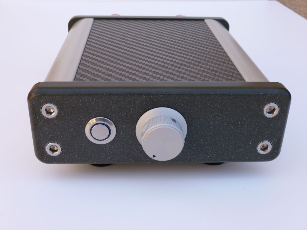

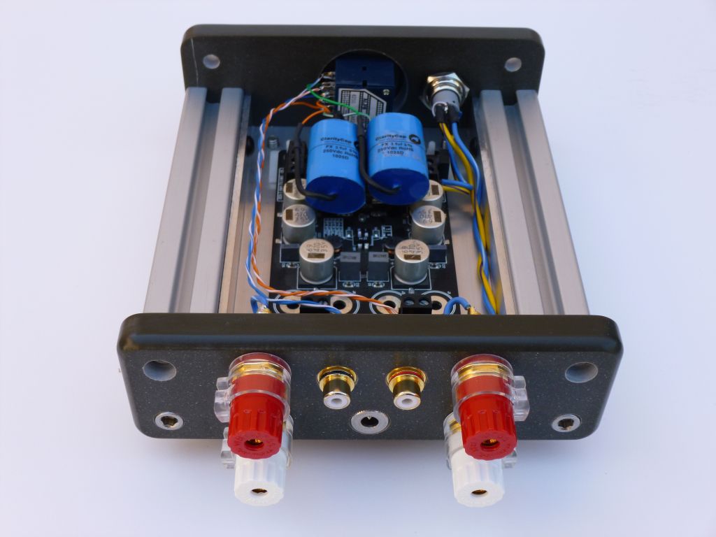

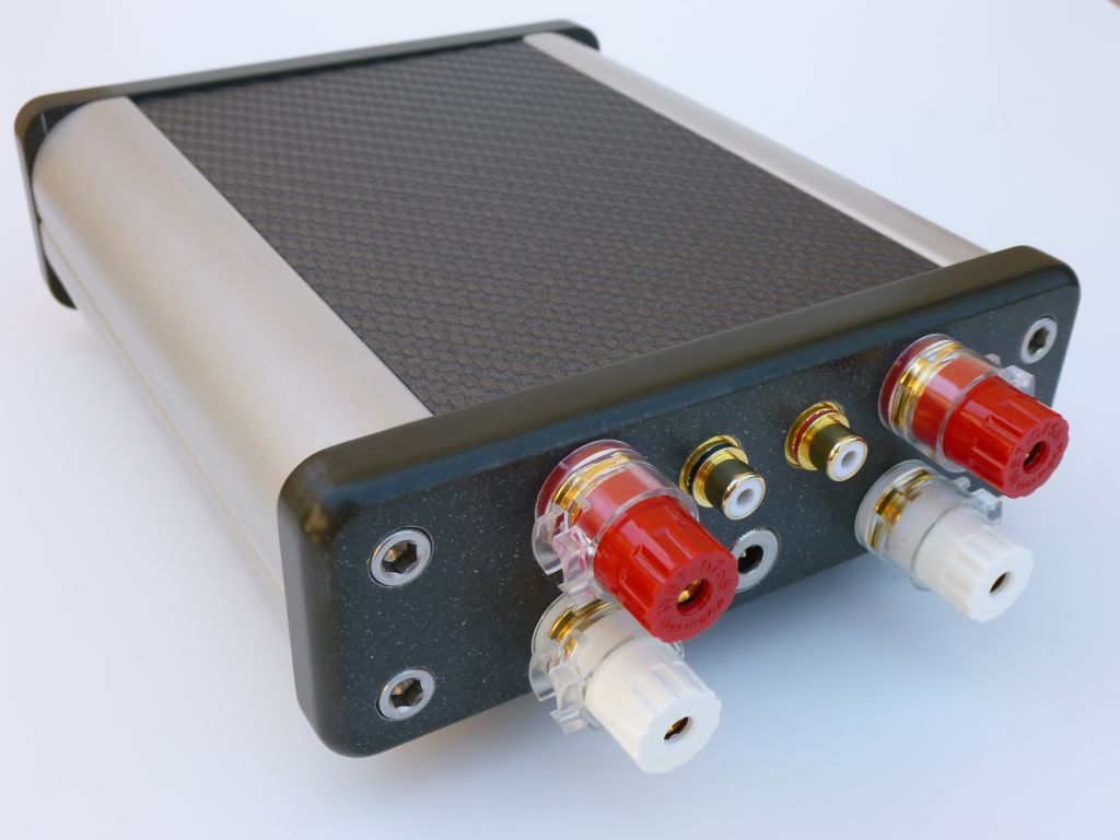

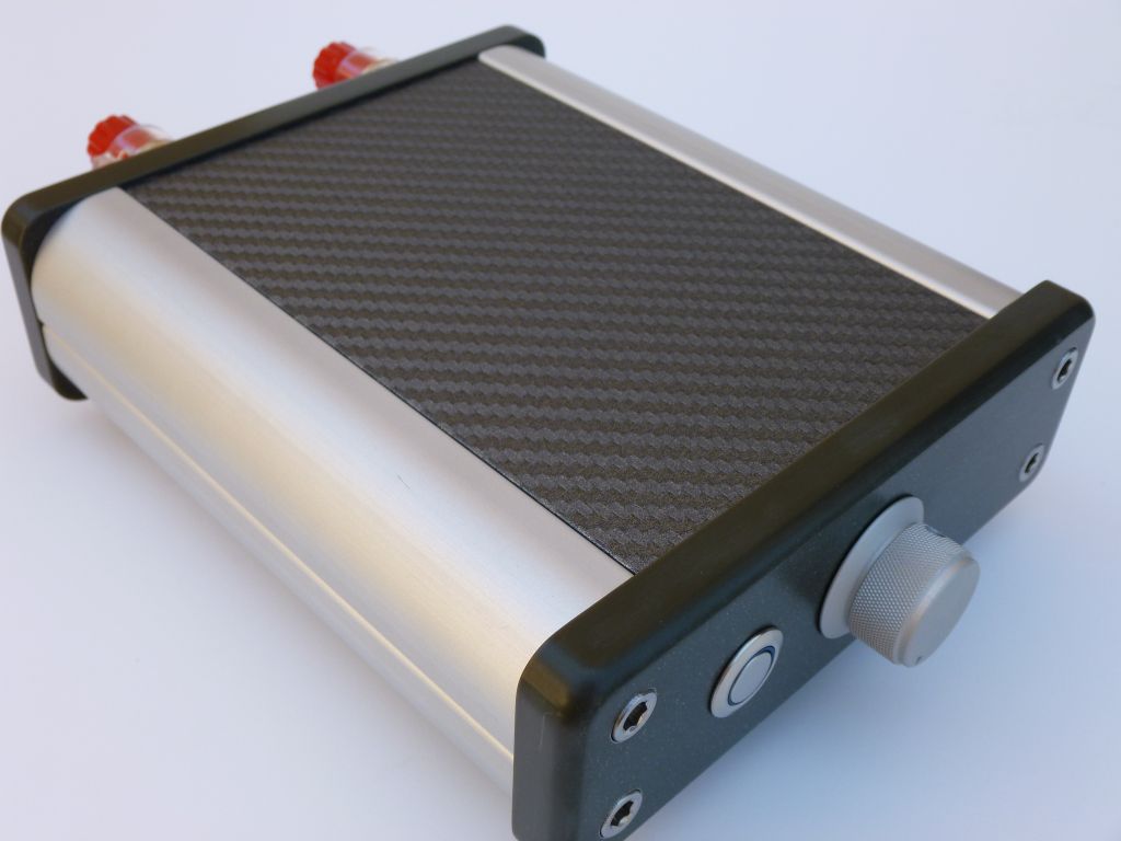

How much does one board with all components cost you? They're amazing, quality and aesthetic wise.
Wow! That looks very very good. And I have the same question as Lutkeveld.
Please check private message.
Is that a store bought amp? Looks like it the way the RCA jacks are connected. More info and lighter pictures please. 🙂An externally hosted image should be here but it was not working when we last tested it.
Nice!
Wich brand your speaker terminals?
Thanks. They are WBT that Parts Express sold years ago. I believe they were about $8 each back then. I wish I had bought more.

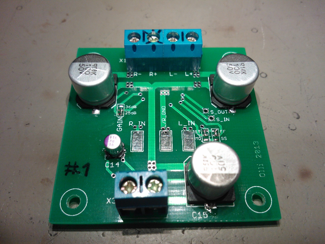

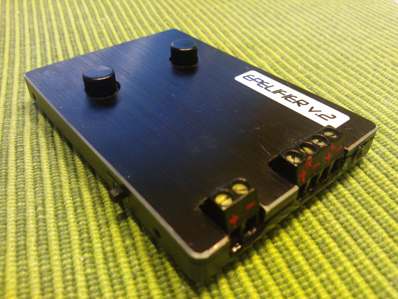

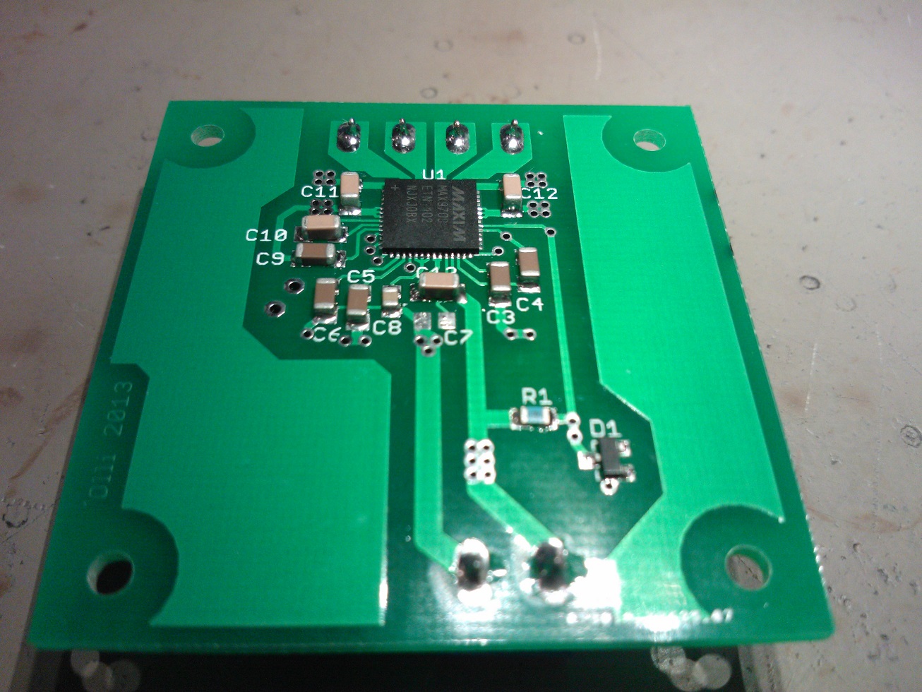

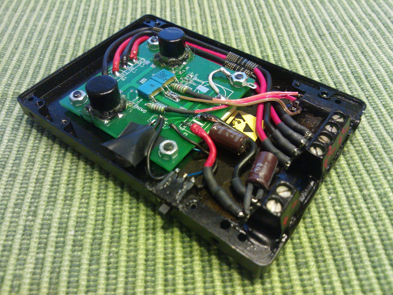

I can join to gallery with my mini amplifier. Made with same MAX9709 that doctormord use.
Case isn't so beautifully from inside, but I like the finished case (which is from broken SSD).

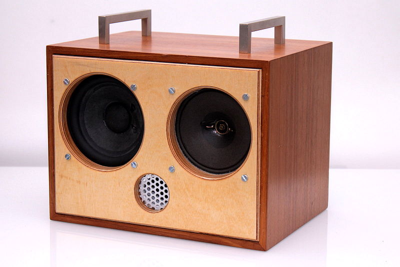

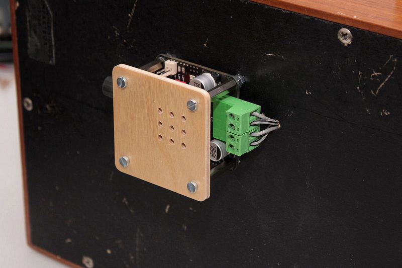

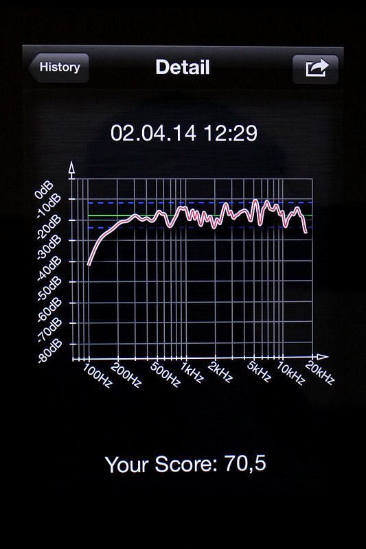

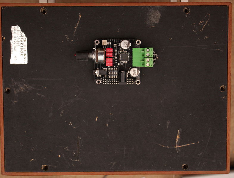

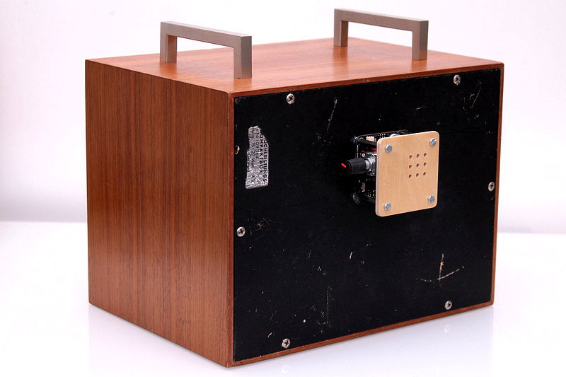

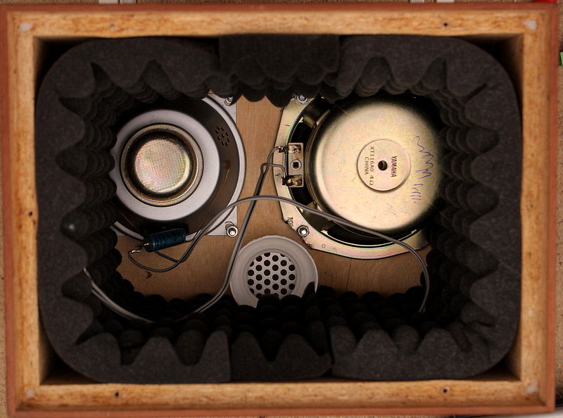

50W portable audio aka "Mr.Curious".
Amp: MAX9709 Module
Lautsprecher:
- Yamaha Basschassis 4Ohm "long stroke" (data)
- Isophon Mid/High 4 Ohm (no data)
Crossover:
- Capacitor 10uF (~4kHz)
Sound is crystal clear with good ground support. (for its size)
Amp: MAX9709 Module
Lautsprecher:
Crossover:

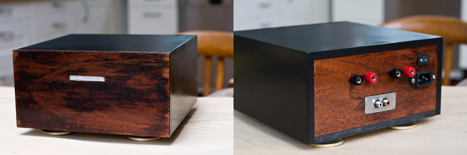

My little Sure 15W Amp running with two Denon SCF-107 at my desk.
The sound is so lala and i have to erase a high frequency noise from the ps capacitors (a 6A Laptop PS).
Maybe I`m going to change it through a 3116D2, enough space should be in the case.
The case is made auf stained, american hazelnut veneer.
The front "lighteye" is going to get a front panel out of metal that you cannot see the crappy extract, like on the back for the RCA In.
