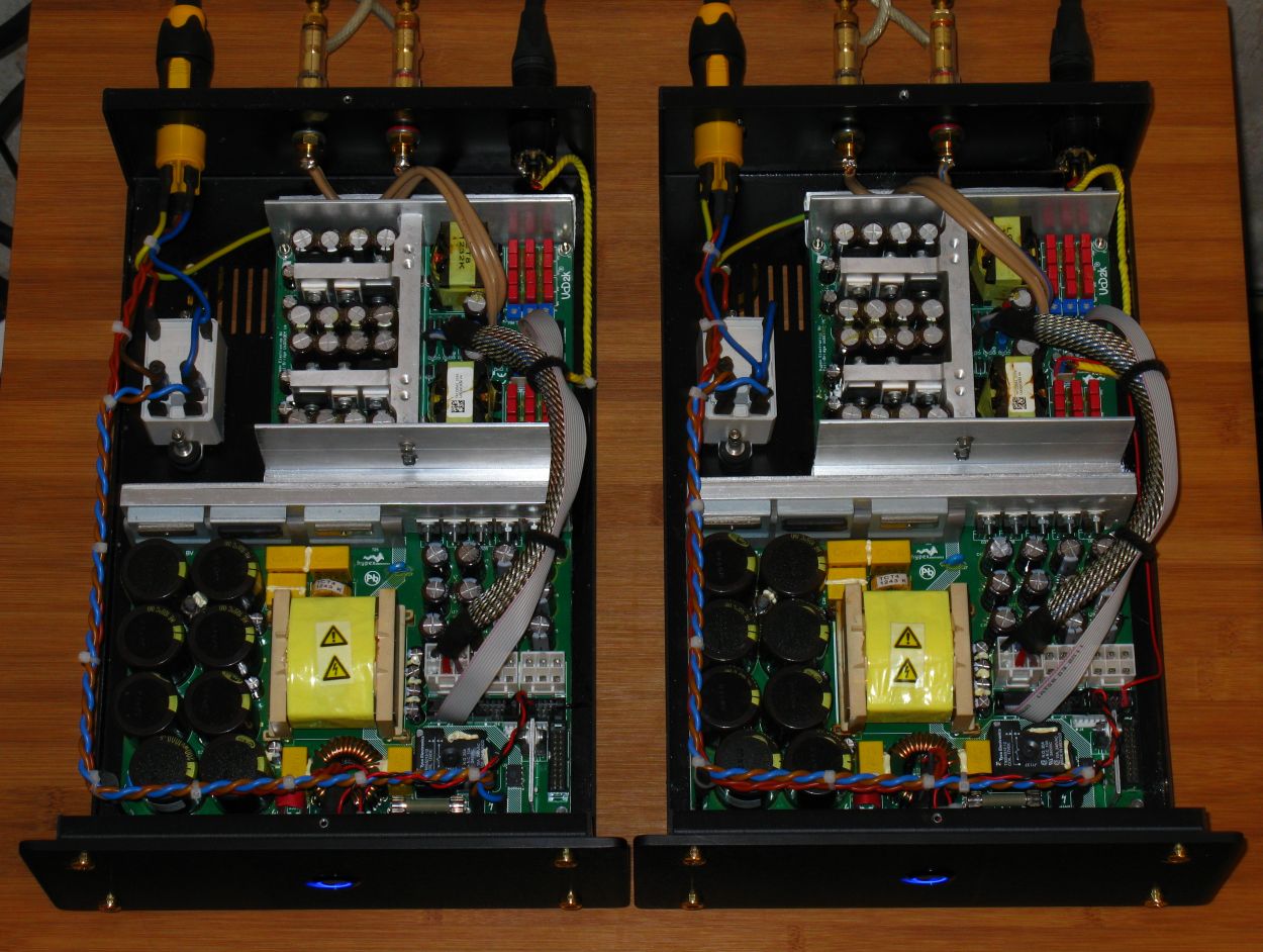

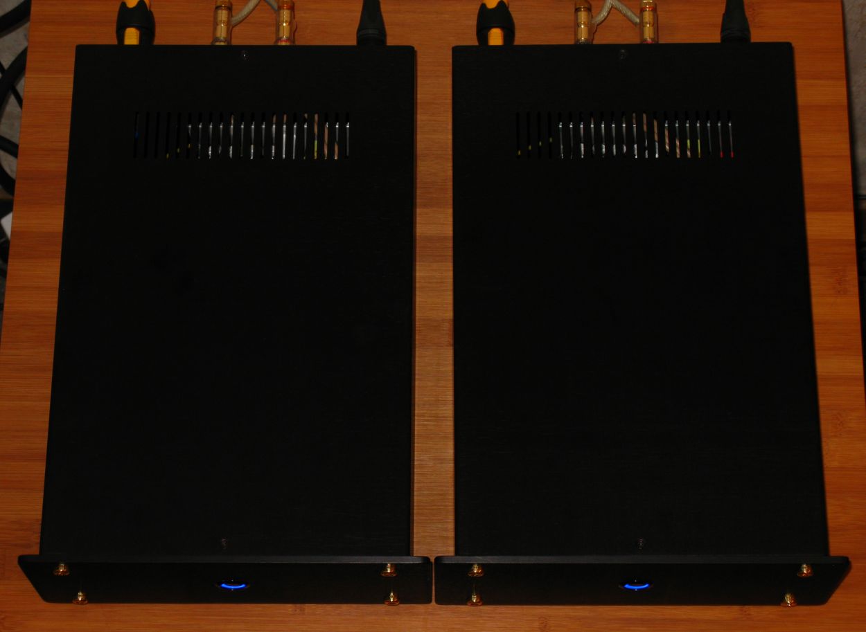

My attempt to make a clean build of dual UCD180HG :
Nice build quality and layout, although the mains passing through a hole in a metal plate, with rough edges, gives me concern.
I know, I still find a way to find rubber/plastic material to cover that hole. Fortunately the outer jacket of that OLFlex mains cable is thick enough and it is double insulated cable, so it is safe enough for the moment.
Very nicely done. I like the clean and open layout of the inside. How do those Hypex modules sound? I've been lurking around the Hypex thread from time to time, but haven't popped for them yet. Too many other projects and personal drama right now. 🙂 Do you have other class D amps you can compare it to? Oh, nice pictures too!

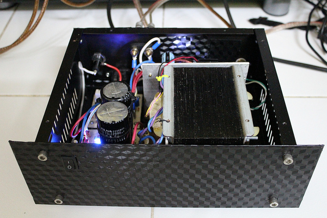

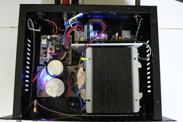

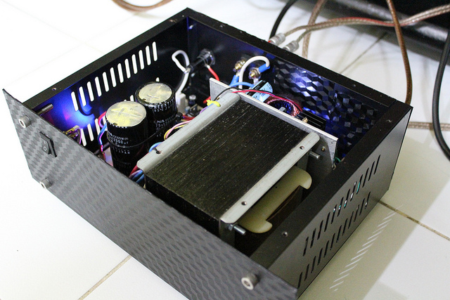

My Class-D subwoofer amplifier housed in a small case.
Using +-65VDC rails with 500VA transformer. I conducted sine wave power measurement and the results were 306W into 4 ohms, and 490W at 2 ohms resistive load (clean sine wave before clipping).
Power supply rails sagged from its original +-65DC to only +-51VDC when drawing 490W.
