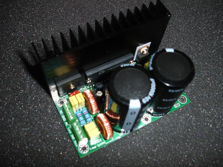

Actually, this is the TK2050 module from HiFimeDIY I have. It's been on my bench, wired up and tested, but hasn't found a permanent enclosure, or home yet. Thinking about making a little iPod amp for my daughter with it. Can't beat the price. 🙂 See attached image below.

Thanks Rick. Actually I have his T4 amp sitting and not built up yet. When I finally go active on our 3 front 104 db efficient speakers I'm going to need more amps. So trying to get a feel for which way to go.

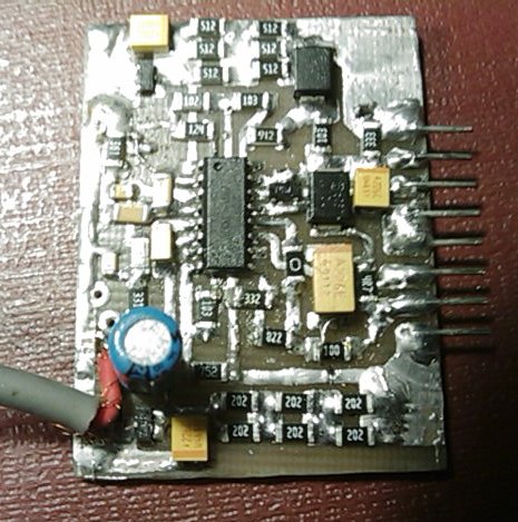

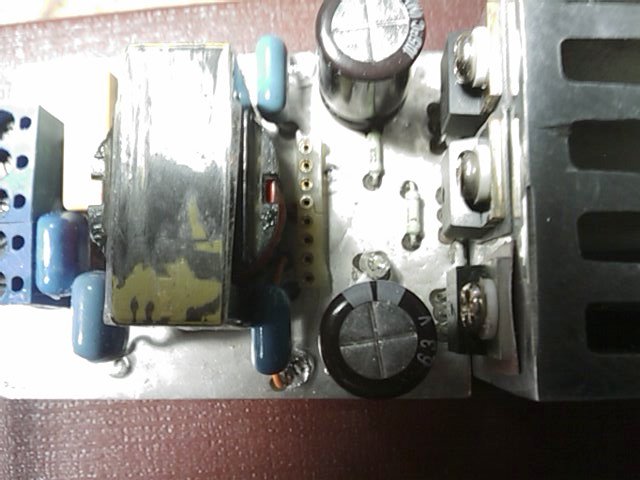

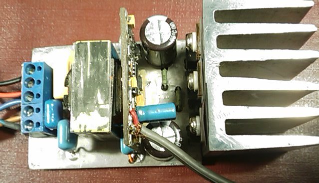

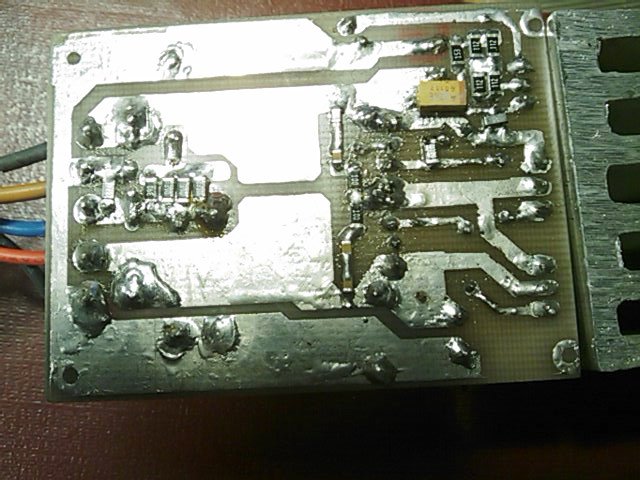

This is my own version of IRS900, enjoy, it's working perfectly!
For some reason, it appears your images did not come through.This is my own version of IRS900, enjoy, it's working perfectly!

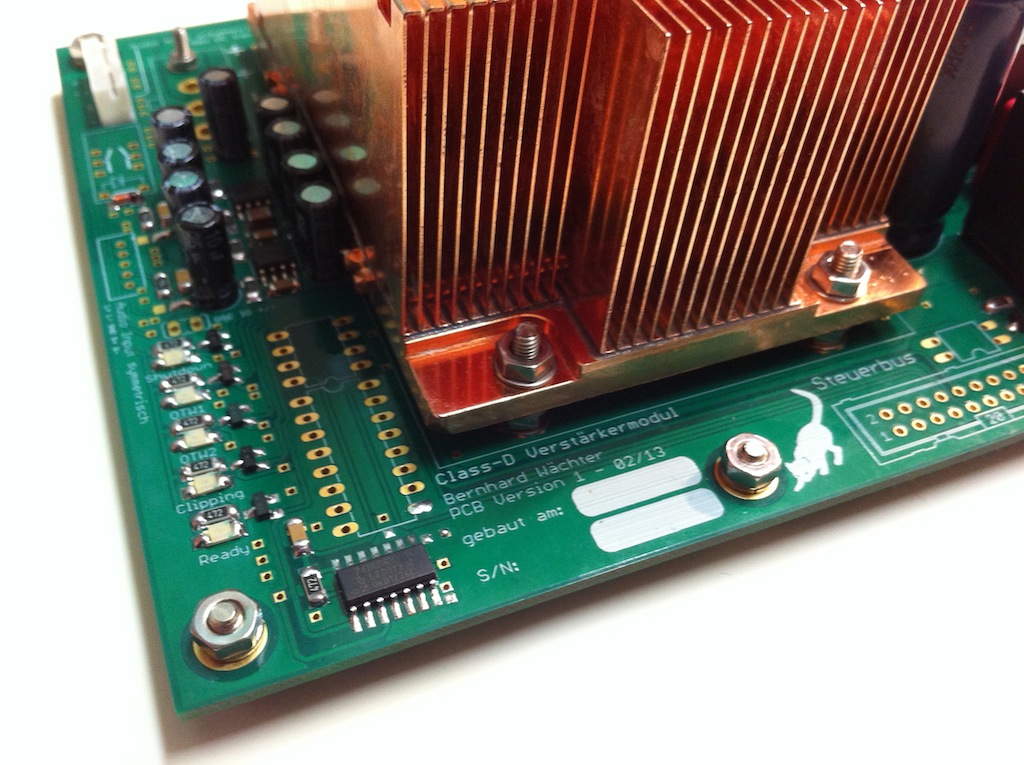

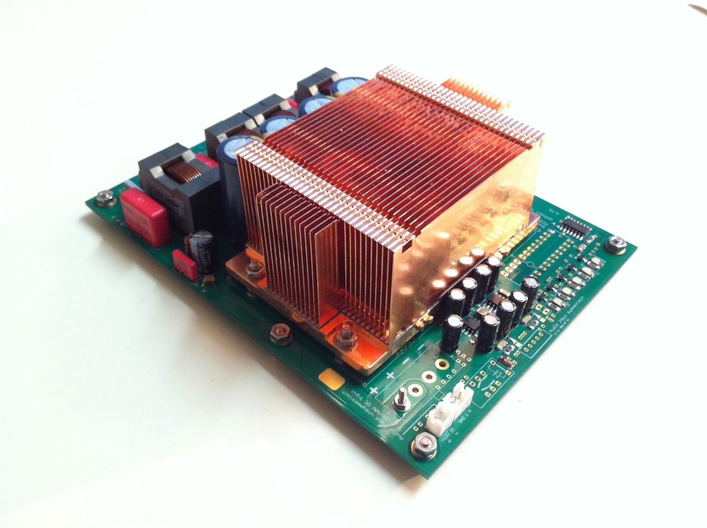

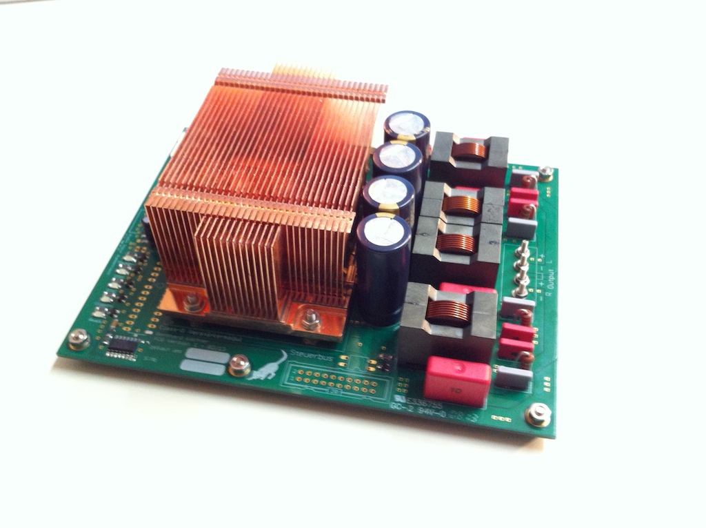

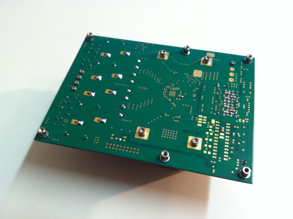

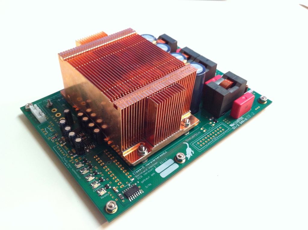

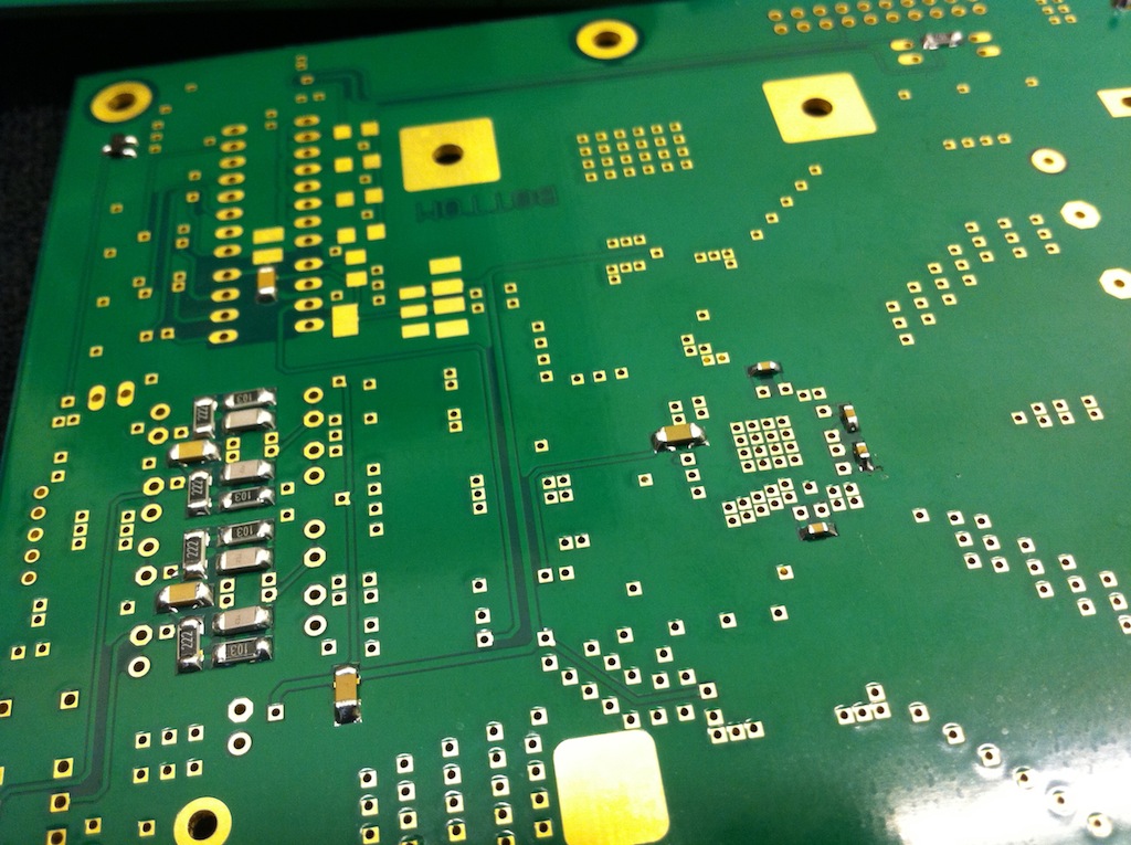

My TAS5630B Amp

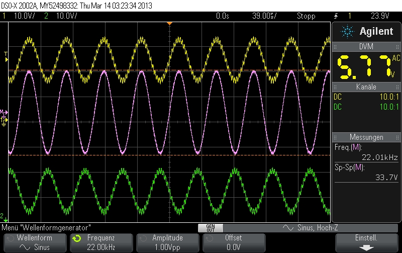

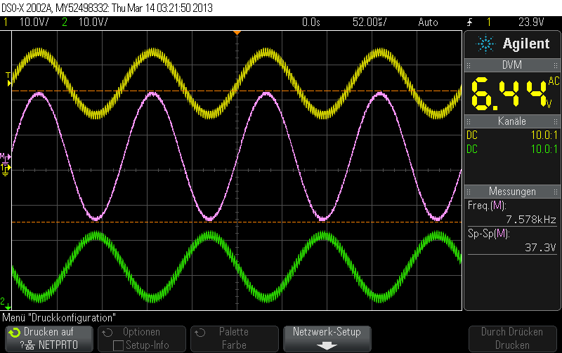

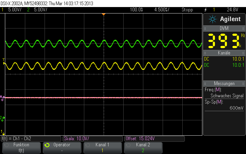

Hello! Here're some pictures of my Tas5630b Class D Amp (the first one I designed). It works really great, I love this amp module.
Power is about 170W @ 4 Ohms each Channel. Heatsink is a Pentium 4 Socket 423.
Inductors are Coilcraft VER2923 with 6,8µH. I will try 10µH also.
Btw: If someone is interessted in a pcb, contact me ;-)
Best regards,
Bernhard
Best regards,
Bernhard

Thanks for your great feedback, Sound is good but I have to say that I'm not a sound guru so I connect the amp to the speakers and it sounds good with no strange noises or something else. I'm happy at this point! 🙂
I read the pm and will reply soon with some more details about the pcb.
Very impressive
Nothing more to say that WOW that is some really impressive work
