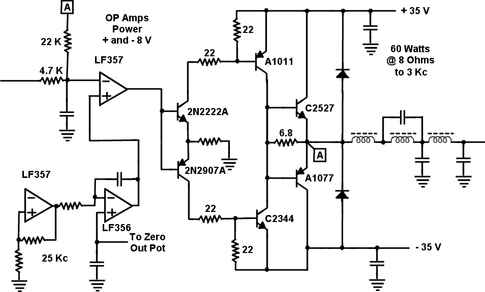

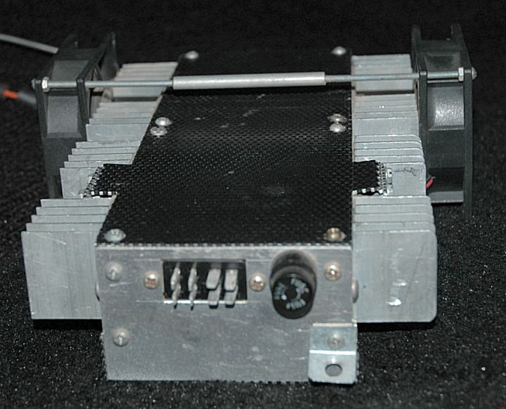

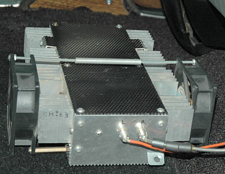

Really Old Class D Amp
I built this thing around 20 years ago. It still works. I just thought maybe somebody would be interested in an Old School design. FETs at the time I couldn't get to work right, so all is bipolar transistors and J-Fet Op Amps. Power supply does have 2 of those TO-3 BUZ things driven by a transformer. It is for Bass at cutoff of 500 Cy, but is actually good to 3 Kc. 60 watts a channel. I use it to drive a pair of Eminence 18 inch woofers in my 57 Chevy.

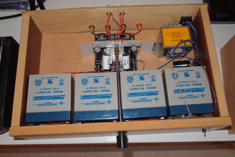

Class D runs on 24V Battery

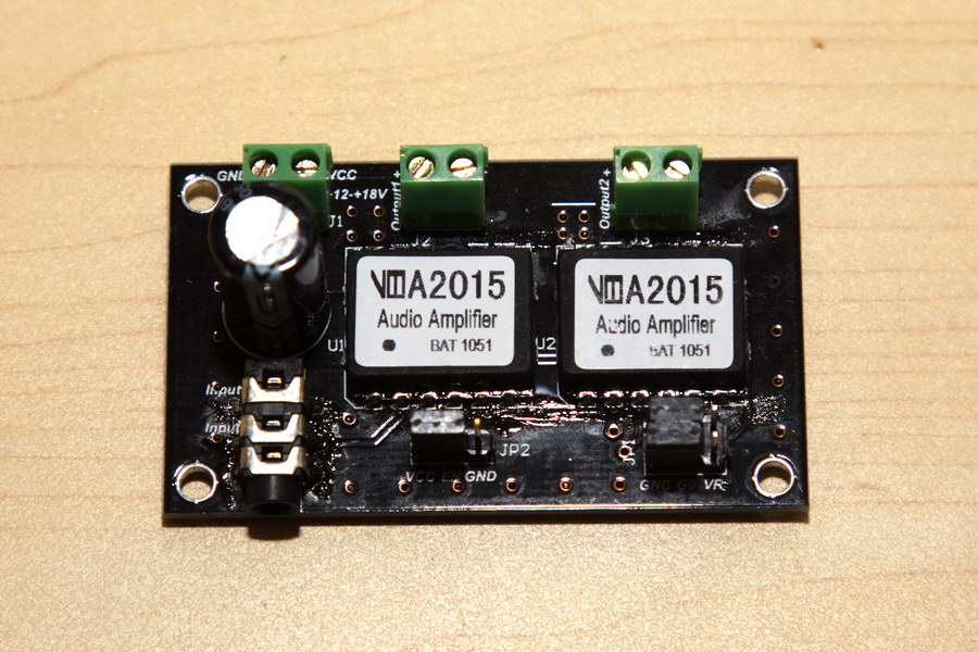

This is my version of Class D based on Sure Electronics 50 watter, runs on TP2050 chipset.
It runs on 4*12V batteries connected 2 in series and parallel to give me 24Vdc.

They look massive, but only in size. I removed the 10000uF electrolytic caps and replaced with 35uF film and oil ASC caps. I experimented with different caps on a Hifimediy T2 and liked the sound with the film caps. And you are correct, caps not needed with the SMPS but I wanted to keep the relay in place so I used this option.

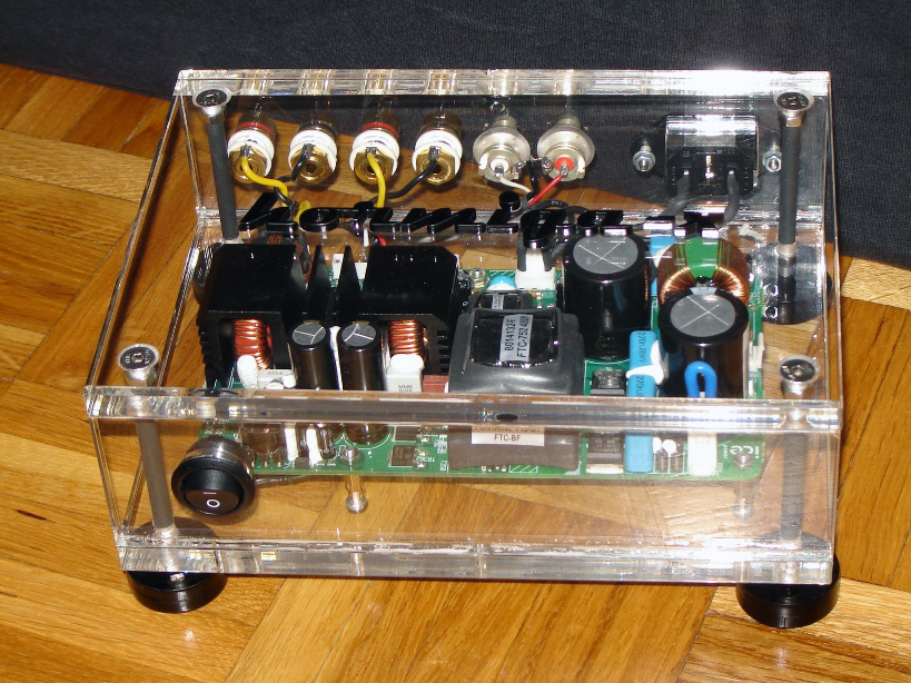

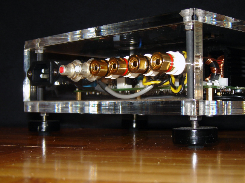

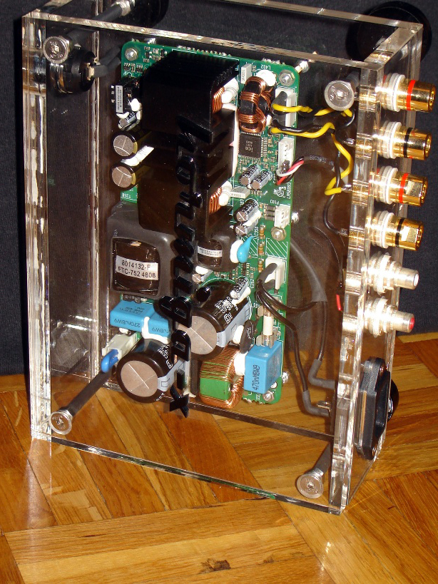

ICEpower 125asx2
This is the way I implemented 125asx2 power module into the housing. It is made out of perspex, on the sides it is opened so that the module doesn't get baked.
BR,
Ales
