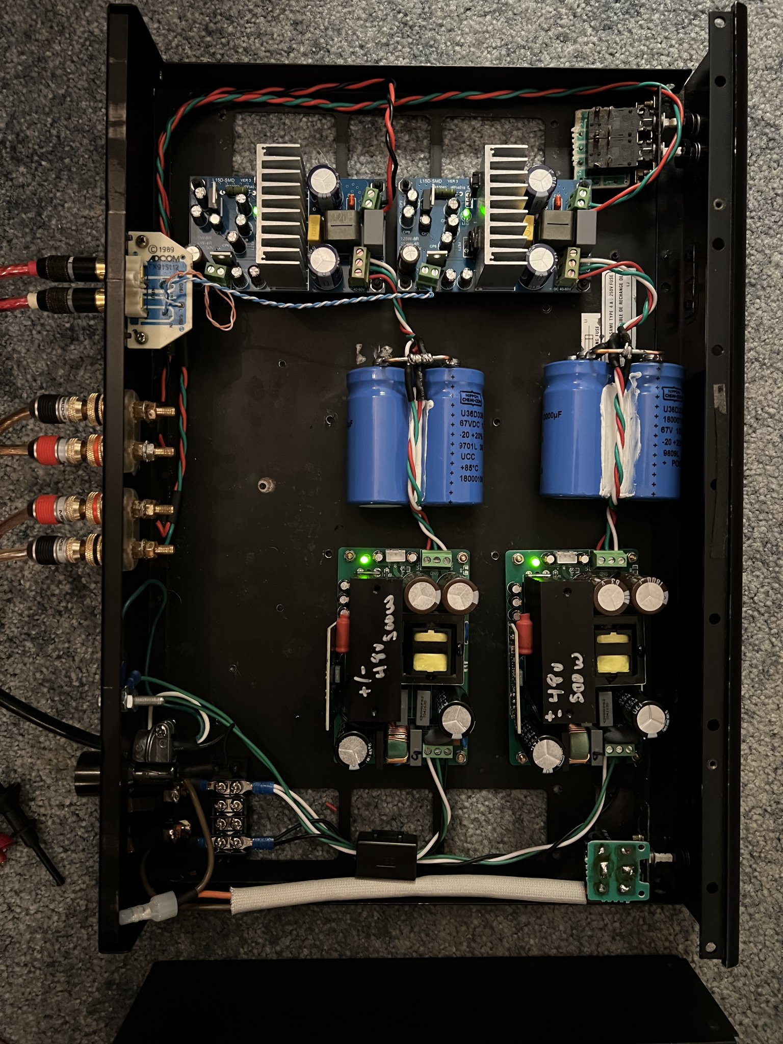

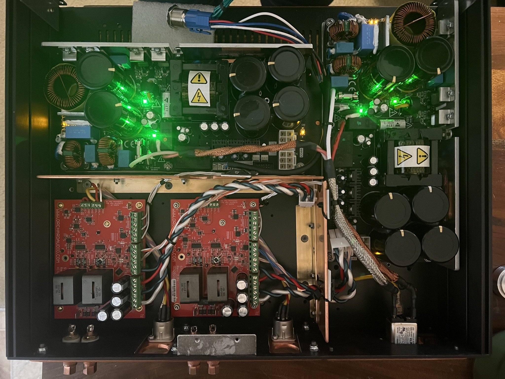

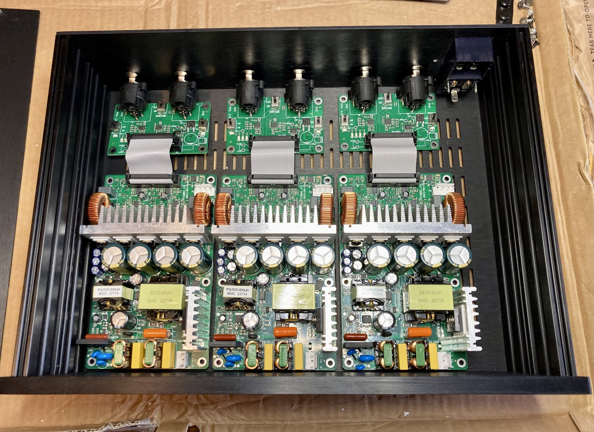

Dry fit for pending 6-channel amp… Just might work in the Galaxy 2U 330x230. :smash:

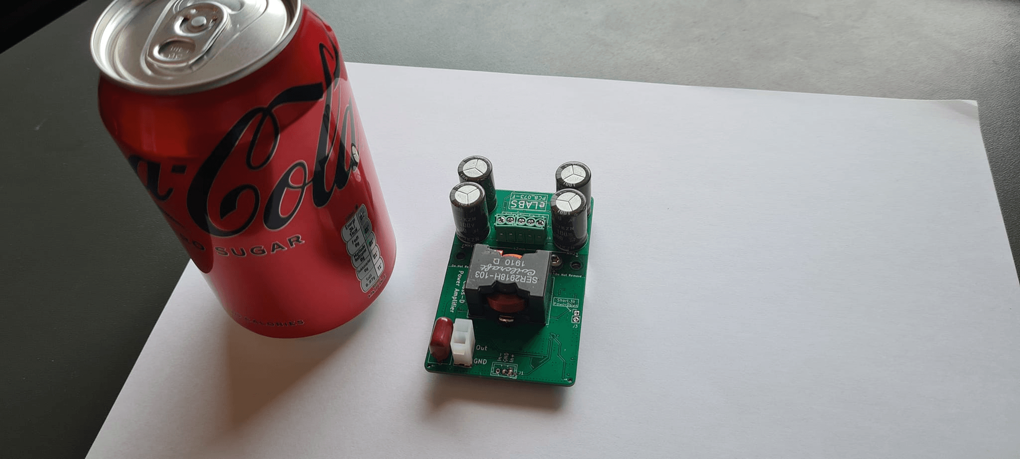

## Our 1 channel amplifier module. PCB size is 50x80mm.

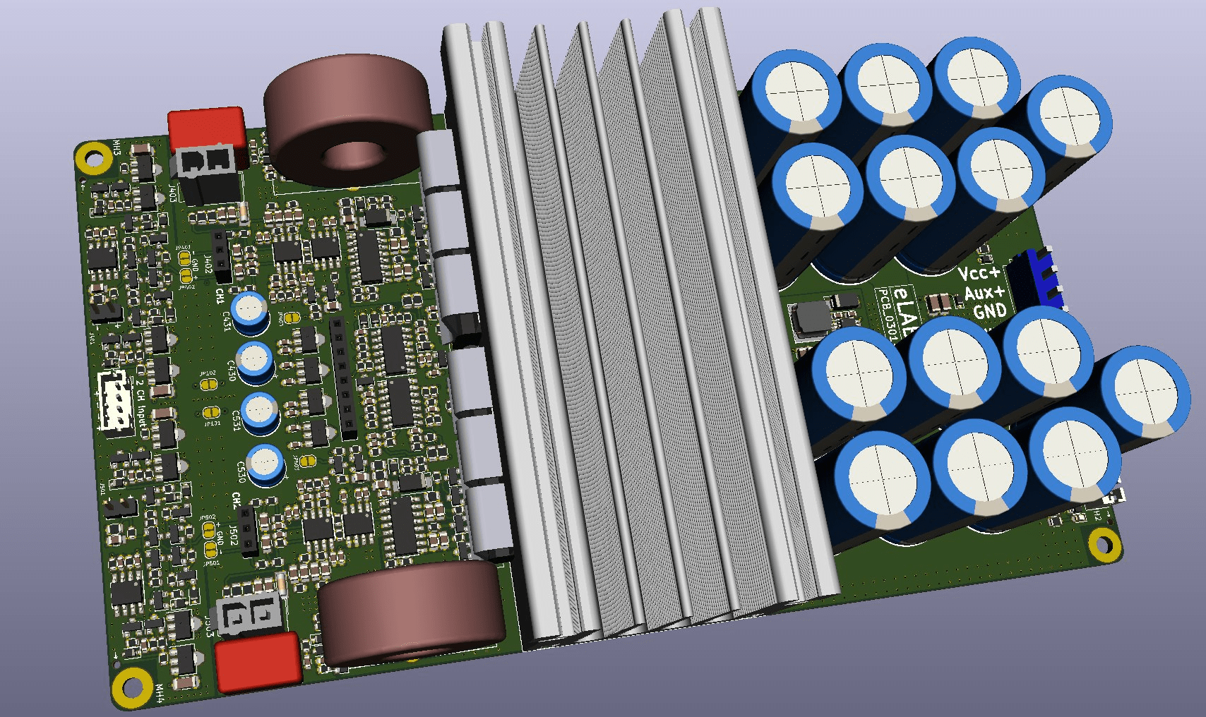

## Our 2 channel amplifier with onboard class-A non-feedback input buffer and 14.000uF de-coupling capacity.

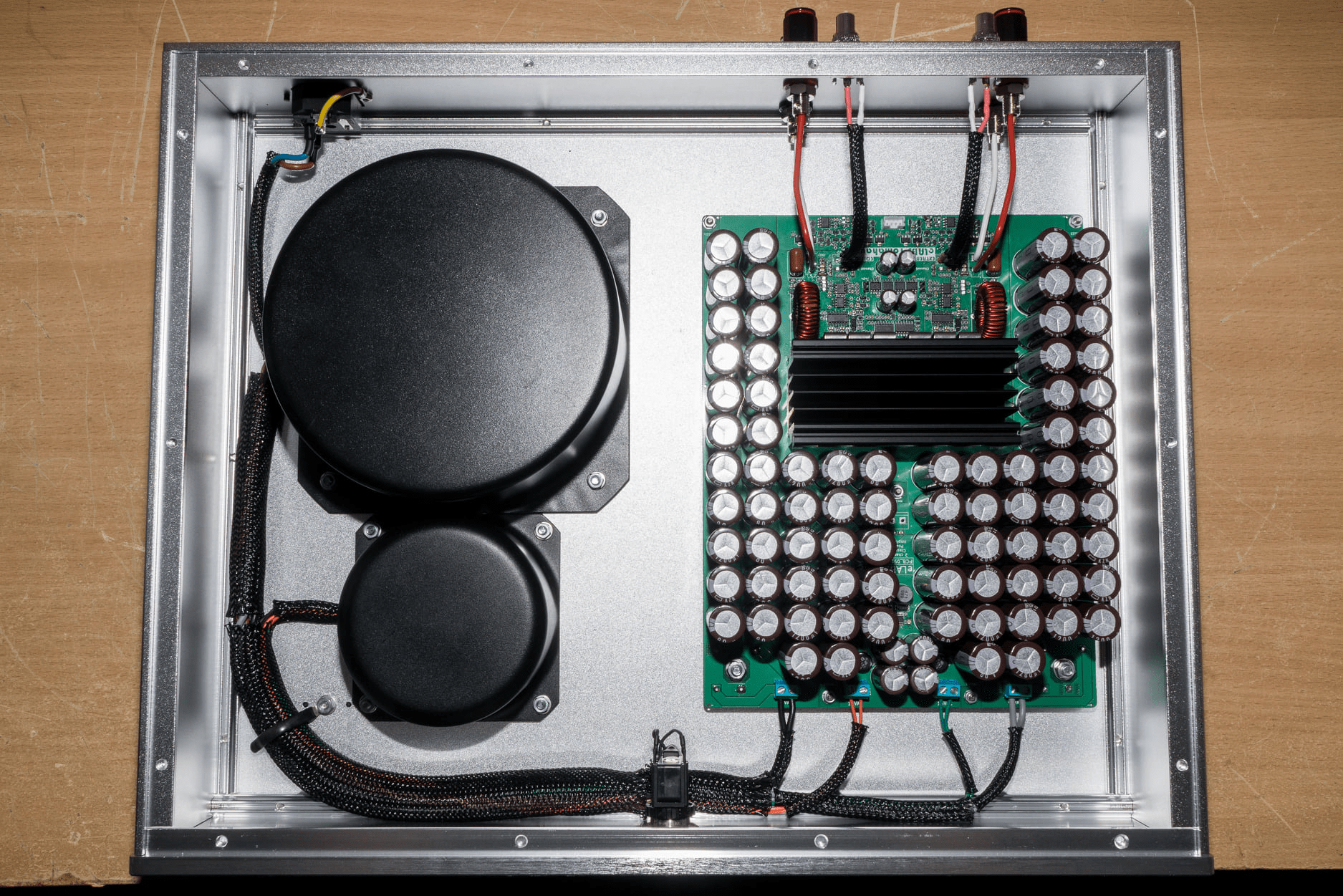

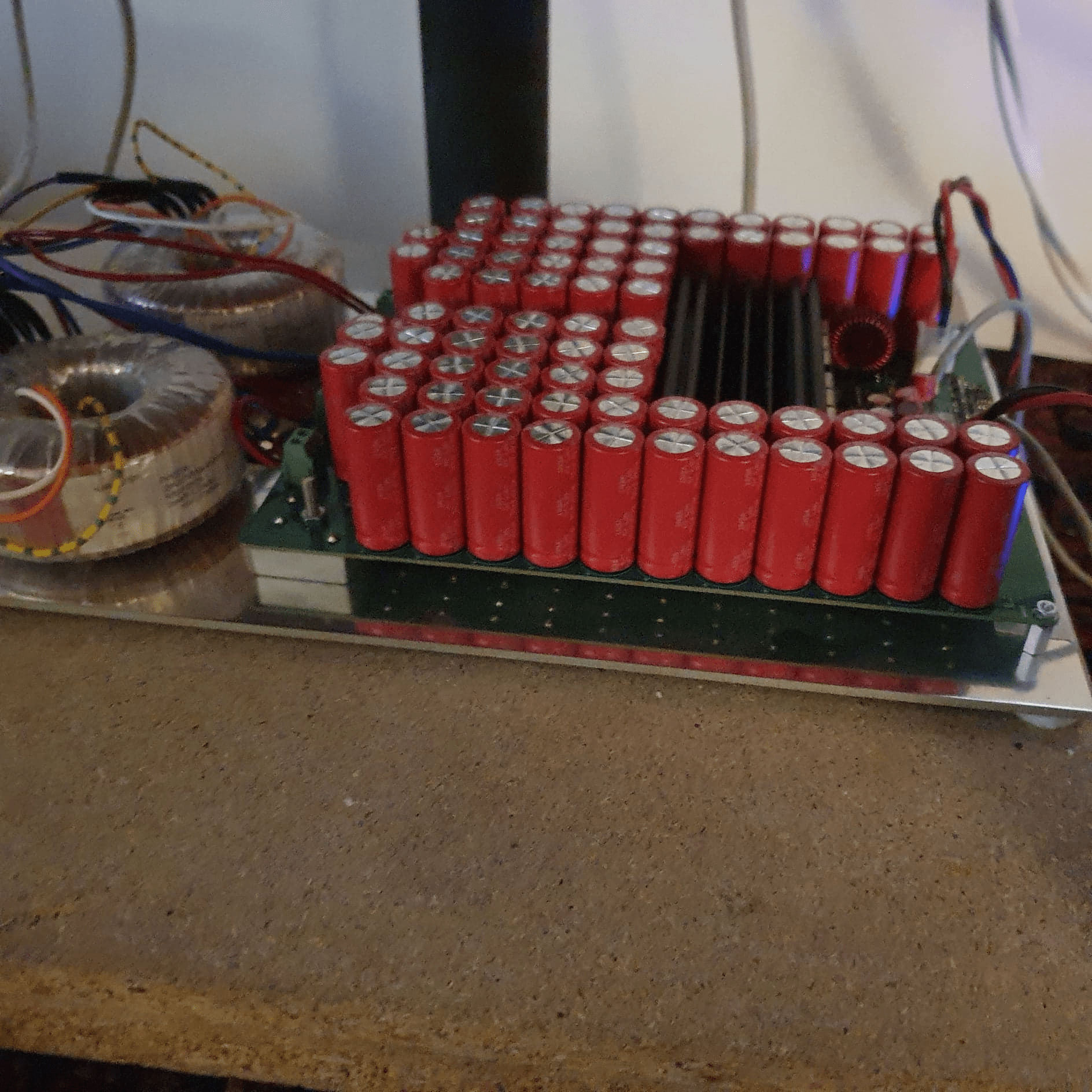

## Our 2 channel amplifier with onboard class-A non-feedback input buffer and approx 100.000uF ULTRA LOW ESR capacity. This board need 2x40VAC (main transformer) and 2x15VAC (AUX transformer) to run, since rectification is onboard. This is our best module.

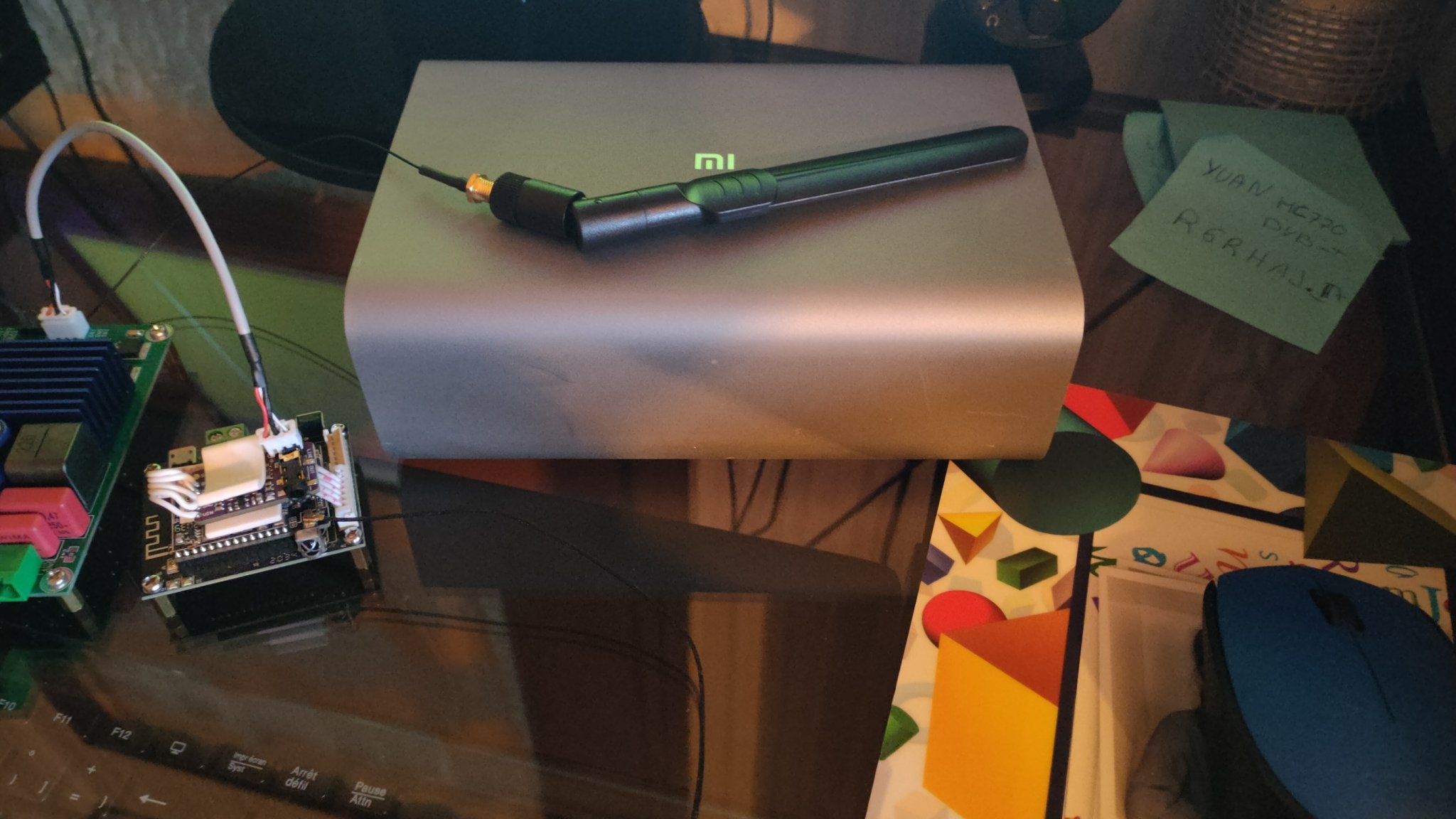

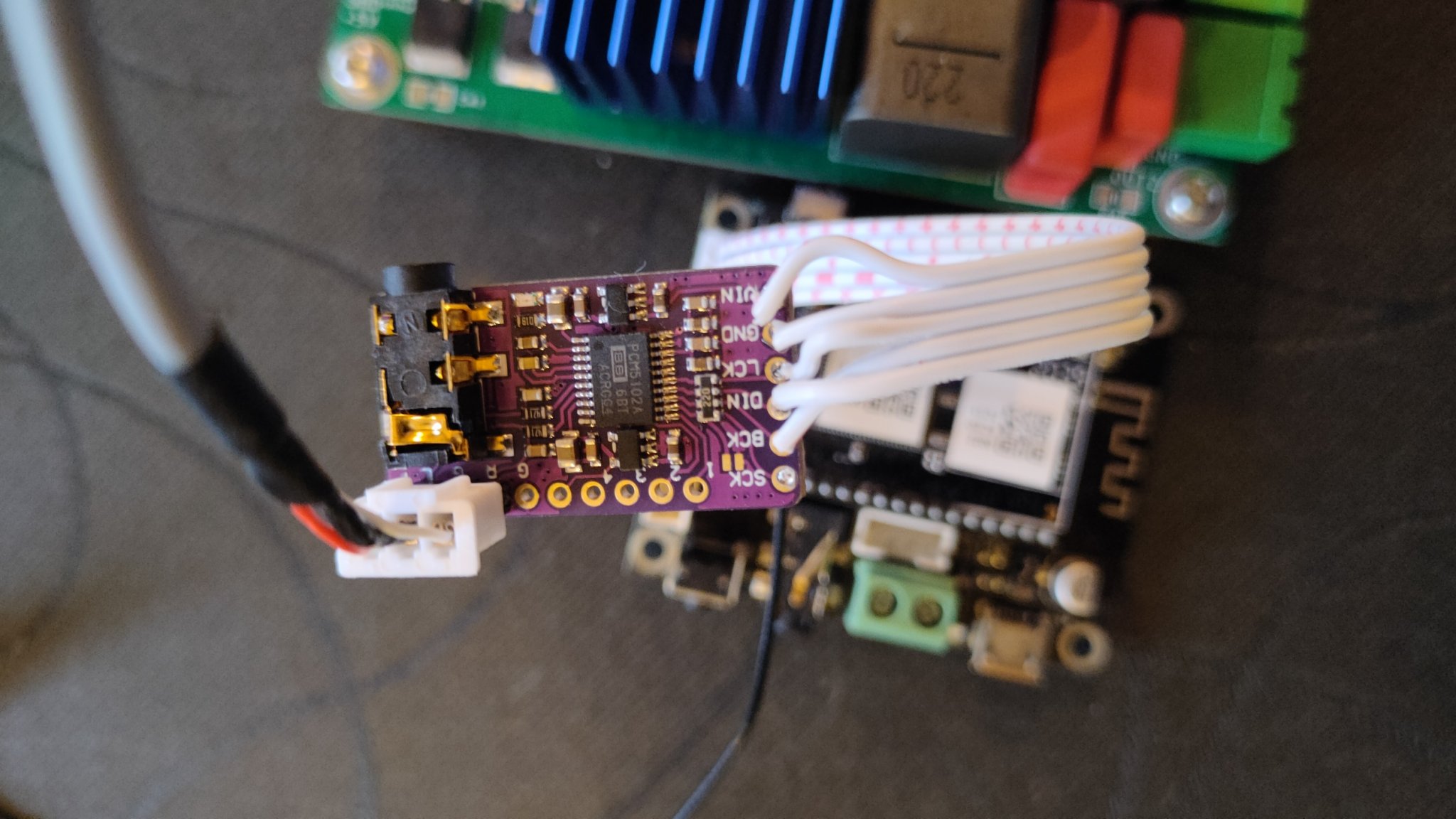

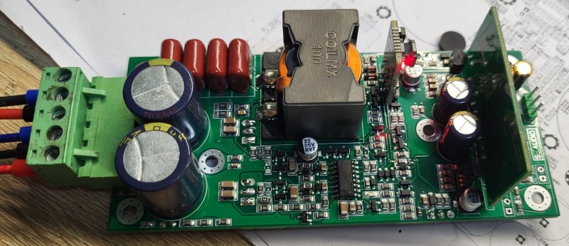

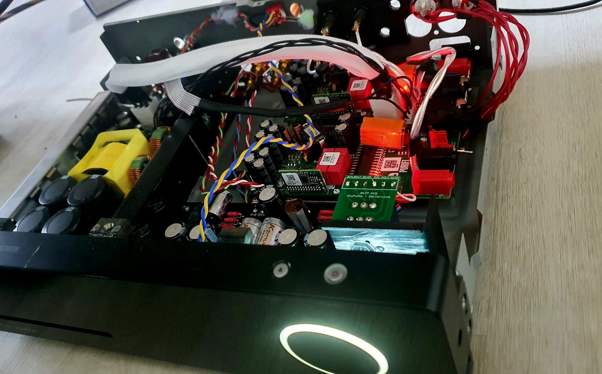

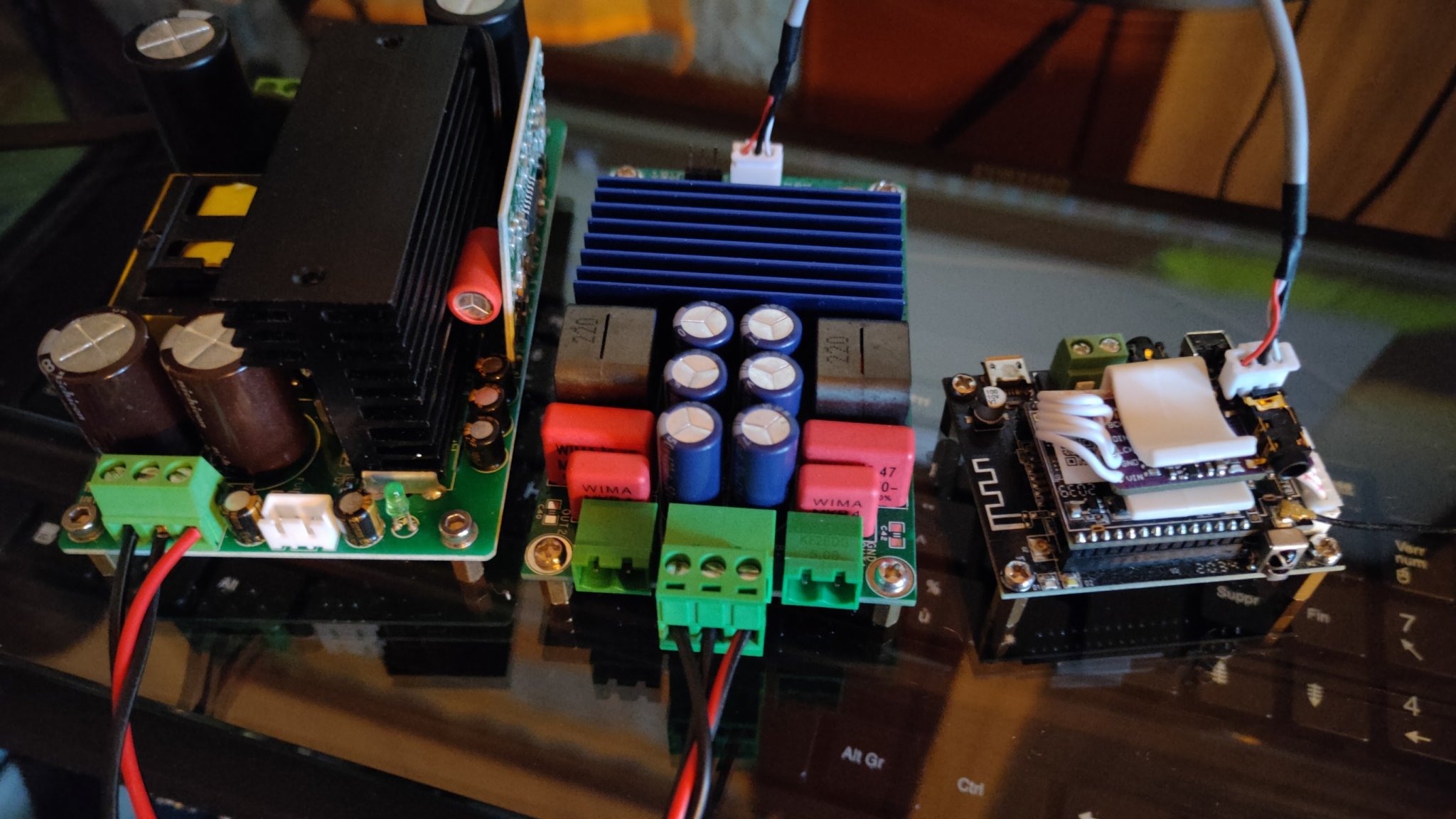

Hi!
Here are the combined elements of my holiday DIY.
arylic up2stream mini whith I2S dac PCM5102A.
MMA5332 amp.
I'm going to try to integrate everything in the case of an old aluminum Xiami router...
I have already tested all the elements together.
The i2s dac added on the arylic module and the MA5332 board.
a real killer!
High-end connected amplifier!
Total silence between change of title, power!!!
For sound settings, equalization, source, I go through the up4stream application.
The hardest part remains to be done...Integration in the case... :eek::smash:
