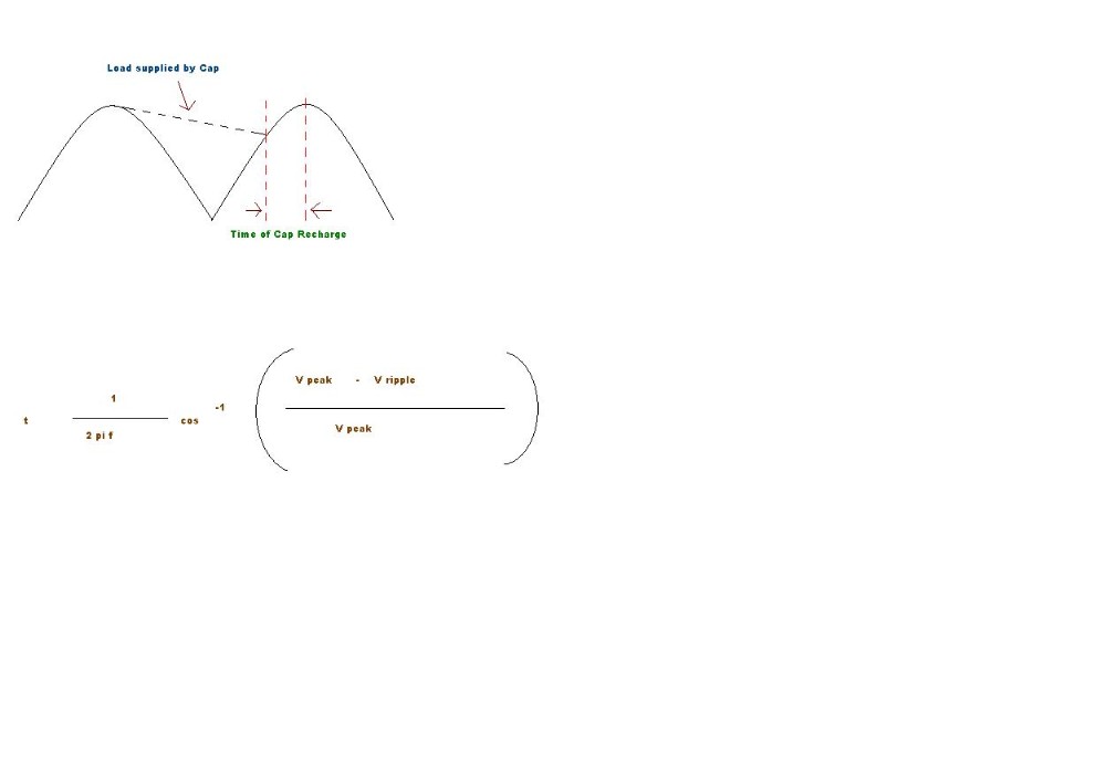

Thanks, though i havent really been given an answer.........DonPetru's kind answer was about transformer rectifier/capacitor power supplies.....not an smps.
