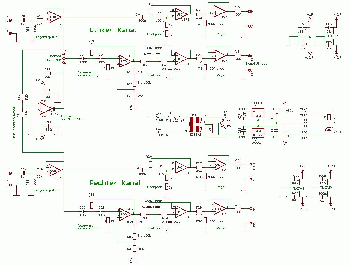

Plopp when switching off
Hello there.
i made some progress.
The liteamps are powering the Woofers, and i put all the electronics in an old Tuner chassis.
I got rid of some ground loop problems, which took me a while, there is only one problem left:
A plopp sound when switching off.
now i wonder what exactly causes it?
in my layout is a LDR volume control, followed by an active Xover (from a german forum) i can attach the circuit here.
the outputs are wired up to the liteamp.
When i short the output of the volume controler it still plopps when turning off,
when i short the output of the X-over the problem is gone but what exacly is causing it?😕
any ideas?
Thanks!

...if it is still of concern...
Most likely the supply of your cross over is collapsing earlier than the output of the hypex supplies, which are feeding the LiteAmp.
When the supply of the cross over collapses, then the operating points of the OP amps are moving/bumping.
If this happens before the LiteAmp has deactivated its power stage, then this bumbing at the input of the LiteAmp will be
amplified like any audio signal.
So you should make sure either that all your DIY stages have their own antiplop mechanisms - or ensure a delayed turn off of their supplies.
