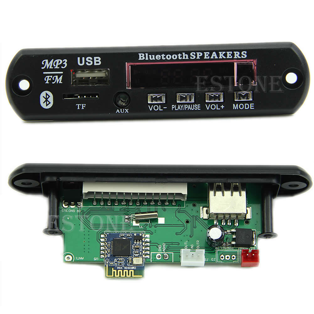

hello can u plz take photo of the mp3 module and show where to desolder?
i have the same problem and it will help me alot !
thanks
Hi idanha,
All my stuff is at the Garage/Workshop and only on Sunday I'll have a chance to take pictures, but, if you look at the one I'm attaching you might have a good idea of what you need to desolder.
If you have this same module, you'll have a hard time doing this since the solder is crappy and the board starts melting pretty fast, I would advise to be very patient, use a low temperature, use Rosin Flux and a Desoldering Pump (I think that's how it's called), it was the safest way I found without blowing my patience.
After further testing that I've done and since this seems to be of interest for some people, I think I understood why some sellers soldered the connection.
IF you don't connect the module to an amplifier and GND and AGND are not soldered, the module will turn on but will stay in a "hibernated" state, you won't be able to do anything, it will just show "Hi" on the screen.
IF you leave GND and AGND soldered together, you can use the module alone, without any noise, to power headphones or small speakers (I think it puts out roughly 2W).
So, basically, if you want to connect this type of module to an Amp, desolder.
If you want to use it to power speakers directly, leave it be.
I don't understand why no-one around the Web took the time to explain this, I'm sure someone figured it out...Selfish people 😛
Let me know any developments, now I'm curious to see if I did manage to help others with this quest that took me forever to finish (yes, I'm a noob...).
