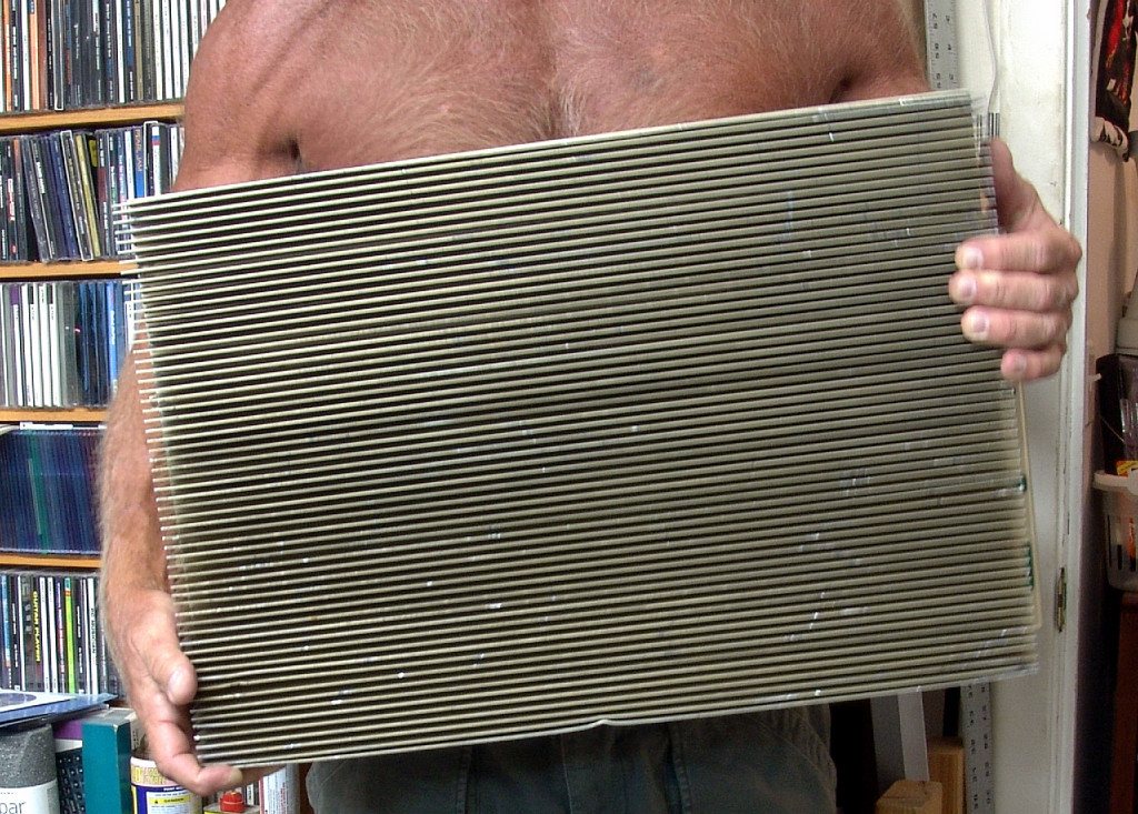

A 200 WPC class A amp would dissipate between 500 amd 1000 watt s of heat. Here in the land of year round air conditioning. I would pay for the electricity to make that heat, and pay much more to remove it from the house. I have a 40 WPC class A2 tube amp, but it hasn't been turned on in at least 2 years. It's rather efficient for a class A tube amp and it still makes about 500 watts of heat.
Now when and if I ever decide to make that big class A Zen amp, I got my heat sink. Already populated with 24 big mosfets. Carrying this thing the 1/2 mile back to the car at the Dayton Hamfest wasn't much fun.
Hey George, like you i go around the house shirttless most of the day, i sweat a lot and if i don't remove my shirt, it goes dripping in no time, a little heavy when i take it off....awsome looking heatsink btw......😀😀😀
I can sweat up a shirt just walking across the parking lot at work this time of year. The older I get the worse it gets. My father was the same way. Inside the house with AC on it's never really cool. It costs too much to run the AC below about 78 degrees. It looks like you are a bit closer to the equator than we are.

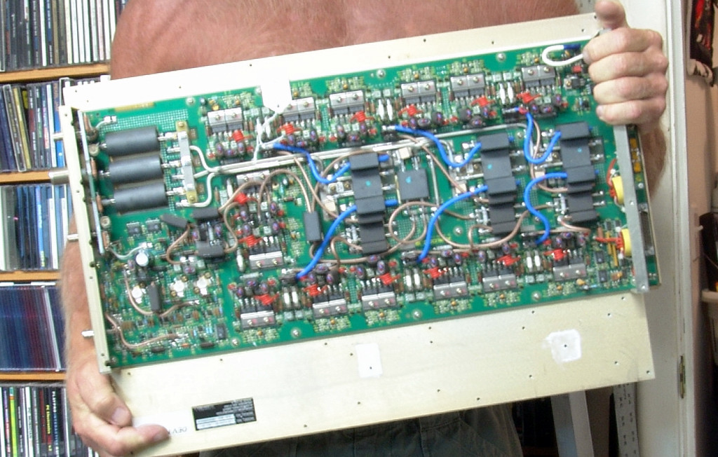

It's got a 5 KW RF amplifier attached to the other side. It's from a big MRI machine so it isn't for continuous duty. $75 at the Dayton hamfest.

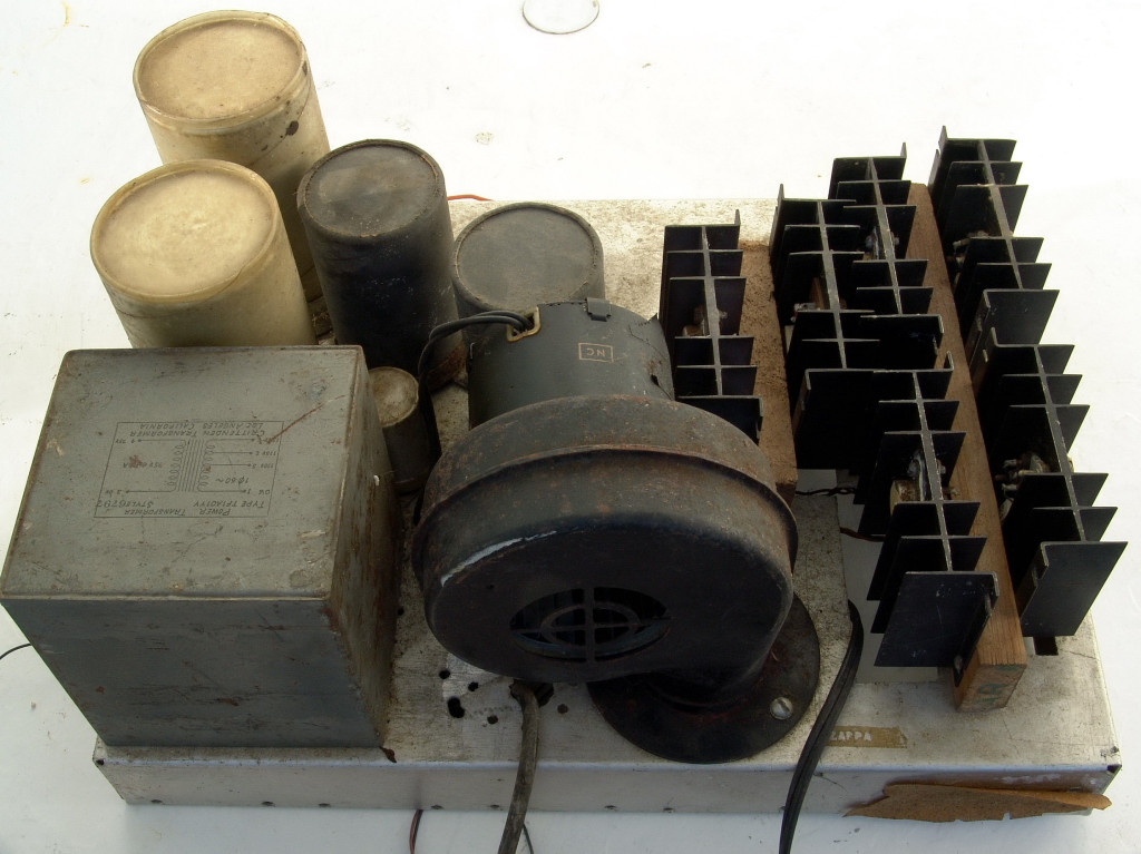

I used that sane design to make some really BIG solid state amplifiers in high school. One had 24 X 2N3773's running off of rectified wall outlet (I was 17 and stupid) We saw it make 1200 watts into a 2 ohm load. It was stronger than any speaker available in 1970. I last saw it in the mid 80's and it was still alive. I just replaced the Fosters sized caps and sent it on its way. The picture shows a 300 watt version I made in 1968 using 6 X "special" 2N3055's. The transistors were military surplus and they would eat over 100 volts without blowing up. I still have some somewhere from 1968.
