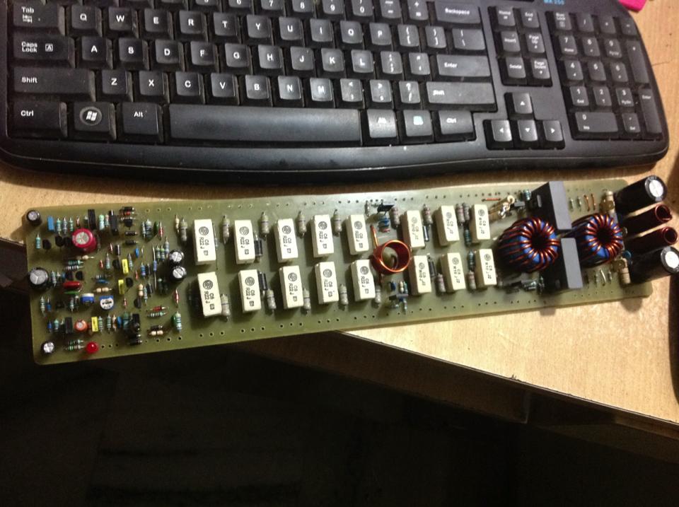

greetings yamaha HD class ee engine is being cloned and sold by many in thailand my unfinished HD class its no secret any more and not so hard to DIY
warm regards
Andrew Lebon😉
Hello
warm regards
Andrew Lebon😉

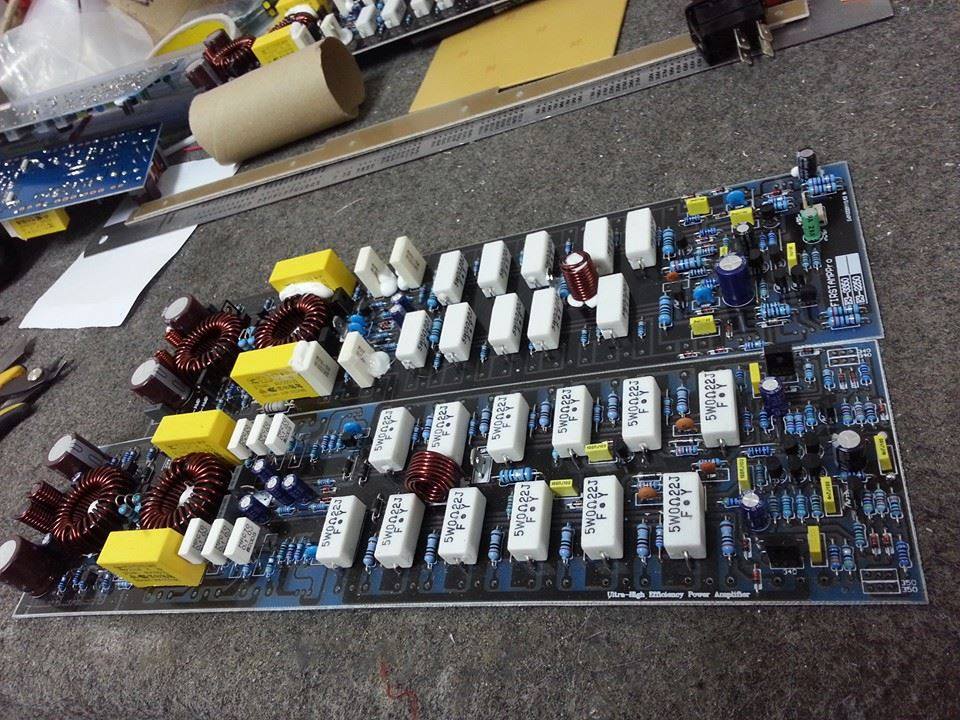

LINK to pcb and component layout of DETEX AUDIO HD 5000 clone of yamaha
warm regards
Andrew
warm regards
Andrew

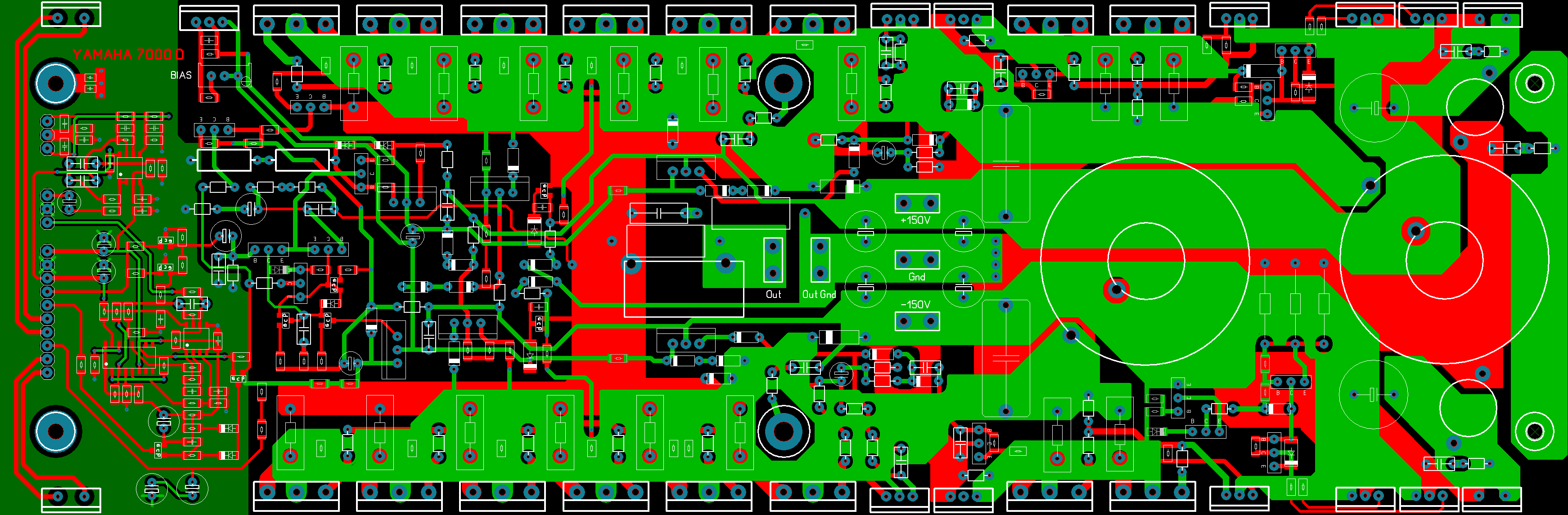

I have a double-side PCB, based on original Yamaha 7000D, with some corrections.
Sample for preview.

PCB in Sprint-Layout 5 format
Scheme in S-Plan 7.0 format
Some items may not be signed, in this case refer to the original scheme.
Symmetrical input & 2nd order low-pass filter was skipped in scheme. It's easy 🙂
Hi Waso
greetings thanks for the sprint layout files is it possible to go over the detex files
project was held up due to unavailability of some trs
warm regards
Andrew
warm regards
Andrew

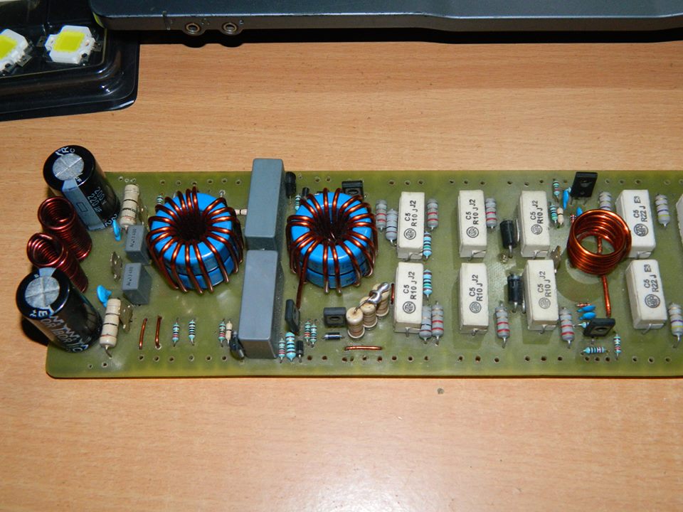

HD CLASS
Hi Waso
greetings the modified XP7000 schematic you posted negative step side PLEASE can you compare it with negative step of detex audio detex audio positive step is working but deetex audio negative side step not working also
in detex audio negative side step one transistor is missing compared to xp7000
your xp 7000 and detex audio positive side matches exactly components to schematic PLEASEif its possible see detex audio negative side step
