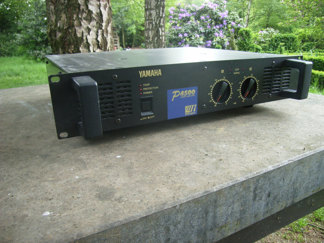

Class-AB meets Class-D: Yamaha's EEEngine Topology - where are this Diy Projects?

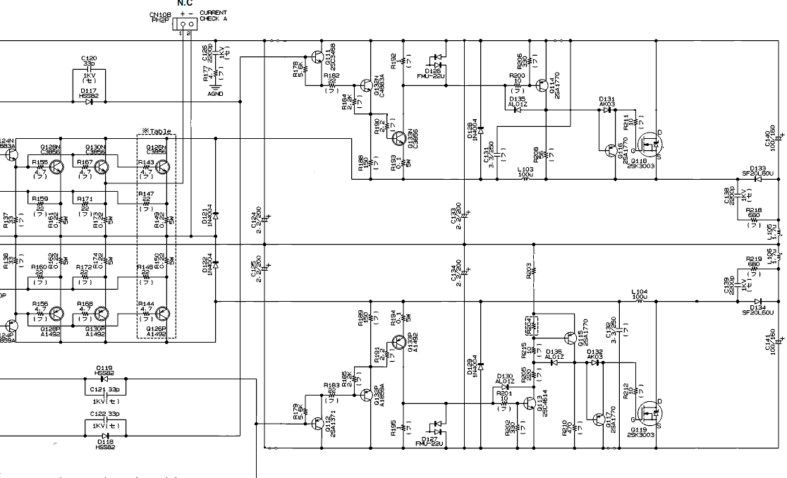

Yamaha regulator is based on linear regulator plus current source to help it.
The current source (self oscillating) work to supply almost amplifier current requirement. The result is stable low ripple voltage, fast response, and high efficiency.
Yamaha did a good work.

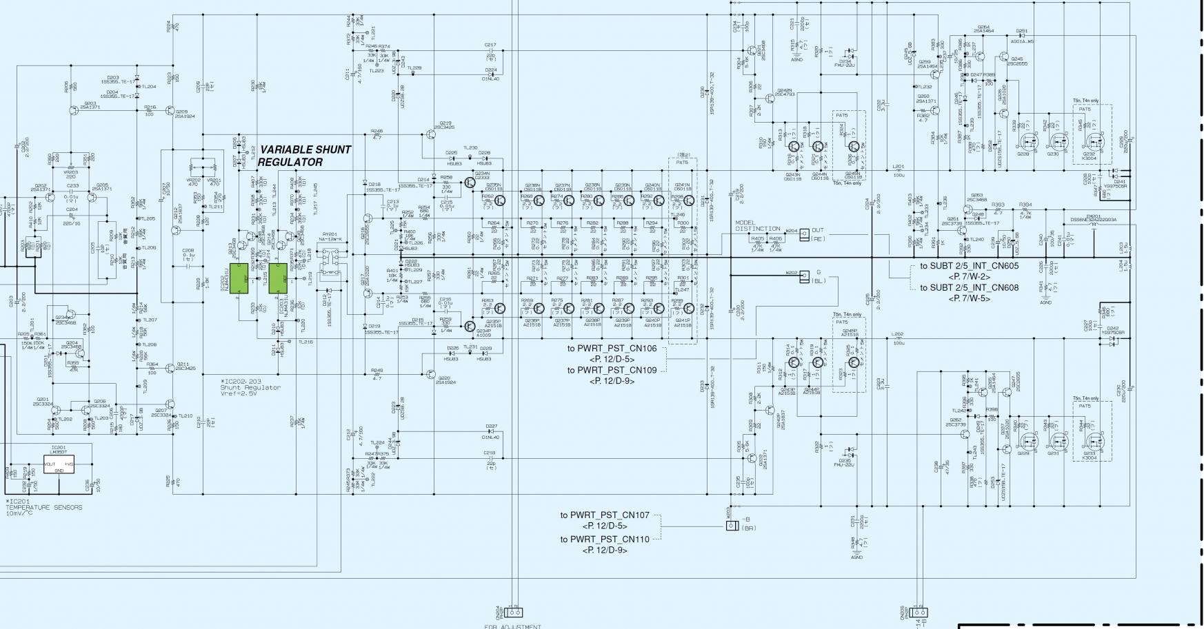

jony: thank you very much for this URL and the schema.

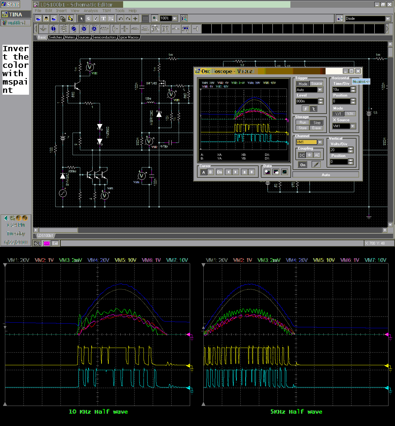

Hi tief, it is not that compelxity(typo). It is simple, more simple than classH drivers.
And this regulator different from both carver and labgrupen. EEEngine regulator is based on linear regulator, unlike the other. This linear regulator working as normal voltage regulator. But there is unstable regulator added to help increasing efficiency by helping the voltage regulator. The unstable regulator help to supply the current needed by amplifier.
This eeengine low power version (XP1000). Lower power version in powered mixers may be simpler.
TINA -Texas Instrument, may TINA7 is free version of TINA9, because I feel that it is better than TINA8.
