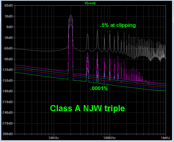

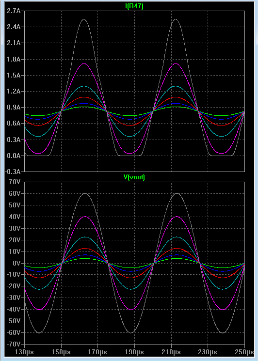

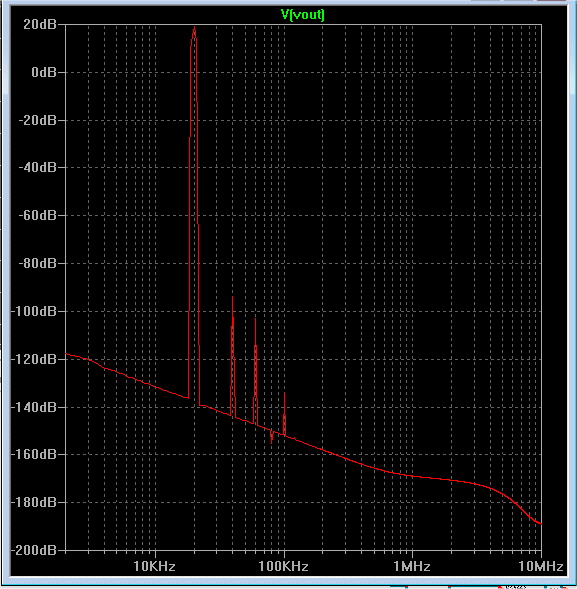

It runs a bit hotter and requires closer attention to thermal design, thats about it.
Quite HOT ! (below) with 3 pair V mosfets running at over 800ma , you can get 40V peak and stay class A (2.5A). It took 6 pair NJW21193/4 running at 400ma and the drivers running 150ma to satisfy Class A with a triple.
What you get - (below 2), is that $30,000 luxman class A beasty (1ppm @ 20khz - H2 dominant) and a warm room in the cold winter (higher power bill , as well 😀 ).
OS

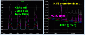

A vs. AB
Below 1 - Class A .. H2 totally in charge except at clip (amp transitions to AB at clip ) distortion PPM all the way.
Below 2 - H2 at real low levels, H3/5 become nearly equal at higher levels , distortion higher rising to .002-5% at moderate levels.
It seems you do get a "little" with class A , but AB is not much worse. H3/5 is most likely totally Xover related.
OS
