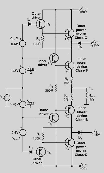

---Class-G= Cascode Connected series Devices at outputs---
Cascade, yes; cascode, I don't think so.

...and Forr , as you can see on Workhorse sch, class-G is a kind of cascode.

Are you guys saying the only difference between Class G and Class H is how the output stage is connected? What Toino linked calling Class H looks to me like Class G, rails jump as necessary. So what is the class where the supply follows the output at a few volts higher than the output to keep the xsistors out of saturation or think of infinite rail jumps with infinite levels to jump?

I apolologize, you're right. In a class G amp, the outer devices and the inner devices work as followers in a cascode mode. The first time I've seen this kind of followers was in a paper written by Nelson Pass. However, I do not remember Self using the term "cascode" for his class G amp, whihc should explain my mistake.

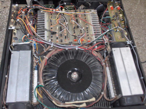

The Real Difference between Class-H & Class-G
In Class-G the switching from Lower Tier to Upper Tier is linear and its amplitude is proportional to the output voltage....
In Class-H the switching from Lower Tier to Upper Tier is Steep Stepped Square wave whose amplitude remains constant[equals to upper Tier voltage] but the width of envelope changes according to the output voltage amplitude...
Donot relate Tracking Rail [Class-TD]designs to confuse with Class-H, the literature from which your are taking reference is not correct at all...
regards,
K a n w a r
