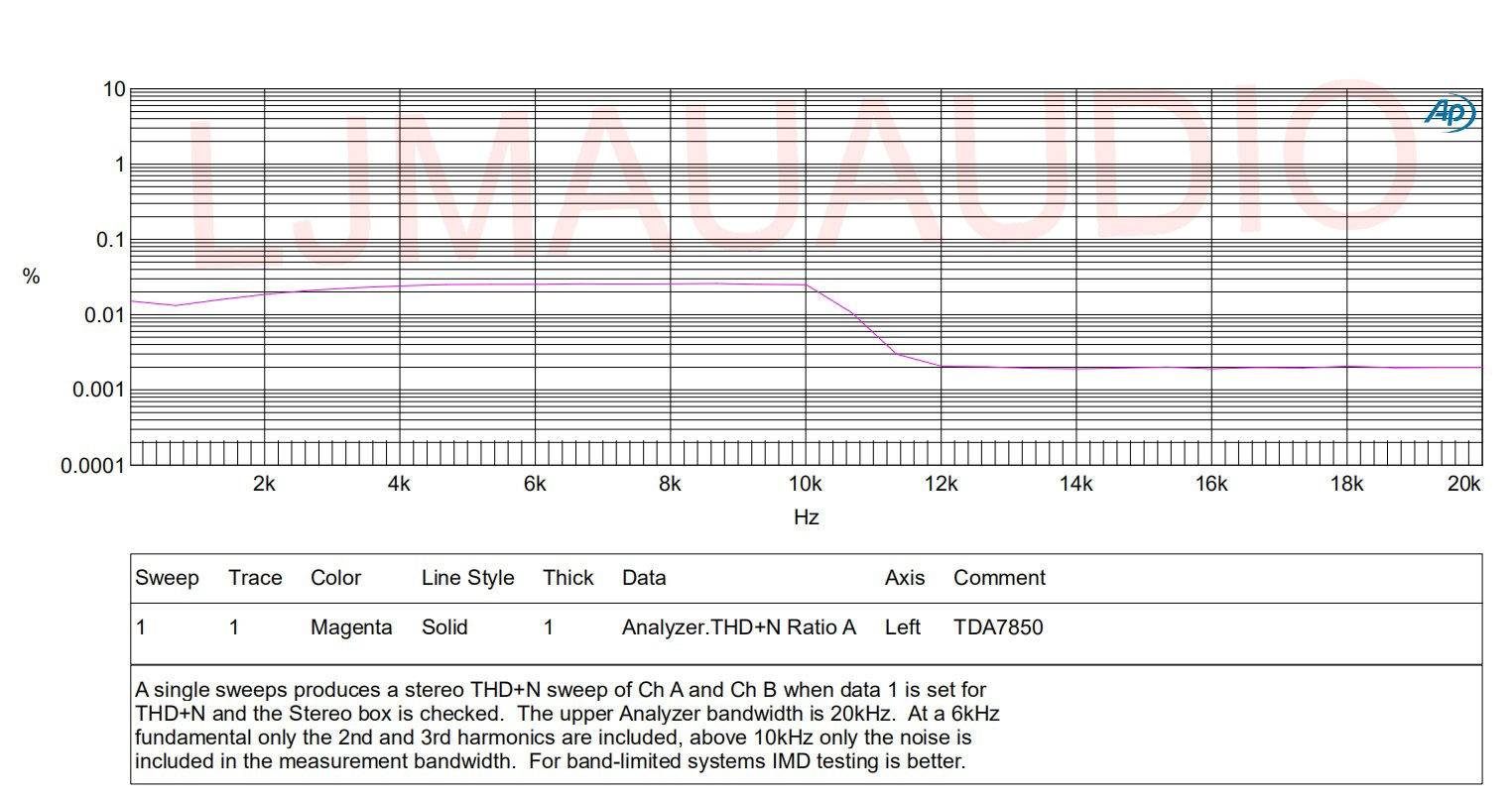

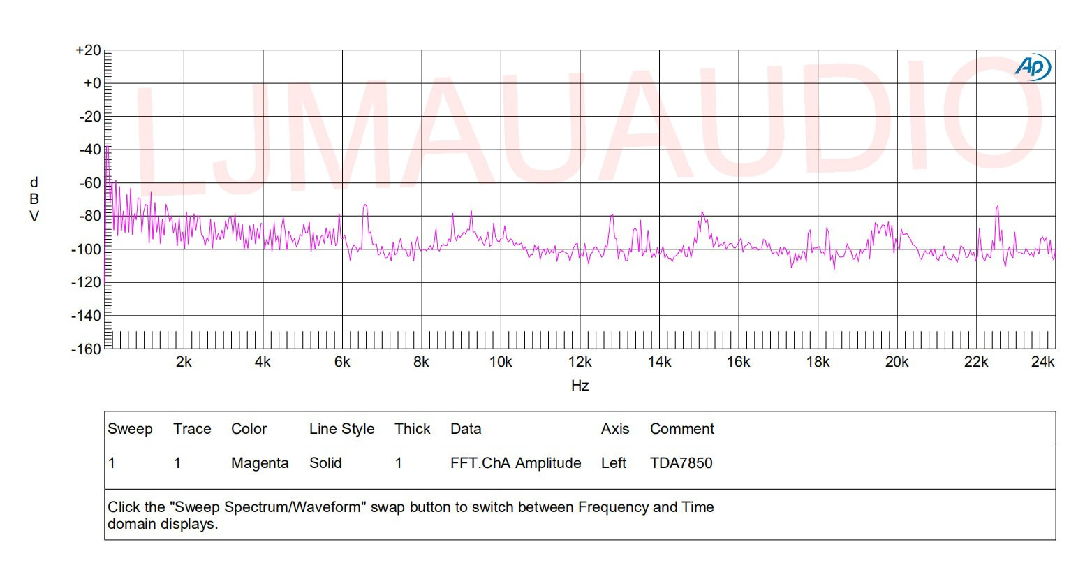

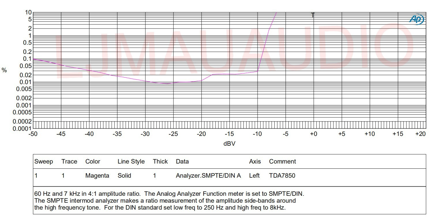

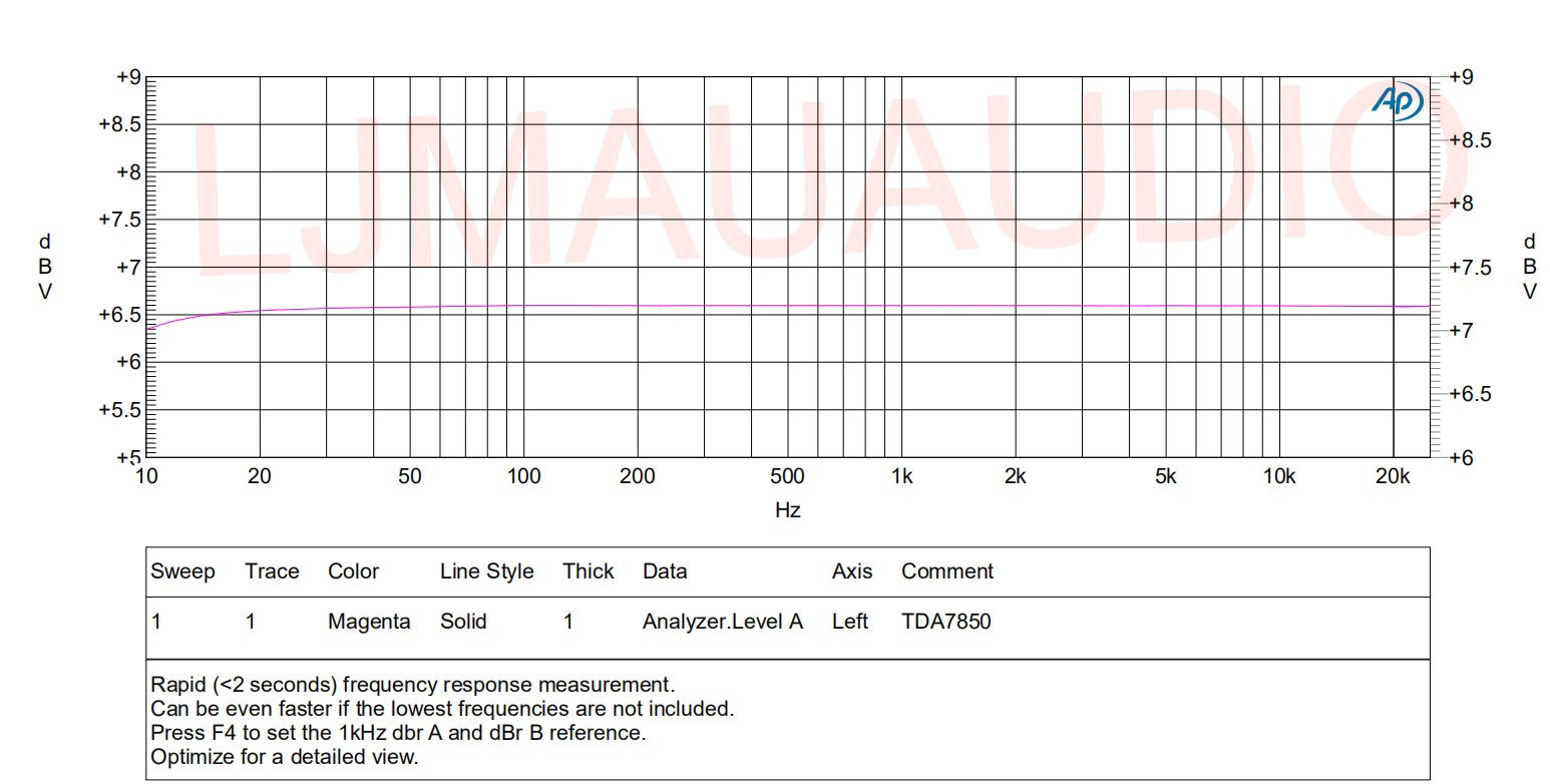

So you have no measurements of your own, especially at 12V as your title suggested.
Patrick
This is not the best performance indicator. But it is true.
I don't like good-looking data. I only like real data. Even if it's not that beautiful
It doesn't matter.
