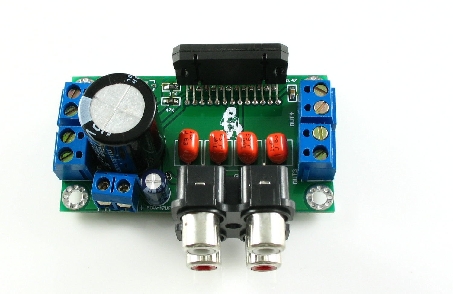

Class AB automotive dc12-18 hifi level Four Channel Power Amplifier
TDA7850 CLASS AB HIFI DC12V
It can replace class D amplifier as hifi level performance improvement.

That is copy-and-paste datasheet description, not ?
Have you measured actual performance at 12V ?
And I wonder if it works at all with 8R load ?

You are absolutely right. This is what I copied.
Because I think the English of ST company is better than me, isn't it.
In most cases. The distortion of 8 ohm load is less than that of 4 ohm load.
Because it passes less current.
This is a relatively simple MOSFET four channel BTL amplifier
If higher voltage output is required. You can use higher voltage.
I think it is generally enough.

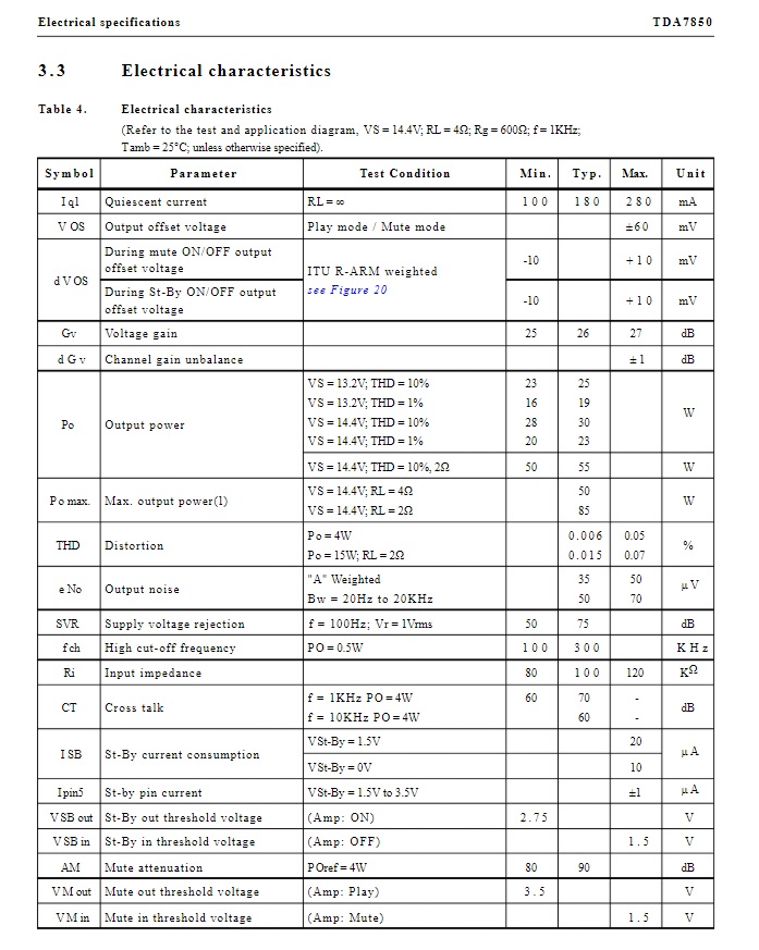

So you have no measurements of your own, especially at 12V as your title suggested.
Patrick
I seldom take the initiative to measure IC amplifiers.
For example, lm3886,1875. Of course, I can take some time to measure it.
I'll find time in two days. In fact, this kind of integrated circuit amplifier.
I think someone with a little experience. We can judge its performance index. It's like a bike.
I can tell at a glance how fast it can run. Of course, if you want to see the measurement data.
I will be in a few days. Take time to test and send data. I think it's similar to the information of ST company.
Because I have measured njm4580d thd 0.0005% before, which is exactly the same as that of JRC company.

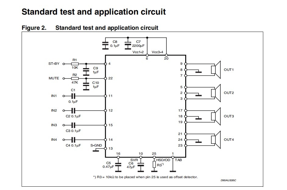

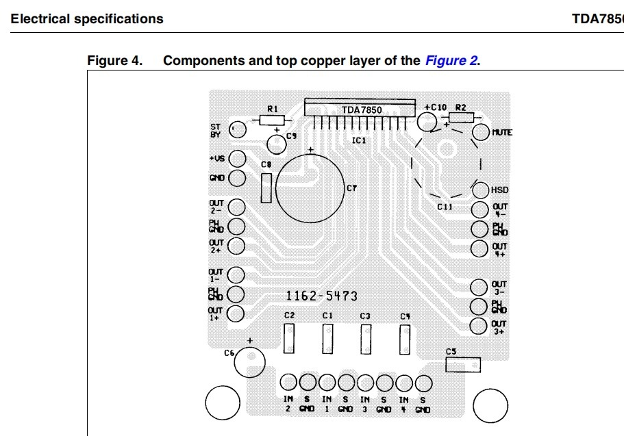

In fact, tda7850 is a very cheap product. I just found that many people use inferior class D amplifiers. Tda7850 can be better. Even cheaper. For example, my product. The price is about $9. In fact, there is no profit. I don't mind DIYer buying things made by others.
Because it's really very simple. The total number of components is only 6 capacitive resistors. So you don't need to buy what I produce.
And it has four channels
I'm just giving advice. It is better than tpa3116。3225 or even ma12070.CLASS D And cheaper.

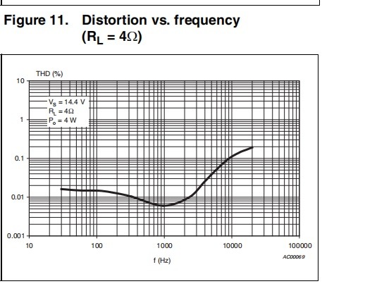

I think whoever produces the tda7850 should have almost the same performance index.
Because relative to class D.
It has no high-frequency PWM. So the 7850 is easier to make. The performance is basically the same as that of ST company.
Although some models of class d have good performance indicators. But that requires a very high PWM frequency. Very demanding inductors. And strong EMI radiation. The actual performance of class D is lower than the official data.

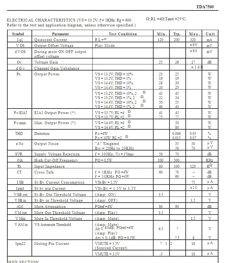

Good advice.
If you only believe in datasheet, then TDA7560 has even slightly lower distortion.
But may not be so easy to get.
Patrick
I checked the information. I think they are not much different.
Careful discrimination will find that the tda7850 is slightly better.
