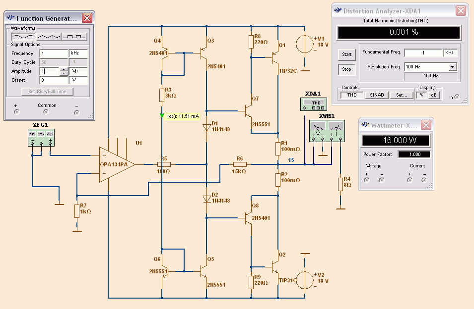

I actually cobbled your circuit together on a breadboard and find that for low impedance loads and even with a 4560 opamp the results are not good. I used some crusty old outputs that would be similar to the TIP31/32 type.
The problems are... the opamp has insufficient current drive when faced with low gain transistors and a low impedance load.
I tried the text book diode bias arrangement using 0.22 ohm emitter resistors for a little stability. Much better but this showed another issue. The resistor/diode network between the rails to bias the outputs causes an unacceptable loss of headroom as the opamp now has this added load to drive.
All in all... not good although as an example to learn it's excellent.
A Sziklai output, 2N5551+TIP32, allows better swing from resistors.
Resistors can further be replaced by simple current mirrors fed by a resistor.
I might publish diagram of my idea.
Sziklai 16 Watt 8 Ohm THD 0.001%
2 current sources made by mirrors
Bias 48 mA at idle
