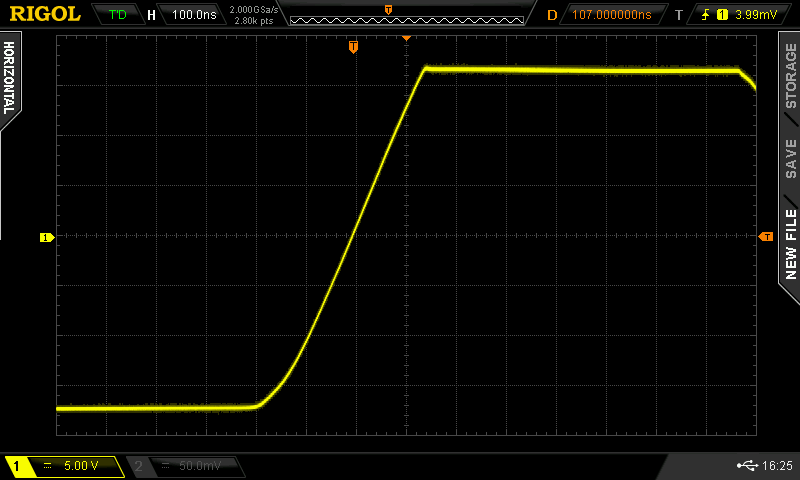

Here is a little toy that I built a few months ago. Slew rate is > 110 volts/microsecond. If you search the site you can find an amplifier by Winfield Hill of Harvard (co-author of the famous book "The Art Of Electronics") whose slew rate is 1000 volts/microsecond.
Class AB amps don't typically swing the whole power supply voltage. My PV-1.3k maxes out 600 W 4 ohms or 49 Vrms, or 68 Vpp from +-85 v power supplies. That would be a 170 v single supply so the swing is 40%. That amp specs 20 V/microsec slew rate. That is for <-.1% Harmonic Distortion. They sold thousands of them in the PA market.All,
What would folks consider to be an acceptable slew rate? By my calculations, If I were to use this at the full 65V supply voltage, I would need a slew rate of at least 8.2V/us for a full 65V swing at 20kHz (2*PI*20,000*65/1,000,000=8.164).

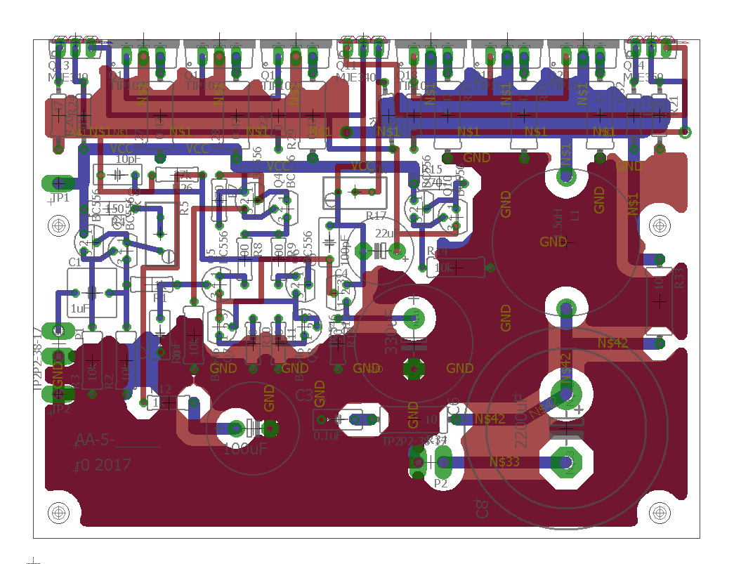

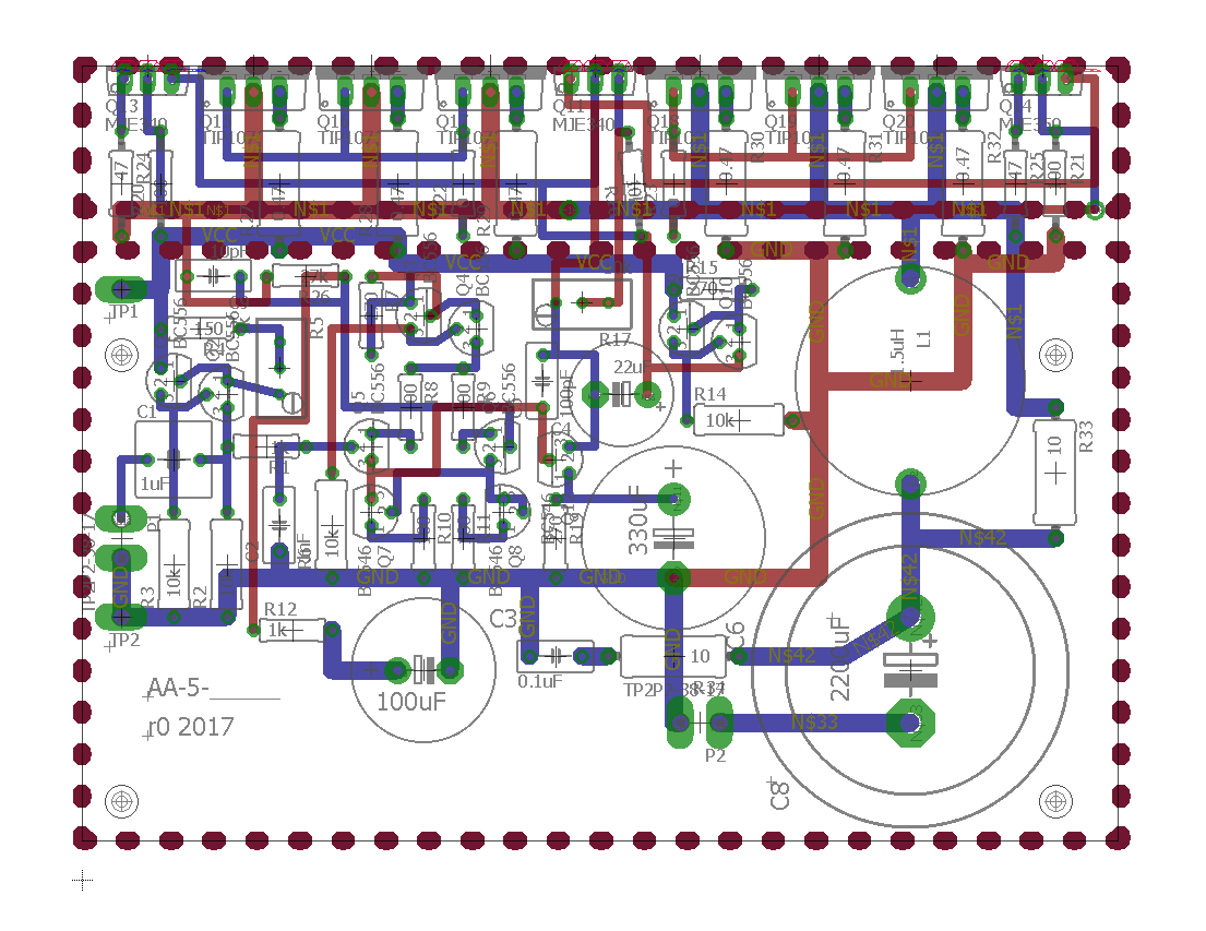

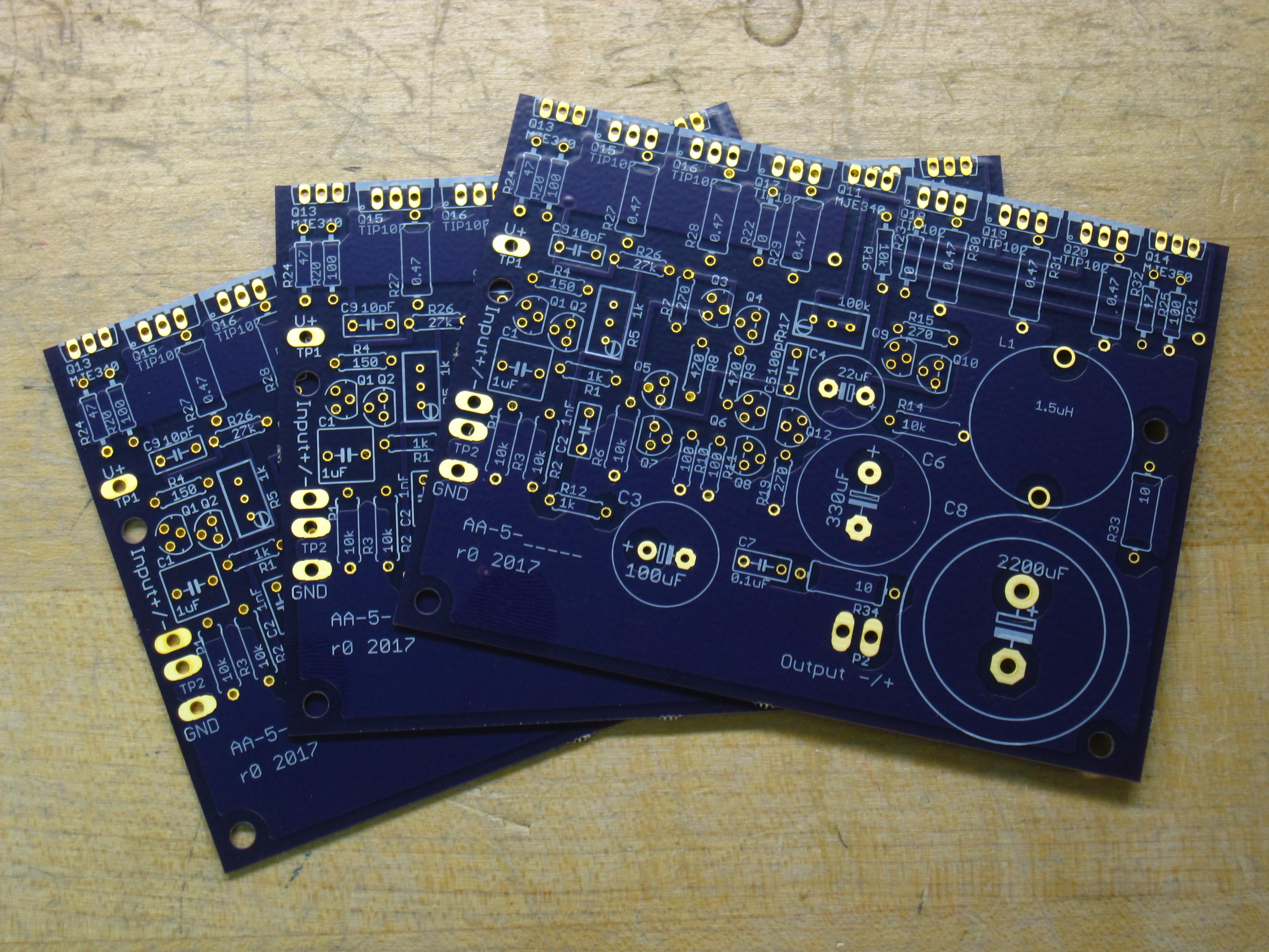

I have finished with a first draft of the PCB layout. I am also trying to work on a breadboard prototype in parallel, but I may end up breaking down and ordering the boards to make the prototype instead.
The board comes in at about 3"x4" (10x7.6 cm). It is unlikely that they would stack easily, as the large C8 capacitor is about 50mm tall. I tried to make the layout pretty dense. It's double-sided, so it may be difficult to do hand-etched boards of these.
I'm pretty new when it comes to PCB layout, so let me know if there is anything I can do to improve/correct my board layout. Should I be putting the pads for the power transistors right against the edge of the board, or would it make sense to pull them back a bit?
I'd say output transistor pads along edge is traditional.
those long parallel runs between base & collector of output transistors might cause oscillation. I'd be tempted to fly in the bases in the third dimension.
You need to put a resistor pads between base of Q12 and plus & minus rails to allow for centering the output to the speaker capacitor. This won't show up in simulation, transistors are symmetrical in sims. But centering the output would eliminate one sided clipping due to inadequate headroom one way or the other.
There may alternately be something you can do at the connection of Q5 and Q7 to do the centering, for less current, but I'm not experienced enough with CCS to know exactly what to do there.

I doubt that there will be significant capacitive coupling on the PCB. The internal Cob of a TIP102/7 is like 200/300pF already anyway. Or is that not what you meant?
I'm not sure I understand what you mean here. The center point will be set using the R5 trimmer on the input bias CCS. I use R2 in combination with the CCS to set the center voltage. I have done this on past designs and had no issues. Even in the simulation, the clipping levels are slightly asymmetrical.
I'll PM you about the boards, although you may want to wait until I've actually tested it before you offer to buy any. 😀
Okay super, I don't understand CCS enough yet to understand what R5 was doing to Q2. Centering figured out already, great.
1.5 mH on output inductor is traditionally a solid core wire wrapped 12 turns around a china marker. Peavey calls that 0.8 mH. Size can be TBD, even stood on end. 22 ga wire should be good enough for this power rating. I have a coupla rolls of that.
As far as RF coupling between long parallel runs, it is not so much capacitance I don't believe. More of an inductance. Happens in the RF where you don't want the output transistor burning up current while it oscillates. 8 pf an inch isn't a bare wire in open air?
Usually amp boards have 3 amp diodes between the output and the rails. this could be outside (field side) the speaker cap. this protects from induction voltage spike if the speaker wire comes loose under high currents. These diodes are usually back biased.
I've cut & spliced PC boards in checkout professionally, I don't expect them to be perfect first time. All that CCS stuff in TO92 in the front end I'd like printed out, wiring that by hand would be tedious. For a look at my board & wire construction technique you may look at this: http://www.diyaudio.com/forums/solid-state/236256-retro-amp-50w-single-supply-20.html
Crude but doesn't oscillate overheat hiss or distort (much) .
Connections are loops of wire through 2 holes on board at the edge. on board wires solder through the loop, field wires solder through the loop. No funny little Euro connectors to buy.
If you up the buy from 3 quantity boards to 5 or 6 maybe price each will drop.

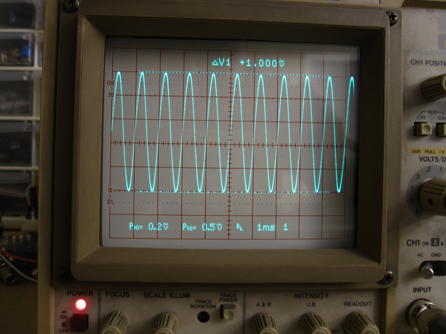

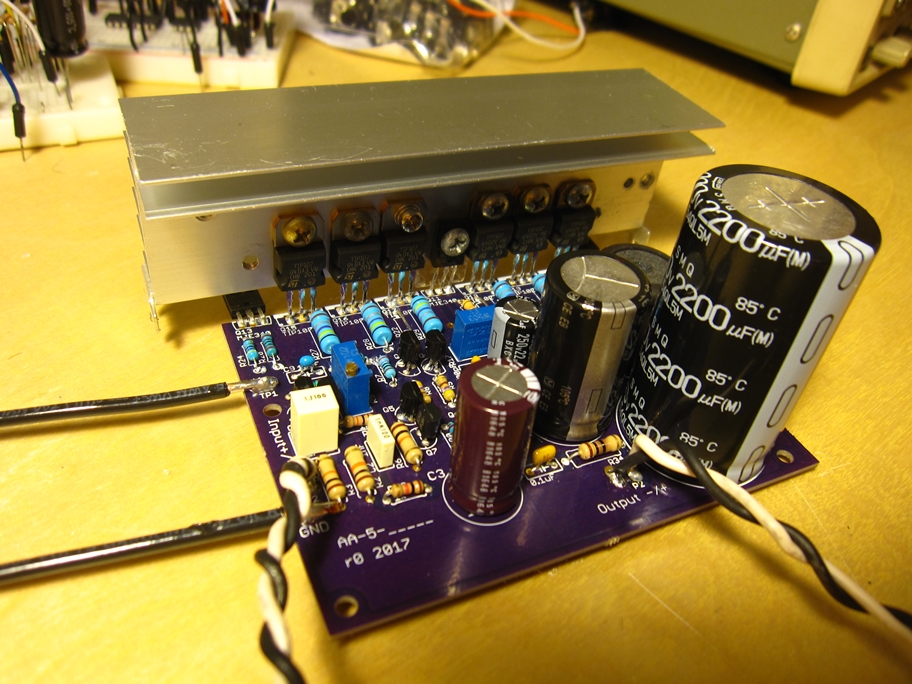

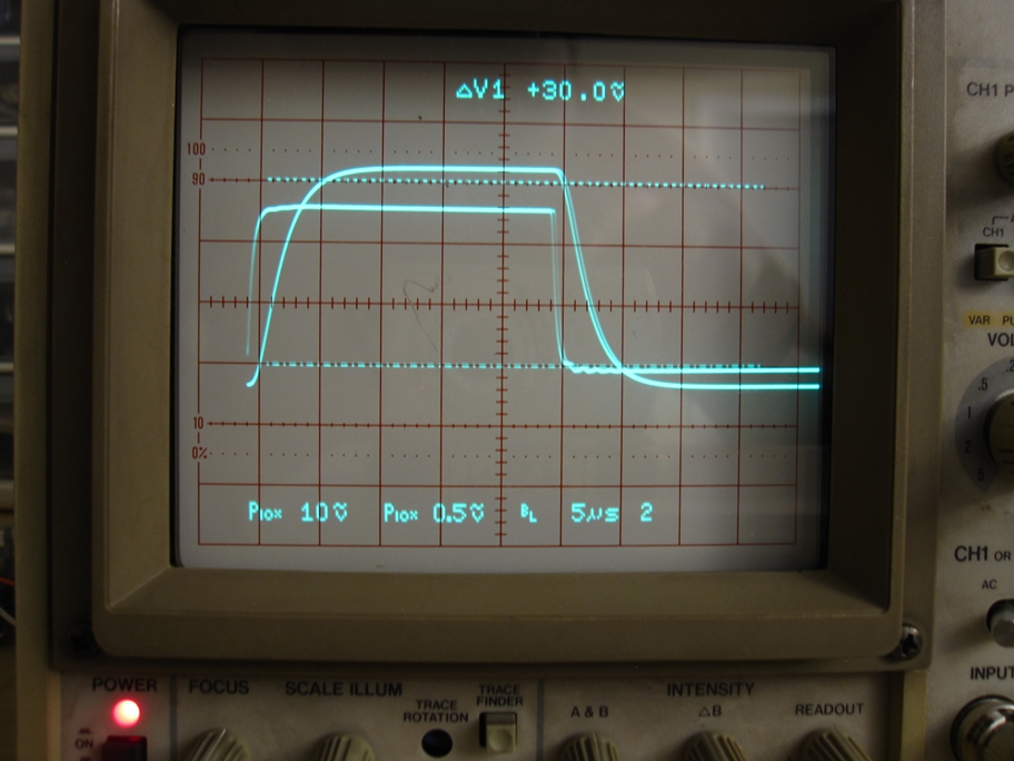

I have finished building the initial prototype and begun testing. Everything seems to be working correctly and seems relatively stable.
Slew rate was roughly measured at approximately 6V/us, which is lower than anticipated. looking back at my simulation, I think I may have set up my simulation incorrectly by having an input signal that was over-driving the output. resimulating it with better values comes out to a slew rate of about 7-8 V/us. Hmm...

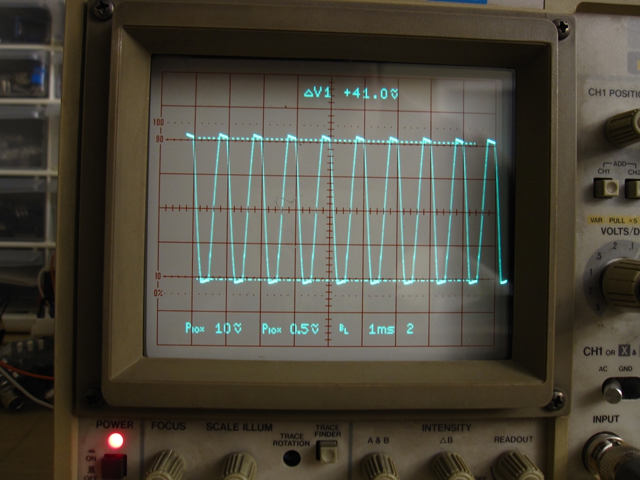

Maximum output swing is measured at about 41Vpp for a +48V supply, which comes to about 26Wrms max output. This is pretty much exactly as per the simulation values.
I will be setting up for distortion measurements next, but as stated previously, I need to check if my cheap signal generator is low enough distortion for precise measurement. I recently ordered a Keithley 2015 THD multimeter, so I may have to use that instead when it arrives.

Great. 26 vac out of 48 rail is very good. What load was that, 8 ohm? Speakers or resistors?Slew rate was roughly measured at approximately 6V/us, which is lower than anticipated. looking back at my simulation, I think I may have set up my simulation incorrectly by having an input signal that was over-driving the output. resimulating it with better values comes out to a slew rate of about 7-8 V/us. Hmm...
Even no errors found and no oscillation is also better than expected.
The load is a large 6 Ohm speaker, albeit on a somewhat long cable. I initially powered it up open circuit and did not see any signs of instability, either.

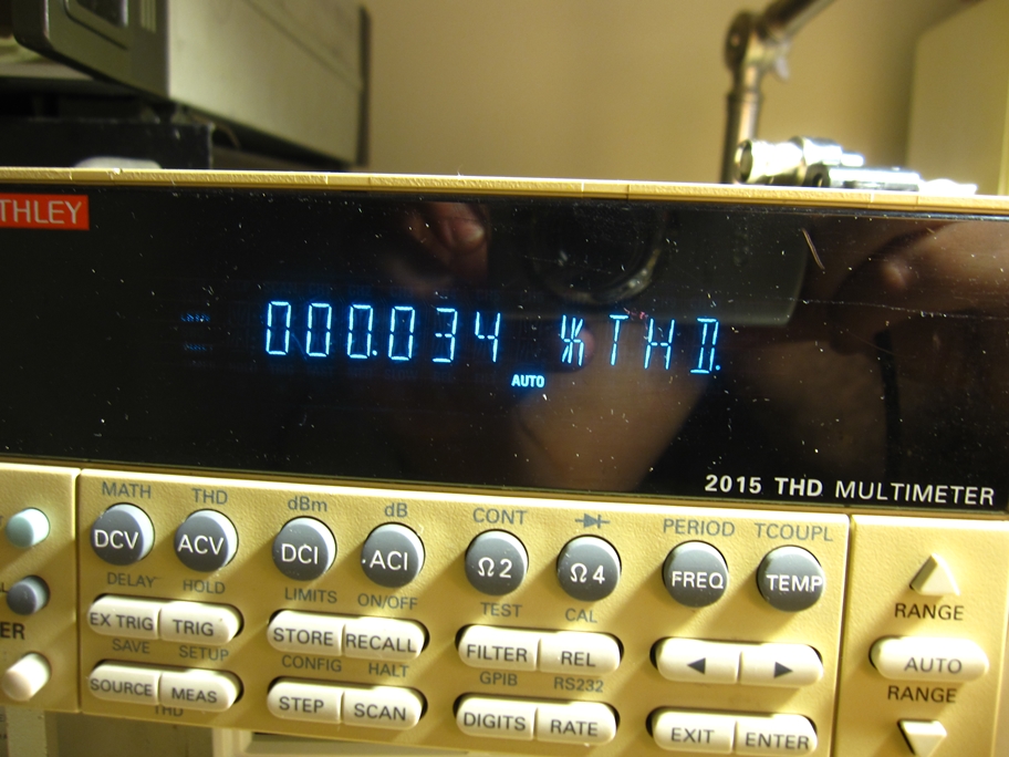

My new THD meter came in. It turns out the cheap signal generator I was using had a THD of around 0.3%. Good enough for basic testing, but nowhere near clean enough for THD measurement. Fortunately, the THD meter I got comes with its own signal generator on the back.
Initially, I also had some trouble with the Keithley 2015 because its own signal source was measuring about 0.028% THD just by itself, which is out of spec if I read the manual correctly (I guess that's what I get for buying "refurbished" equipment on ebay). However, after cobbling together a quick 1kHz low-pass filter to put in line with the signal source output, I was able to bring that number down to about 0.004%, which, if I understand correctly, is roughly what the device is rated for in the manual.
Measuring for a 1kHz input signal at about 1Vrms output and about 50-75mA bias current per pair (the bias current fluctuates a fair amount with temperature), I measured about 0.005% THD at the output, which is effectively in the noise floor of the instrument. Raising the output level to about 10Vrms at the output caused the THD to increase to about 0.034%.
Overall, I would say I am fairly happy with these results, although correctly simulating and designing for better slew rate will be high on my priorities list for future designs. This is the first time I have really done detailed measurements on one of my designs, so I don't really have a reference point for whether these are good results or not. I have seen a fair amount about simulated numbers, but I have not seen as much in the way of physical measurements for comparison.

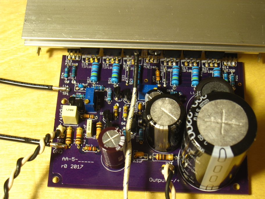

Received the boards this PM, thanks jlny. Tsistor Pads are so tiny I will have to purchase a better soldering iron before I assemble, IMHO. have a great summer.

Glad to hear the boards arrived. Thanks, I'm pretty happy with the results.
Also, yes, some of the pads are a bit small. Those are the default pad sizes used in Eagle, so I may have to go in and edit the pad layouts if I want to make my designs a bit more hobbyist-friendly. I'm still relatively new to using it.
As for a soldering iron, I just use a generic "937D+" soldering station clone with a pencil tip. Soldering stations like that can be had on ebay for maybe $30, and they are decently good for what they are. Just be sure to check for the occasional shoddy unconnected ground wire...
My only other comments would be to be careful on the pads that connect directly into the ground planes-- it will take quite a bit of heat to get good joints on those and my relatively weak iron had some trouble delivering enough heat. Before powering up, I would recommend setting R17 to its maximum resistance so that the bias current will be zero at the initial startup. For a 48V supply, R5 should be set to about 142 Ohms for initial startup and adjusted as needed for VCC/2 at the output behind the output capacitor.
