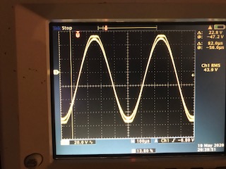

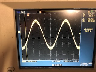

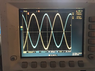

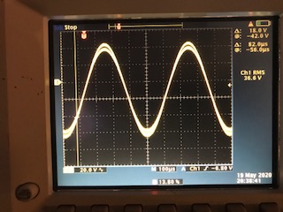

So want tom show some interesting results from my balanced attempt with the Pass AB. Ran into some issues with the Doug Self preamp as source. Feeding SE input and using balanced output. You can see from attached pics that the gain between the two phases is not identical. One is 1.25vac and the other is 1.09vac at 1000hz. So looking at the output across 5.5 power resistor on scope I see two signals. I have not completely thought thru that buts seems like I should have seen one signal that is sum of two outputs. HMMM. someone set me straight. You can actually see that as it clips the higher gain signal clips first. I'm assuming this is all related to the fact that the two phases aren't matched in gain. I'll need to troubleshoot gain stages. But interesting that the AB puts out ~430W into 5.5ohm at clipping. Plenty for the Maggies.

So Got the preamp issue taken care of. It was ok but scope leads had to adjust capacitance. Everything good now with that. But output still looks the same.
Scope is connected to one side of power resistor and ground is on other side of resistor.
Scope is floated.
Two channel scope if you can get one would be super handy... I’ve played with bridge and floating outputs on amps and they’re sometimes seem just idiotic how they behave when being measured.
The most reliable solutions for me were to keep the grounds intact, and use the scope A-B function to display the composite waveform. If your waveform doesn’t clean up, it looks like you have some oscillation going on...
