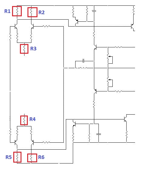

@DjLeco, diagram overload protection I think like with the diagram below called amp.jpg (I could even say almost the entire amplifier, perhaps with some small differences, the number of output transistors...).
I have attached below block diagram drawn by you where I framed with red some resistors. What value are the currents through those resistors?
I ask this because that current values are important for proper functioning of the amplifier. DC balance of the input differential pair is essential in power amplifiers. It still seems almost unknown that minor deviations from equal Ic in the pair seriously upset the second-harmonic cancellation. So, imbalance also reduces the open-loop gain if serious enough. Treat this issue very carefully.
