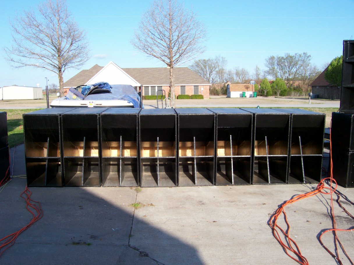

Can you show a picture of the set of speakers you will be driving.
I'd love to see them
Could very well be something like this. No kidding no joke - these are real. I was using three CA18's and an RMX5050.

Would be something if they were really functional speakers,
Just imagine the amount of air it would displace, stand in front of it and literally let it blow you off your feet 🙂

I would say these could be the real deal.Would be something if they were really functional speakers,
