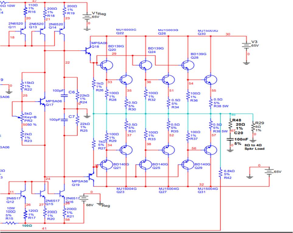

Class A
No! If you have +65V and -65V and the output at 0V (as it should be), with no signal, each transistor has just a bit less than 65V because of some losses. The 63V is fine.
Nelson was thinking your 65V was really +32.5V and -32.5V.
You DO realise that several days of posting were wasted just because you're too lazy to post a schematic?
You should also read up on class A, because the voltage across the transistors has nothing to do with that.
Do your homework, Google is your friend.

here is the schematc
Thank you. I am with the others:
Class A/B. Or "B".
2 x 65 V are very unusual for Class A - exept you would use 2 x 15 powertransistors, or so on;-)
Your psu had to give > 1,2 kW continuous;-) There should be a trafo-power of > 2,5 kW, as example;-)
You could set the current bias as high as psu and heatsinks perform;-)

ok thanks for the infos guys, so i need current settings to make it in class AB
