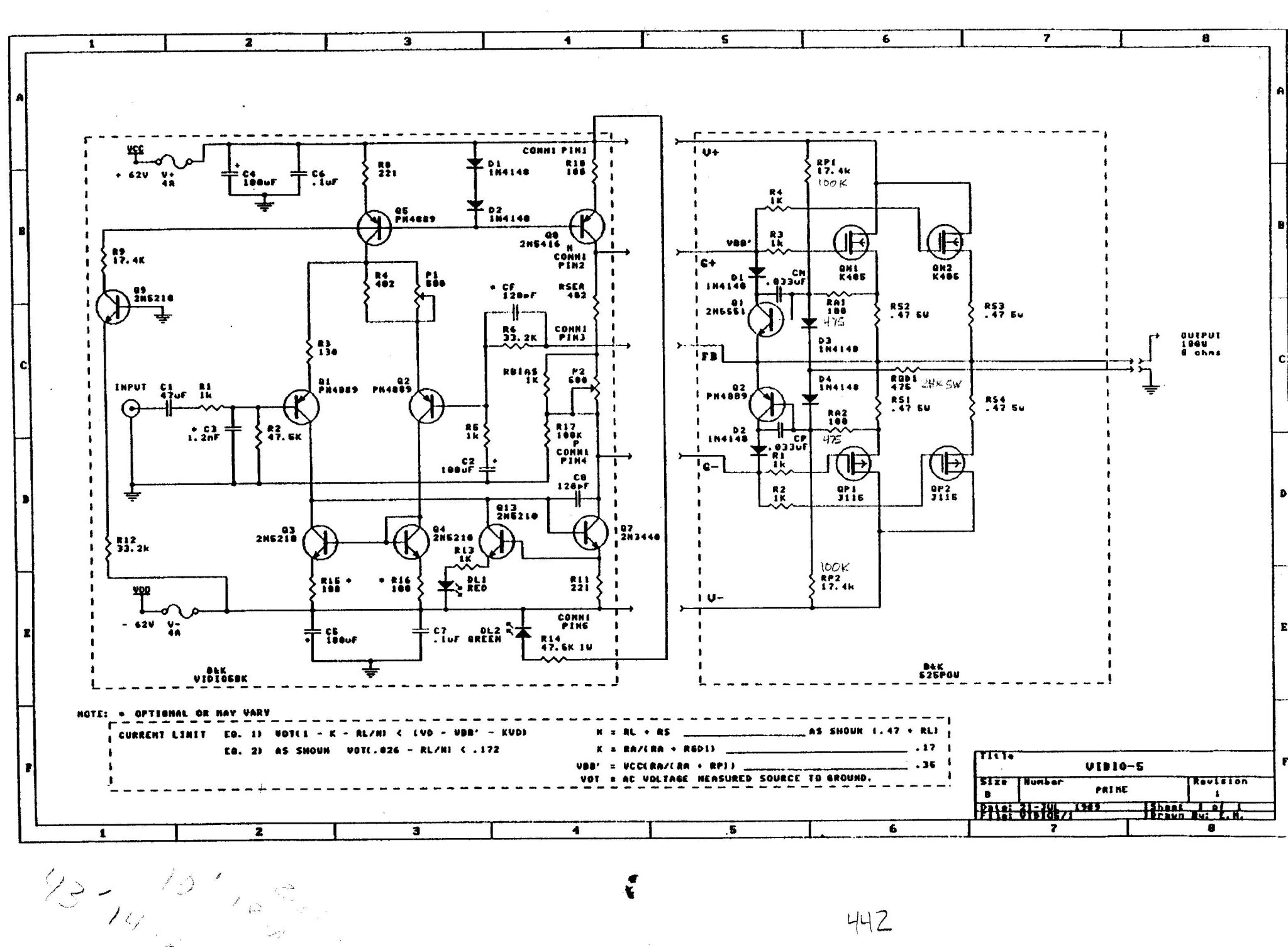

Class A using B&K Video 5

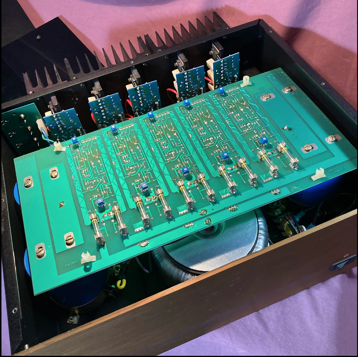

Yep, that's the one. I was thinking of keeping the B&K as a stereo amp and putting the extra 2 channels as "Class A" into another chassis with more heat sink area. My question was will the Toshiba output Fets work? Or another design, as matched J74 are hard to find?
try finding appropriate schematic using 2SJ49/50 and 2SK134/135 and build any of those with your mosfets
for common type FW amp, regular IRFP mosfets are better choice - more power, greater xconductance
and - do not count to have more than 25W of dissipation per device (of yours) with proper heatsinking - those are "just" 100W devices with somewhat smaller case
