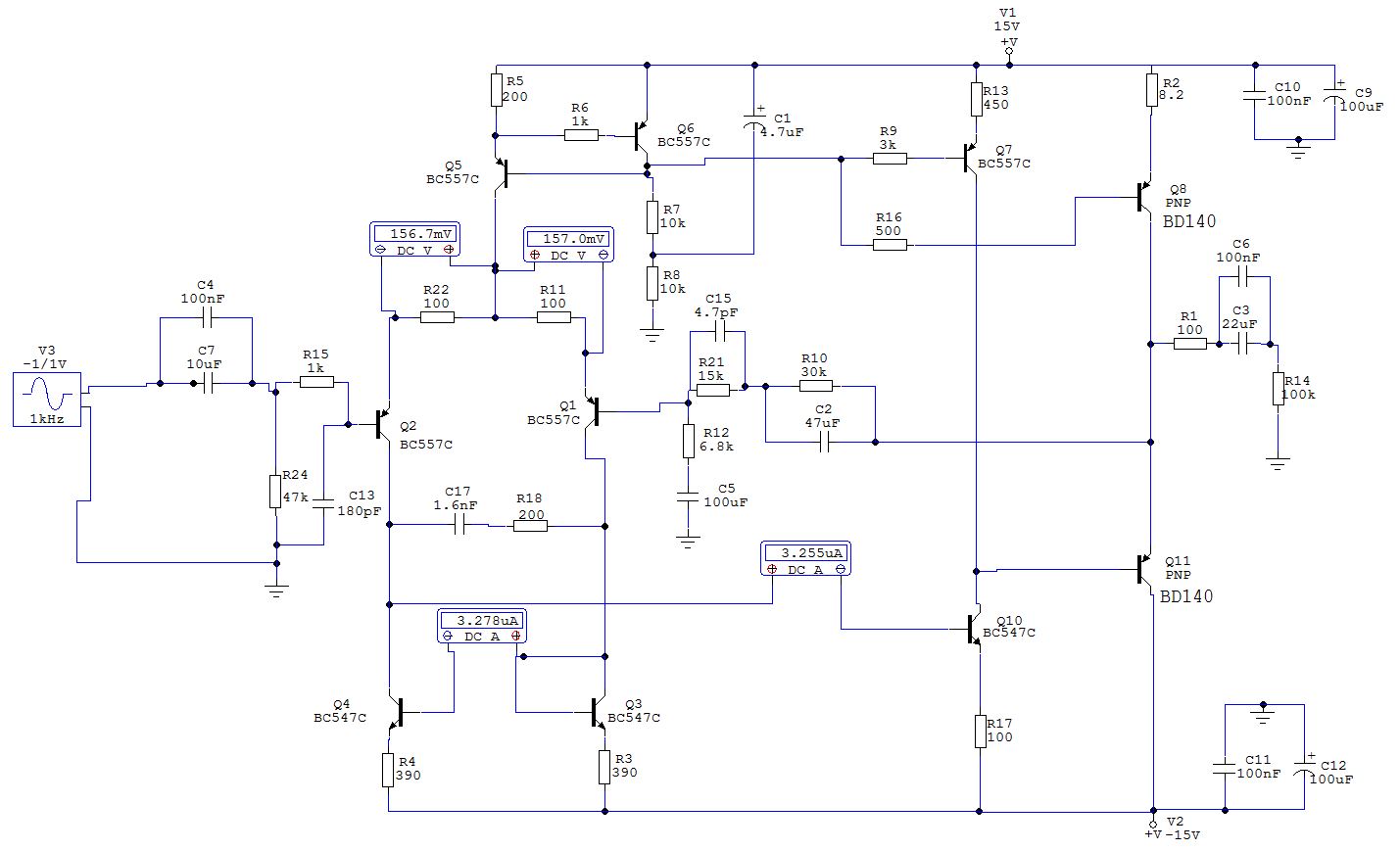

Class A preamp: please critique my circuit and give me helpful suggestions.
Sounds like your having fun.
The phase shift looks a bit excessive over the audio band. I would have to analyse the circuit but you should measure after the input filter (although that won't make a huge difference). Limited slewing of the VAS (C15) might be worth looking at.
I agree, the phase shift is too excessive and I think a slight redesign is in order. I'm going to follow the suggestions laid out in the E.Cherry paper I linked in the previous post and see what results I get.

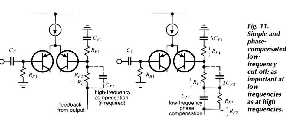

Dr Cherry - phase corrected NFB
Cherry tells us that Rb1=Rf2+Rf3
and that Rf3=2*Rf2
therefore we get
Rf2= 1/3*Rb1 and Rf3=2/3*Rb1
He also tells us that Rf3*Cf3 = 2*Rf1*Cf1
and from that we get Cf3=Cf1*Rf1/Rf2
eg.
with Cc=1uF, Rb1=45k, Cf1=100uF, Rf1=680r
then we get Rf2=15k, Rf3=30k, Cf3=4u5F with an F-3dB = 3.5Hz.
and that Rf3=2*Rf2
therefore we get
eg.

Success!
So it turns out that the root of the problem was the high pass filter on the input. After swapping out the 1uF input cap for a 22uF a big improvement was seen. I then tried two 1000uF caps back to back to make a 500uF bipolar and a further improvement was observed.
I tried both traditional feedback and the Cherry style feedback. There was a big improvement with the Cherry feedback.
Feels good.
AndrewT, That Cherry LF compensation is really a neat trick, thanks for the tip.
The only side effect I can see is the potential increase in offset voltage as a result of the higher Rf and Ibos contribution.
If you make the total Rf the same for Cherry's approach versus just one C then the difference isnt quite as dramatic, still really neat, thanks again

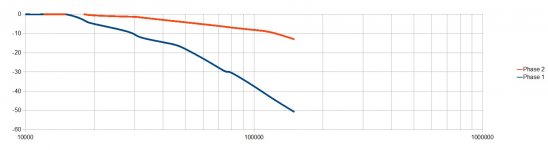

My next task is to sort out HF feedback in order to fix the phase problems at the other end of the amplifiers bandwidth.

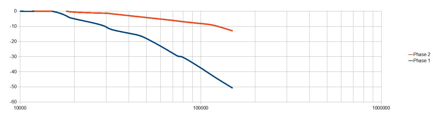

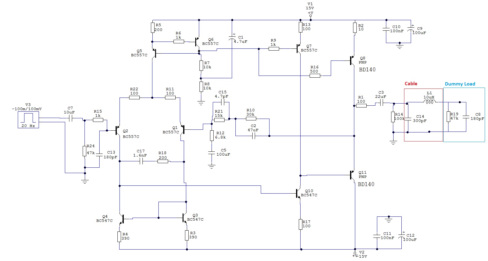

Circuit now seems to meet all necessary parameters
I now have what appears to be a circuit which is stable at all frequencies (even without the feedback cap C15) and exhibits good phase behaviour at both ends of its bandwidth.
The phase diagram depicts both the before and after slopes. Red obviously being the after.
It's been a long day, I think I'll have a beer 🙂

4.7uF is too big as an input capacitor.
That puts LF signal across the NFB capacitor.
The passive filter at the input must be at a higher frequency than the NFB roll-off.
The NFB roll-off RC is 680r * 100uF = 68ms
The input filter must be less than 68/sqrt(2) i.e. < 48ms
With input resistance set to 44k then the input cap must be less than 1.1uF, not 4.7uF
Note, 44k is the theoretical trimmed value to match the -IN & +IN source resistances.
47k//680k ~ 44k
