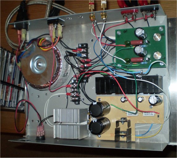

Hi guys, Mark,
I finally put one monoblock into a decent DIY box. My power supply uses the "charge-transfer" concept from -ECdesigns- (alike "never-connected" PS from JC, I think) plus the previously mentioned PowerReg gyrator based regulator.
Photos:
http://picasaweb.google.com/lh/photo/8DI-hfrJQ2OkYHDig9m4XA?feat=directlink
http://picasaweb.google.com/lh/photo/DBPGMEHS_kM2f_Pev5oCZg?feat=directlink
Here is the charge transfer concept, post # 2347:
http://www.diyaudio.com/forums/showthread.php?threadid=79452&perpage=25&highlight=&pagenumber=94
Listening to mono recordings, voices are sooo sweet and articulated...
Any advice is welcome.
M

Not sure about the power supply techniques you are talking about. I have not heard of them before.
Your build of the ZCA is very different to all the others I have seen. Still if it works and sounds good, why not. It looks like you made your own enclosure.
How does it sound?
How does it sound?

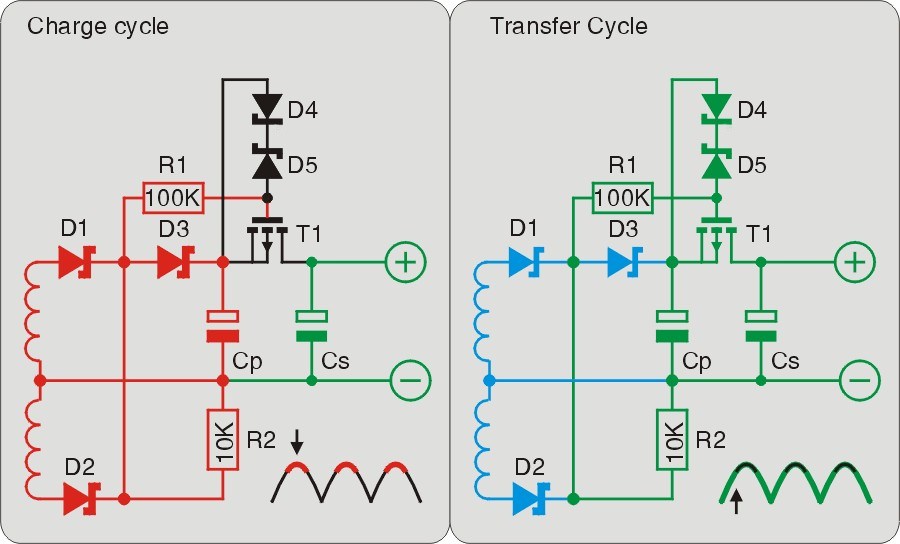

Hi Mark,
I attached (I think
) a concept diagram of a simplified charge transfer PS. It is supposed to disconnect mains noise from active circuit by using a Mosfet as interruptor between two main PS caps while rectifier diodes are passing current, on the rest of the cycle the Mosfet connects both caps. I know my explanation is bad but you will see by yourself with the diagram...I hope.
Yes, the box is completely DIY and the parts are very cool. The hotter parts are in fact the power resistors that form part of the charge transfer supply and the little transformer itself: 120VA for a monoblock.
