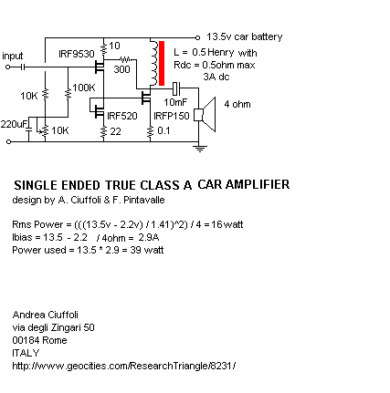

So I guess I'm asking for opinions and suggestions on using an array of batteries to create the rails for a class A amp. It seems that the Aleph X uses +- 15V rails. As far as I can figure this means you'd need 3 cells @12V each. You then halve it and regulate it down to the needed 15V per rail.
Taking power straight from a battery seems to circumvent a huge amount of the problems found in mobile audio design. Noisy power supplies suck. So I'm just looking for ideas, suggestions, the perfect way to do it. That sort of thing. Thanks in advance.

It would be more sensible to build a decent SMPS. You have to make one to charge 36v worth of batteries anyway. In Car audio theres not much you can do to avoid then. Spend your time looking into making a better SMPS rather than huge battery arrays.
Google for low noise SMPS and you'll probably find something half decent. Whether it need to be linearly regulated is up to you.

I did a few source-follower choke loaded class A's a while back. I thought they might be relevant to what you want because they will swing an output voltage of double the supply voltage.dunderchief said:It seems that the Aleph X uses +- 15V rails. As far as I can figure this means you'd need 3 cells @12V each. You then halve it and regulate it down to the needed 15V per rail.
http://www.diyaudio.com/forums/showthread.php?s=&threadid=12377&highlight=
http://www.diyaudio.com/forums/showthread.php?s=&threadid=6338&highlight=
Hope you find it useful.

If you want low noise SMPS go to the Linear Tech website (www.linear.com) and look to the LT3439, look at application note 70, etc.
LTC has a series of low noise switcher chips which can be used as gate drivers. You can order right off their website if you are buying less than 500 parts.
It has been suggested that you use a sine oscillator at 100kHz as a low noise driver for an SMPS -- you can drive a "rough" BJT amplifier to drive the primary of a transformer. While you could certainly do this it's a little tricky to get it to "start" and much less efficient than the slew controlled SMPS chips. referenced above.
What's the ambient noise level in the vehicle anyway ? -- even in a MB 500S or Bentley any benefit to class-A would seem to be obviated by the ambient noise.
