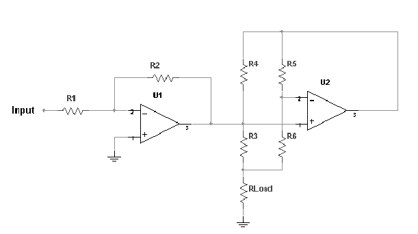

Nice use of a Howland current pump JCX.
Hhm, I don't see a Howland, rather I see the "slave" opamp as a traditional INIC...
The original Sandman circuit looked like this (see attachment)
- Klaus
And on the thread topic, a good amp like the AD797 might only benefit from class A bias under extreme and suboptimal conditions for it's supply and bypassing by making the load induced supply ripple more signal related that it is in class B (half wave rectified portions).
- Klaus
