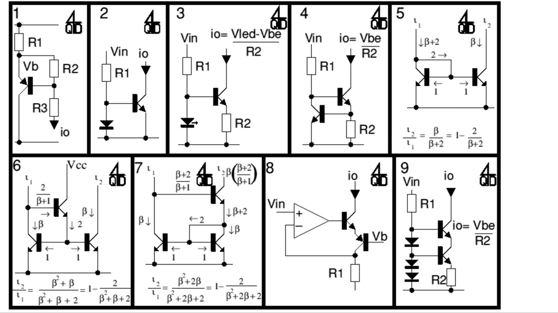

I suggest the LM334 3-terminal TO-92 case current source. Programmable up to 10mA using only one resistor.
Mouser part number: 926-LM334Z/NOPB
Walt Jung measured the audio band A.C. impedance of this device @ 2mA, in his current source article originally published in Audioxpress magazine in 2007. Shown in figures 7A and 7B therein.
https://audioxpress.com/assets/upload/files/Sources_101_P1.pdf
