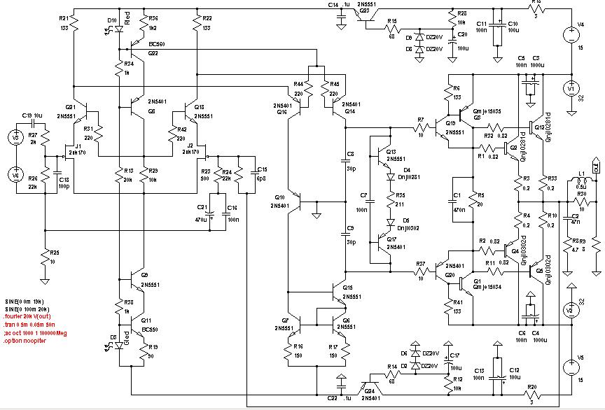

Class A/B folded cascode amp
This is the best sounding amplifier I'v ever constructed!
It don't measure very well but it sound so gooood 😀
Hi Leo,
You must match the following transistors:
J1-J2, BL version, matched at 6mA Ids
Q16-Q14, matched for Vbe
Q19-Q20, it is not really necessary but it's a good thing to do it at the same hfe
Q7-Q6-Q15, matched for hfe
Mihai

I've send you an e-mail with all the necessary details for implementing "symasym roender style"
Regarding symasym, whatever variant may be, it will measure much better than folded cascoded amp presented here but it will sound a little bit "worse"
Keep in mind, however, that this is a subjective opinion.
I suggest you to test each variants and choose what you like more 😀
