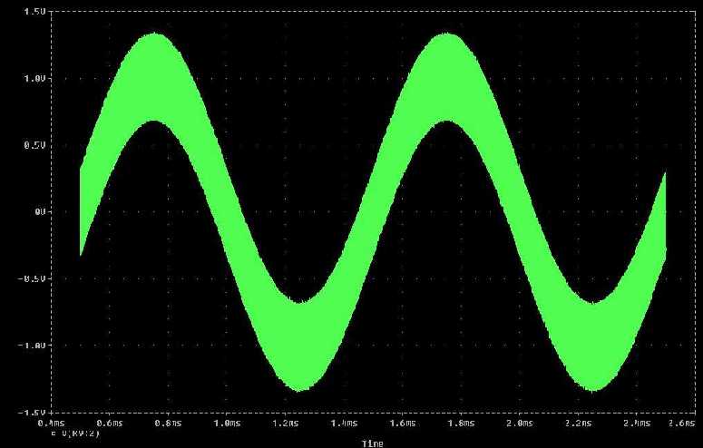

Here is the output signal with a sinusoid 20 dB below clipping. One can clearly see the switching residual sitting on the "payload", as usual for today's switching amps that have less carrier suppression in favour of a better frequency response.
Before someone starts a discussion on this: Bear in mind that this example amp would be capable of 8 Watts approx and that the shown residual would be 6 mW approx.

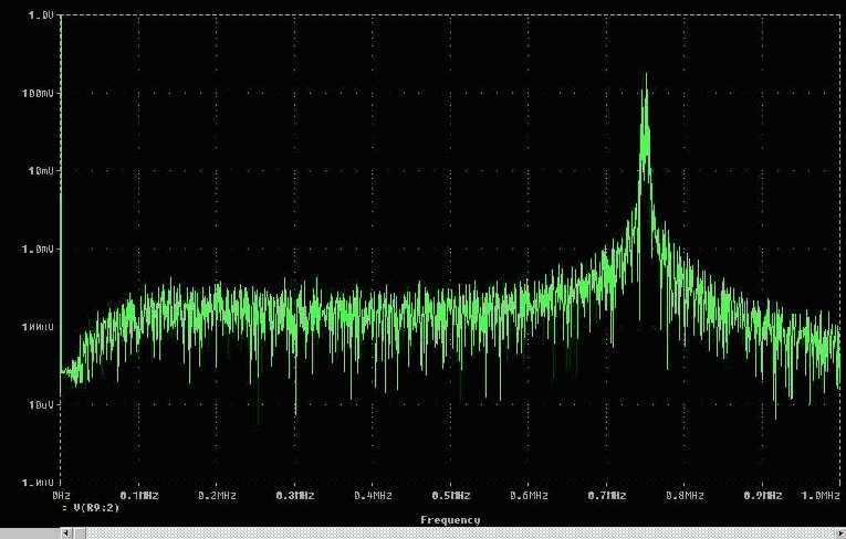

The switching signal is indeed noise-like with a strong peak around 750 kHz (which can be influenced by the circuit dimensioning of course):

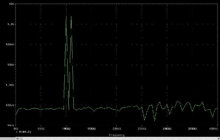

Below is the output spectrum when driven with a 10 kHz and a 11 kHz sinusoid, both 12 dB below clipping (resulting in a peak output signal of half the output voltage capability). Artefacts are well below -80 dB relative to the desired signal.
All in all this principle seems to offer quite astonishing results for a switching amp (even more considered how easily it might be implemented)

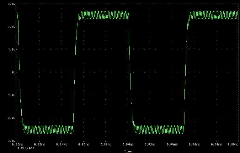

I played around a little more with the circuit and did some runs with rectangular input signals. I didn't use anything to isolate the load from the output and it looked already very good, although for a practical implementation the usual measures would give some peace of mind (not only to avoid unwanted oscillation but also to guarantee the intended one !!!).
There was some overshoot with 2 Ohms, which is in fact 1/3 of the nominal load impedance. From nominal load impedance, up to no load at all, everything looked fine however.
