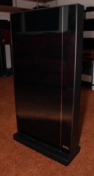

Stereo power amp example from the late '80s, output stages with hundreds of TO92 devices. (height of 4 feet)
