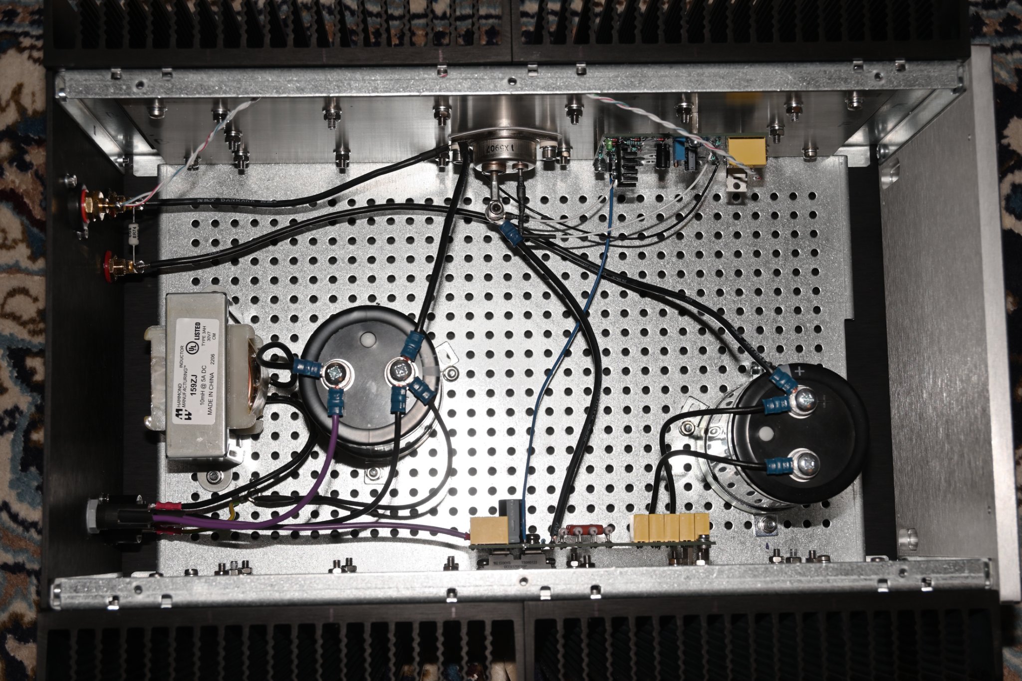

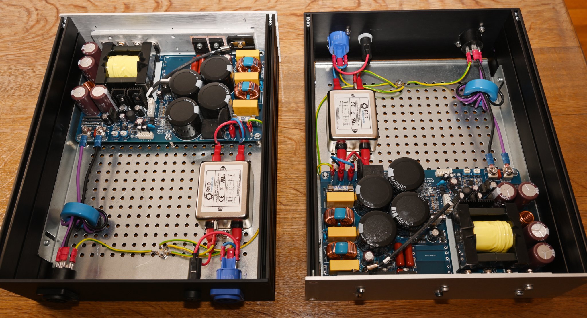

My approach for Lazy Singing Bush which worked very well (very quiet) was to place the SMPS in its own chassis and then place the SMPS box about 0.5m from amp chassis. DC output wires from SMPS board goes via a few windings on a ferrite ring to reduce HF noise (according to Connex data sheet). Also the filtered mains connection was according to Connex data sheet. It is good to ensure you don't get HF-noise back into the mains which could pollute rest of the system. Then in amp chassis a heavy LC filter is placed. L is a serial DC-choke and C a large cap. Then audio gnd is on the cap terminal. There will be no pulsing currents on that cap. It was a "no-go" to have the SMPS inside the amp chassis. For future builds the two-chassis solution is the only way for me 🙂
