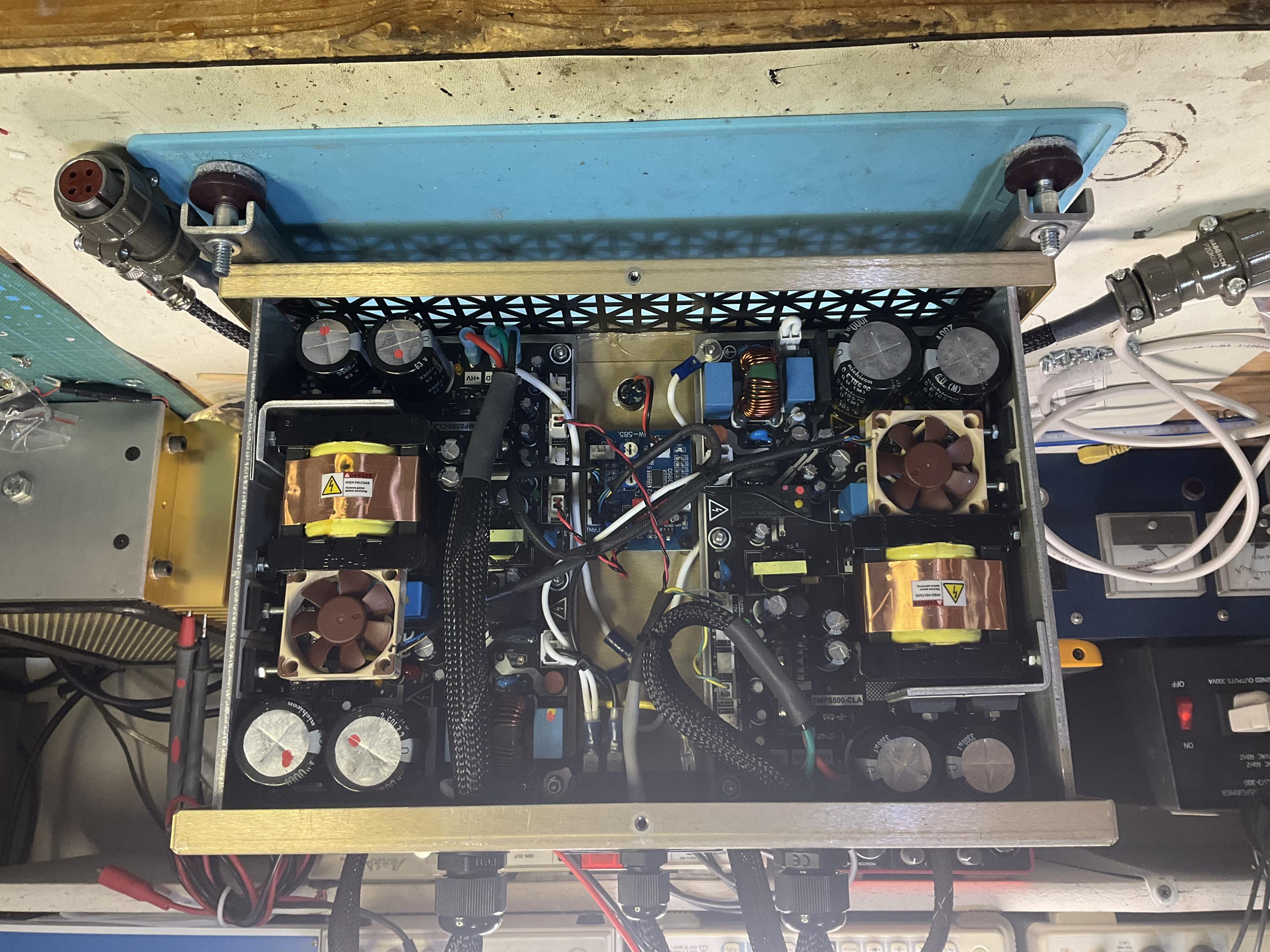

To add to what VonAh said: The SMPS designed by MicroAudio (Cresnet) are specifically made for audio and utilize a different topology so that they don’t mind having a big cap bank at their output, and he makes special ones designed for continuous high current Class A loads. I find that they work very well and are low noise. On some other brands of SMPS, one has to make special slow start circuits to prevent start up in rush hiccup mode.
@WW: I see you have some Noctua’s strategically placed above the transformer. Are they powered from the SMPS 12v? And is is thermally controlled?
At those prices I do not think they are DIY friendly 🙂
They are pricey and the day I bought mine Sammy was kinda down saying the same thing. To his surprise I bought 2 of them with additional cap banks. I told him not all diy is about saving money, I get an idea of how I want something built and can not purchase them commercially so I have to build it. It still is cheaper than a commercial product. I have fans powered from th 12V isolated plug on the supply through a pcm speed controller, I was wondering if they will introduce and noise into the power supply. Will see probably could get away without them.
Bill

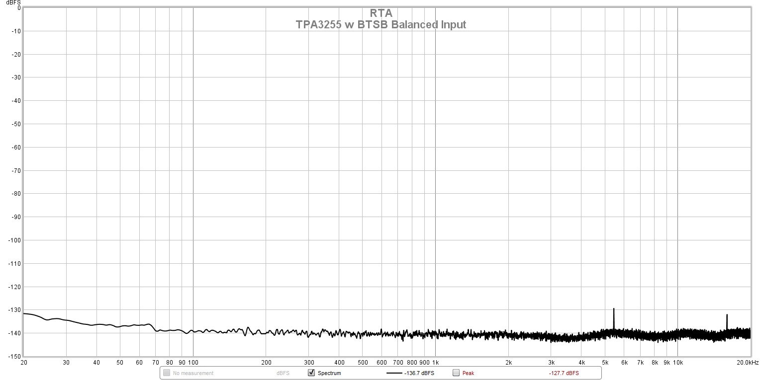

Sami’s PSU’s are very competitive for OEM (when you get 100). For DIY, they are similar to another popular brand but IMO (based on measurement and listening) quieter and offer more audio specific features. Like no hiccup and auxiliary power for accessories like MCU’s and linear regulated power for preamps. You have to ask yourself how important is having a flat as a board noise background important to you? No mains peaks.
Here is the FFT of the noise floor of my class D amp using one of Sami’s PSU’s:
920897d1612993846-xrk-rtr-tpa3255-reference-class-amp-gb2-btsb-bal-input-noise-floor-jpg
