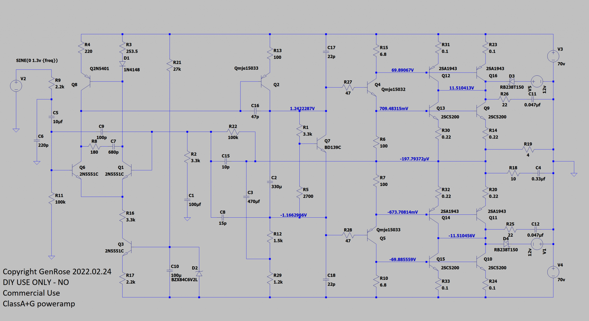

So Class A to accommodate that dreaded cross over region and speaker control/damping but also have the prodigious output power of class AB?
This is my take... (see diagram)
Ideally as it becomes more developed one could lower that secondary voltage even more to within perhaps a volt or two above signal level..
In the very long run class A with variable proportional switching supply tracking is the ideal i think (something for another thread all together)
I welcome all with any contribution, ideas, criticism etc..

key points of the design..
1. Real Class A, no "tricks"
2. Lowest heat dissipation possible. hence the secondary low voltage (12v) but at high current - i chose 12v as a good compromise between dissipation and rms output but the circut works all the way down to 6v
as is...the amp produces 20v p-pk (7v rms...6 watts @8 ohms; 12w @4ohms ) before switching to the G glass rail helpers at 70v..
3. Higher output for musical crescendos in this case i think 200w is the ideal for most speakers/locations hence the 70v rails. The output transistors draw very little current from the 70v until the aforementioned level (20v p-pk) is reached

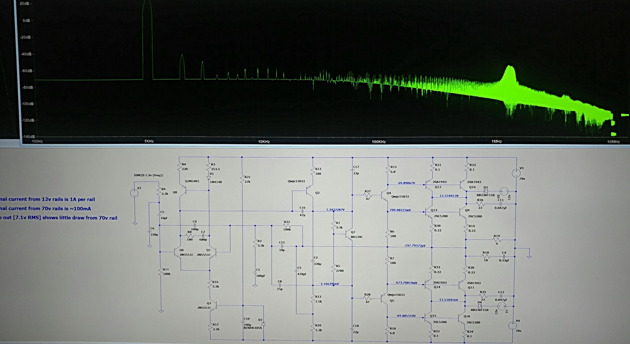

The fft profiles is attached

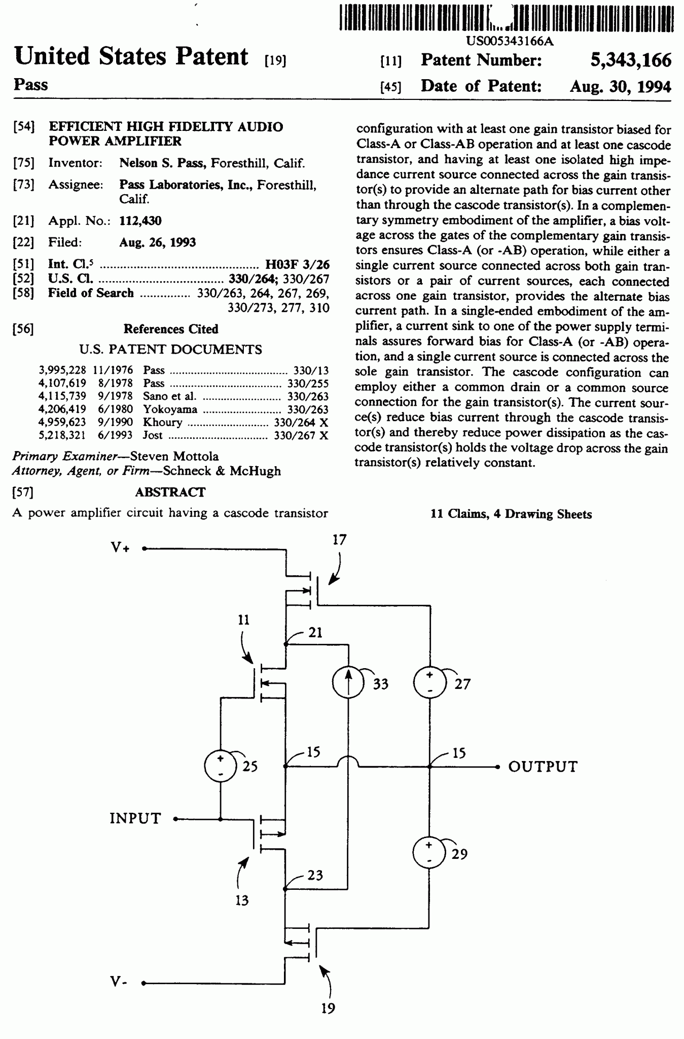

The great Nelson Pass....🤭 im honored sir...🤩wow.. thanks for your reply..
BUT... it seems to me it was amplification in the Mh and Ghz regions... or am i missing something?

No commercial product that I know of. The Sano patent is quite ingenious, but perhaps suffered from the complexity of multiple supplies and output stages for each channel. Same story with my patent.
Interestingly Panasonic chose instead to use a design similar to a 1973 prototype I made which today would be referred to as "non-switching".
I think this is a lofty ambition; I've never come close.
The problem seems that commutating the outputs is possible and a few do it but the loss of heat is passed to the cascoding transistors.
Any attempt to achieve 'non-switching' seems to create extra distortions (and instabilities) which overpower the issues you try to eliminate!
Perhaps the best option is a high quiescent AB, set up so the switching occurs when the output passes 1W or so. That works well.......
Sliding bias on diamond buffers is good and quite stable. But when you look at the harmonics created by any power diamond buffer you realise there is a lot of odd order distortion artefacts.
I really can't add anything more on this topic, it's a knurly one......
