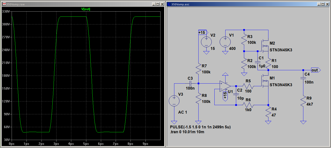

brief explanation: The hi-side power-MOSFET acts as artificial inductor and auto-biases the output to half supply voltage, independent of class A-bias current setup by the low-side power-MOSFET.
The low-side is a voltage driven current source with an admittance of 1/R4=1/47R=21mA/V.
Voltage gain is R9/R4=4k7/47R=100V/V
There is no overall feedback.
The op-amp in this simulation has Ft=10MHz and SLR=10V/us.
Being a class A-amp appropriate heatsinks are mandatory.

bucks bunny said:I just drew a quick and dirty simulation with power-MOSFETs in class-A. Showing 200kHz squarewave output. Could be useful as a starting point
Thank you so much! That looks like a good alternative to get even more out of this amp design.
