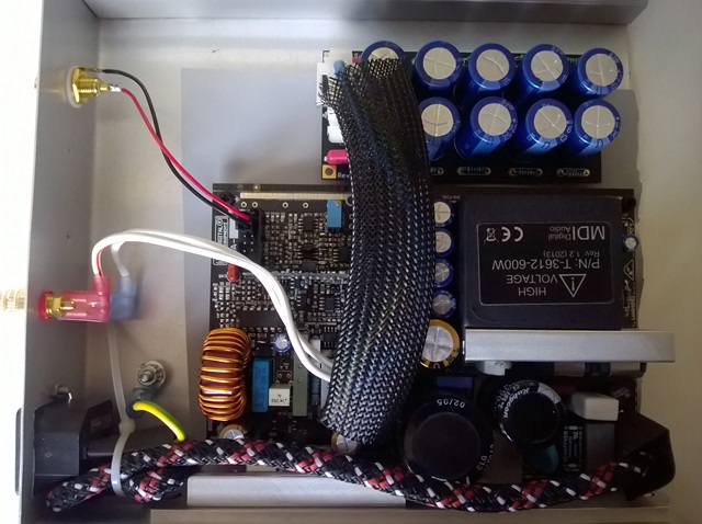

This is what I have done.
I was (and still am) assuming that when U33446z was asking about "separate connection to ground", it was in response to my recommendation of connecting their "cold" ends to chassis ground with a small resistor in parallel with a small capacitor. Hypex recommends 100 ohm and 100 nF.
If you connect mains earth to chassis the inputs should not be left fully floating.
Your assumption is correct
Martin
Big loop area in your input signal pair. Particularly at the RCA connection.
twisted pair would be better, screened twisted pair better still, tiny loop area at the termination the best of all.
The use of the bolt on tag forces the termination into big loop area. Soldering the return to the surround right next to where the hot comes out of the barrel can be much lower loop area, if you ensure the flow and return are closely coupled at the connection.
The speaker pair should also be twisted to minimise loop area.
I have tried twisted pair from input RCA to board, but with no audible difference. What is loop area? Is it the "area" between two parallel cables?
What is "bolt on tag"? Soldering the return..... This whole sentence is a mystery to me. What part of the amplifier are you referring to - can you draw it.
And most important, is it safe?
"bolt on tag" = that metal tag with a hole in the middle and bolted under the nut of the RCA socket.
The Signal Return/cold is soldered to the end of the tag some distance away from the Signal Flow/hot.
It's the gap/area between the flow and return wires that forms an aerial and emits or receives interference.
Twisted pair minimises that gap by keeping the flow and return close together. It also has the advantage of swapping the flow and return in each half turn of the twist.
Interference on one half turn is cancelled by the opposite phase interference on the next half turn.
It's the combination of low loop area and phase cancellation that makes twisted pair a very good connection.
The ultimate is screened twisted star quad used for ultra low signals that need maximum attenuation of interference.
I use hand made unscreened star quad for longer interconnects. The slight disadvantage of star quad is a doubling of capacitance compared to twisted pair.
ok - now I understand. I did try that first both on signal and speaker out. But there is no audible difference, between the short parallel cables, and twisted pairs, so I thought why bother and just made it with parallel cables.
