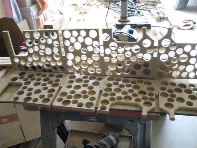

Holly Smokes!
Did some ask about Holes?
From my curved Thor build.
Renron

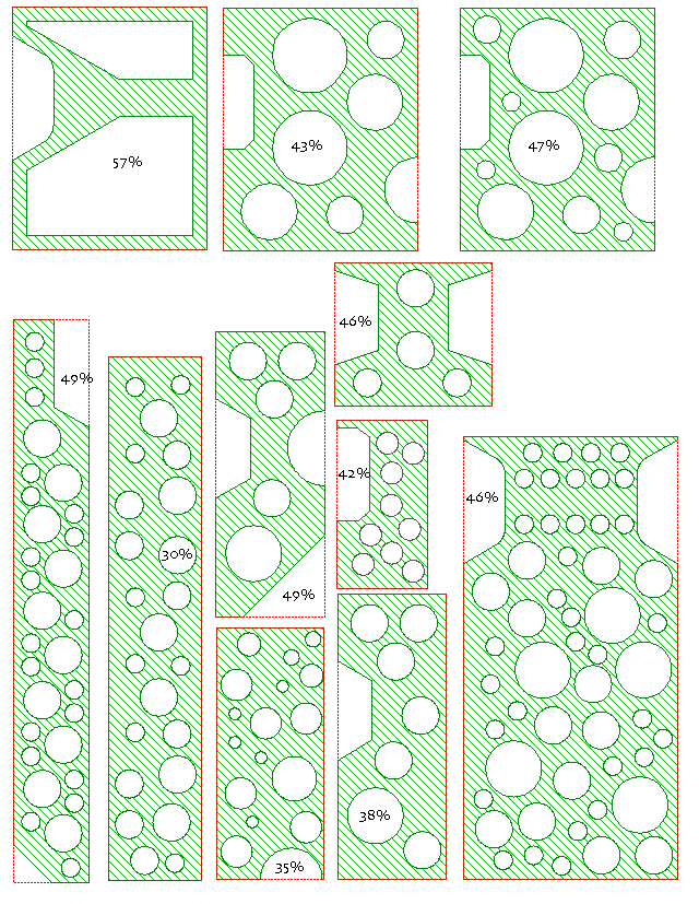

frugal-phile™
Joined 2001
planet10 said:
a WAG is that 30-40% holes is an upper limit.
I just did an informal survey (i took a buch of holey braces as drawn and calculated the percentage that is holes) ... i'd put the practical limit at about 50% now. How much tou can get is dependent on the number of large holes, the size and number of driver cut-outs and other clearances, and whether you take care to preserve direct paths of force
dave
By your diagrams I would say that some of the braces above are on the verge if not crossing. I guess we would have to be careful not to create a weak "path" amongst ajoining points in the interior cabinet. This is probably even more important than the actually percentage.
However, very difficult to assess with just the eye.
Then would there be a minimum holeage for proper air movement.....or in this case the least interference is the best? I guess what I am asking is there a point where removing more material will have no effect?
Thanks for taking the time out,
