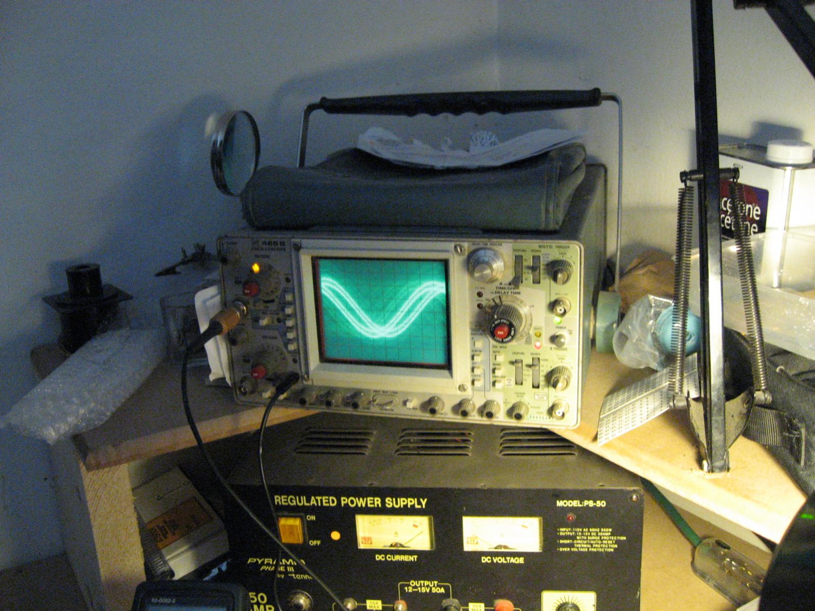

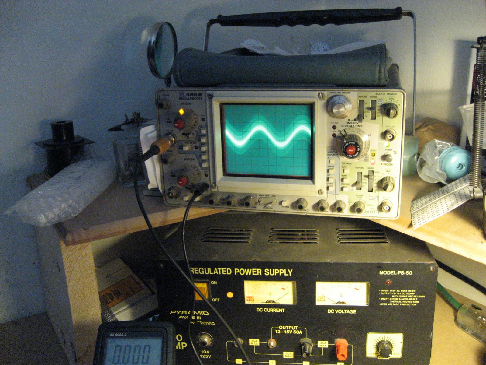

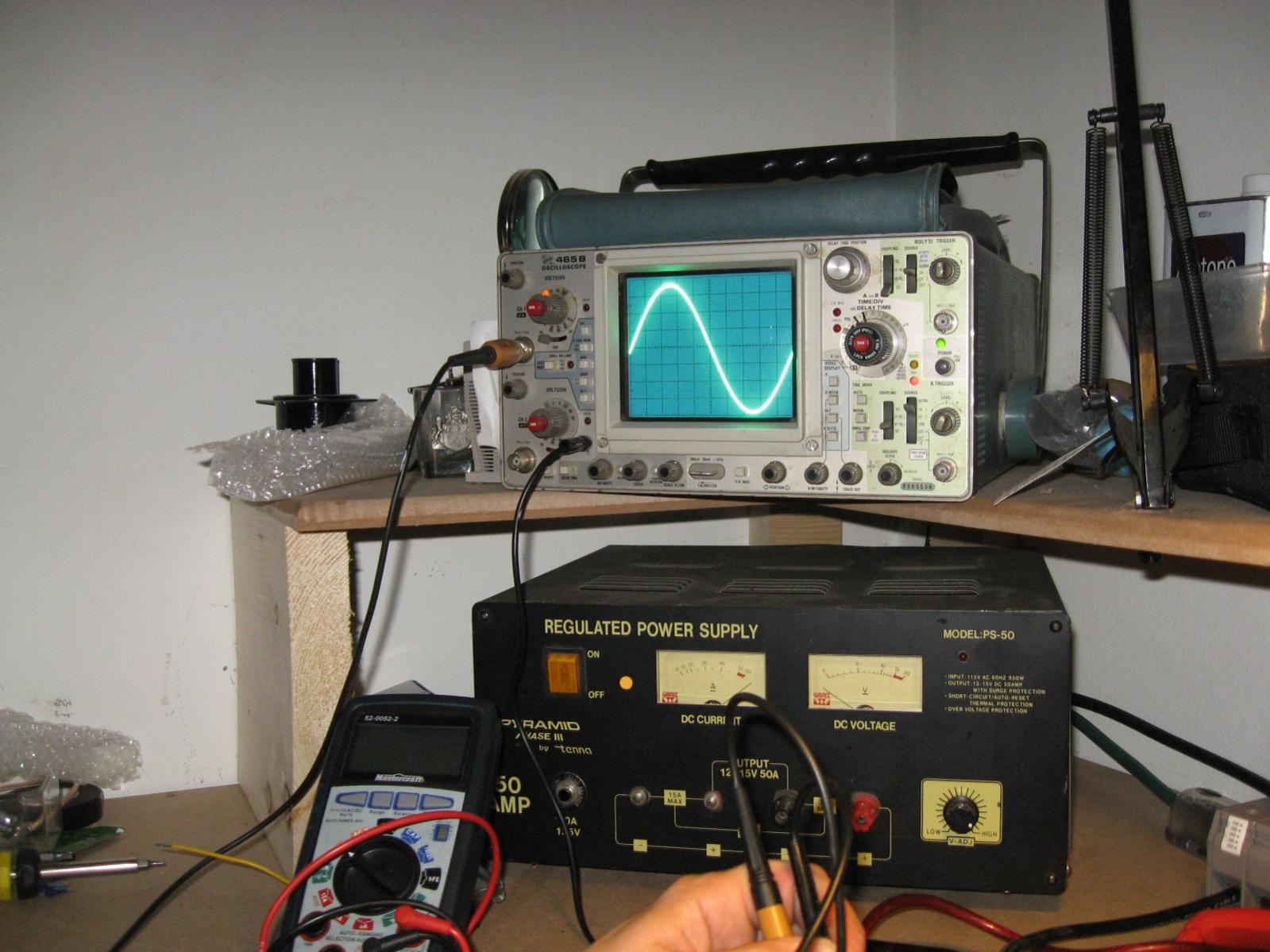

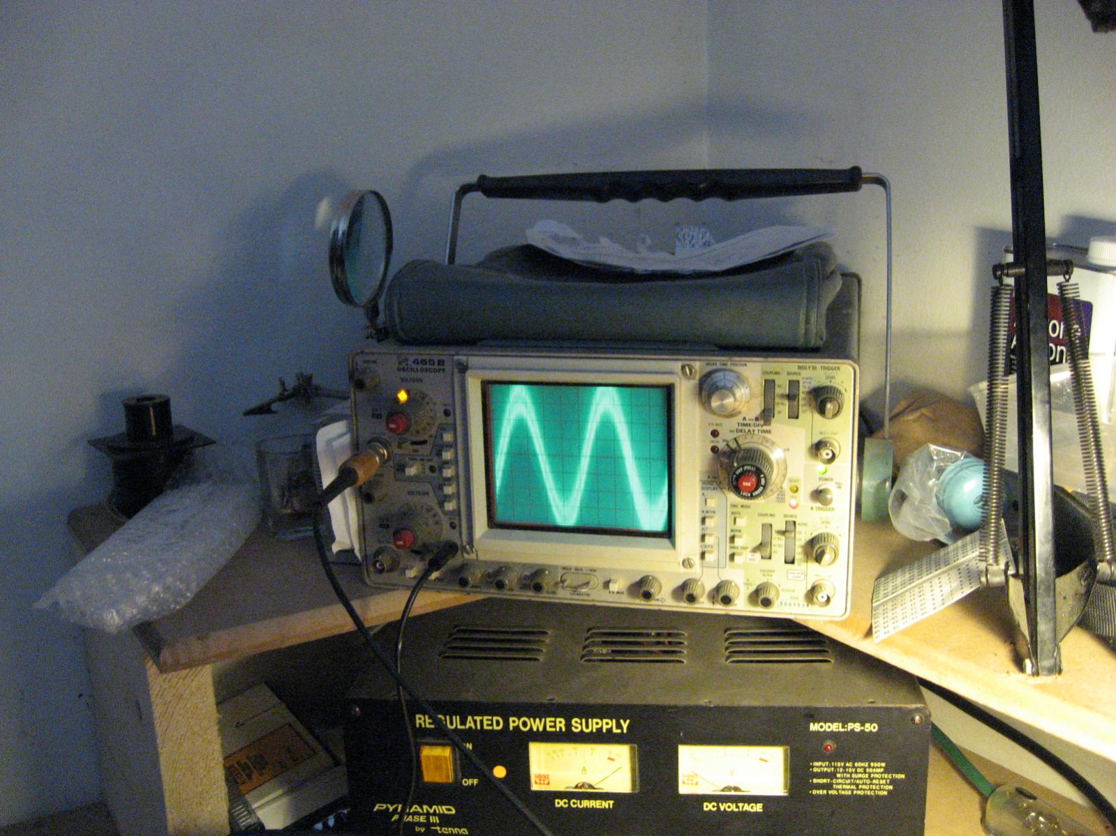

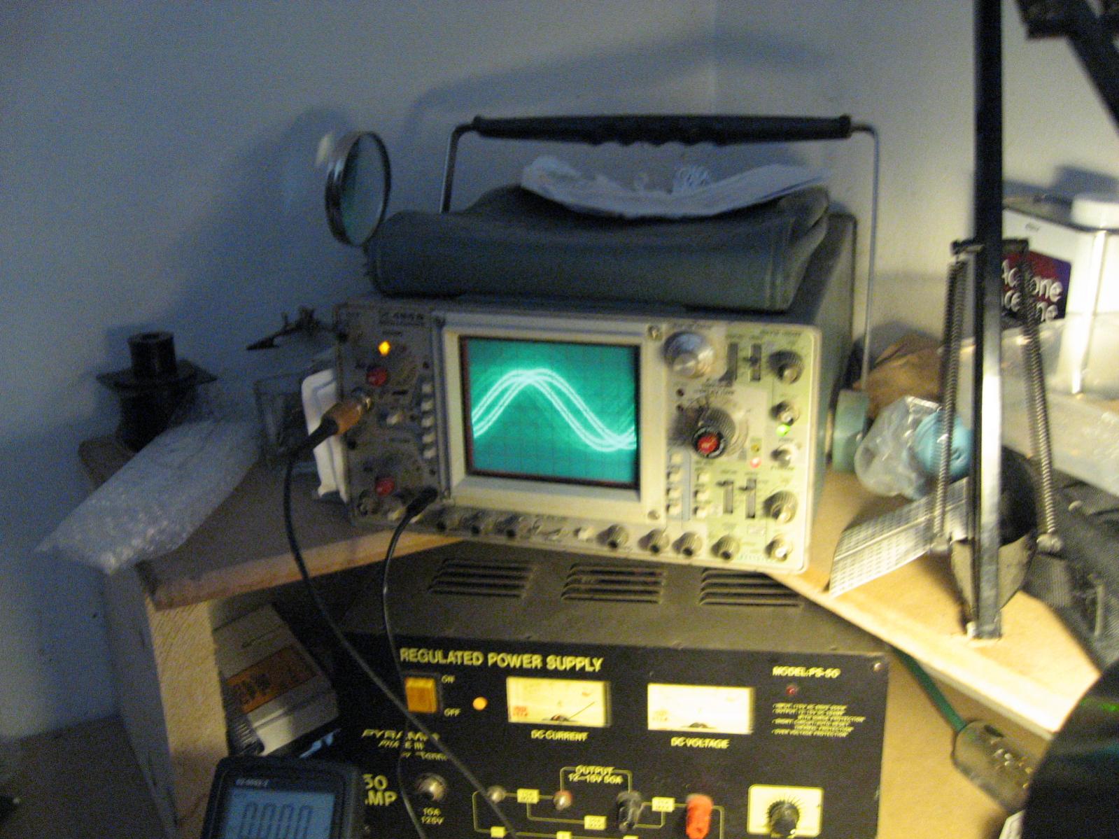

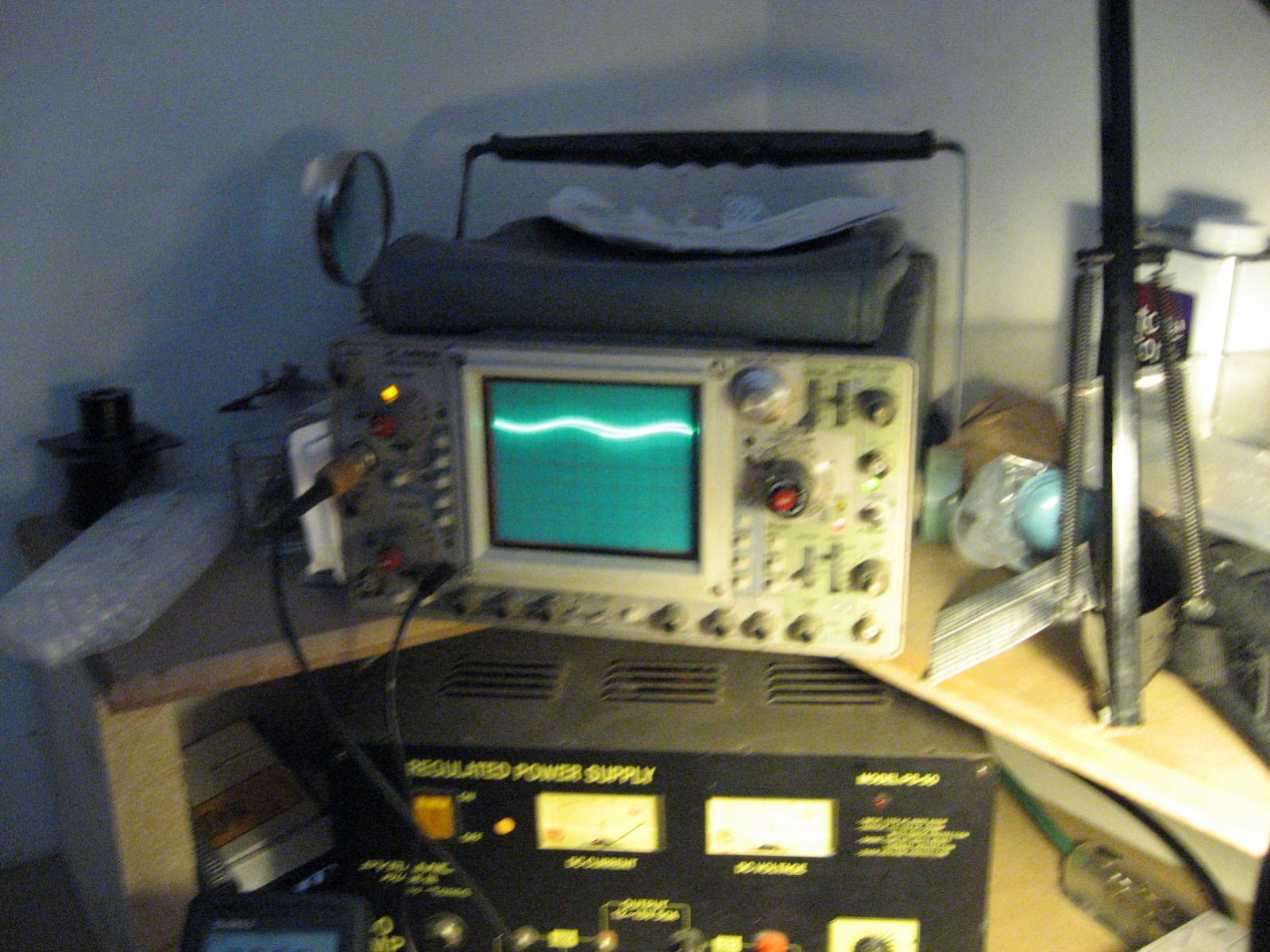

I couldn't really get it to lock in well... maybe wrong settings. We have noted that Q1 and Q32 they are (TIP107 & TIP102) are getting hot very quickly.
The TIP102/7 are being used as regulators so it's normal for them to get hot. Don't let them overheat. If they do and short, they could do extensive damage.
The signal is noisy but that doesn't necessarily mean it's going to sound distorted. Does it sound distorted?
Set the vertical amp to 10v/div and drive the output so that it fills the display vertically.
If you set the trigger to HF reject, it should lock better.
